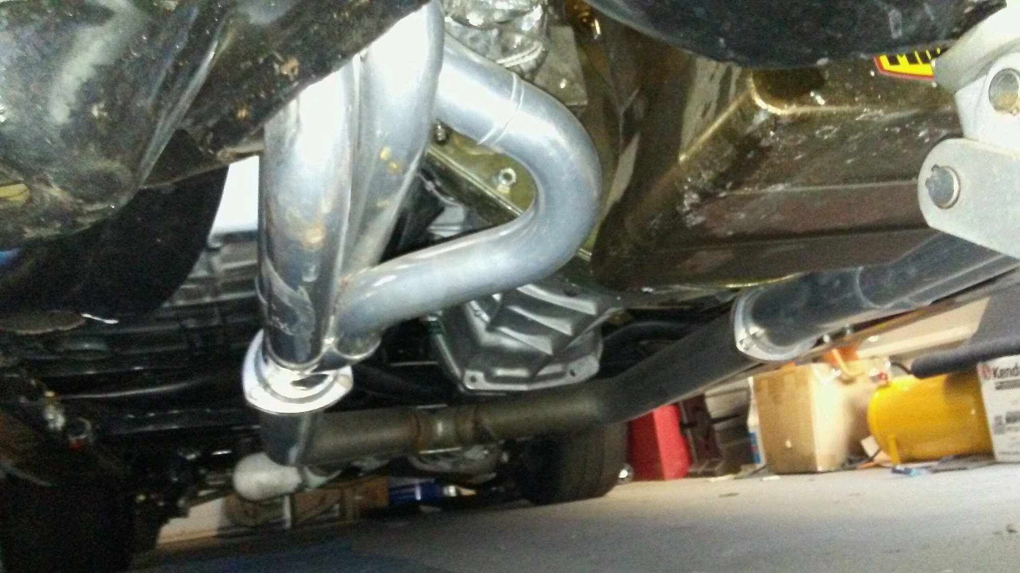

Ditto on Jebby's reply. As for fit and clearance? What could possibly fit better then these? Hooker Super Comps. Not cheap but very well made and the fit with absolutely NO modifications, even with Borgenson PS. And they do not hang below the trans cross member. I picked these up off of a member here for $275 shipped, spent another $120 to have them high temp coated and spent less the the cheapest set on the market.

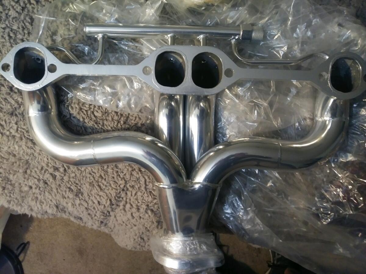

I have a set of custom made 1-3/4 shorty headers with 1 standpipe. Originally for L98 as shown above but the exit location seems identical.
Brand new in the bag coated inside/.out. Even a set of new heapipes with 02 bung 2.5". Dougs type flanges...shameless plug here.
From the looks of C3TPI pic cant help but wonder if the PN for C3 and 4 headers are the same?

Yes and no..the ones I posted will outflow manifolds by a bunch. Maybe not quite as good as a longtube but not a total waste.
OP if you get them coated have them do the insides also. $120 is super cheap!! Last time I checked it was a few hundred at least.

The headers I have are designed for the earlier C3's. They are 1 3/4" primaries. The Hooker listing for these does not include late model C3's but I don't know why. They fit perfectly. They were uncoated when I bought them but brand new. My powder coating guy sand blasted them and then coated them with VHT 2000 degree header paint. He then baked them in the oven like you would powder coat. He said he has had very good success with this method as far as the paint staying intact and not fading. I had him use satin clear as the final coating over the flat black. They look as good as the factory ceramic coating Hooker uses.

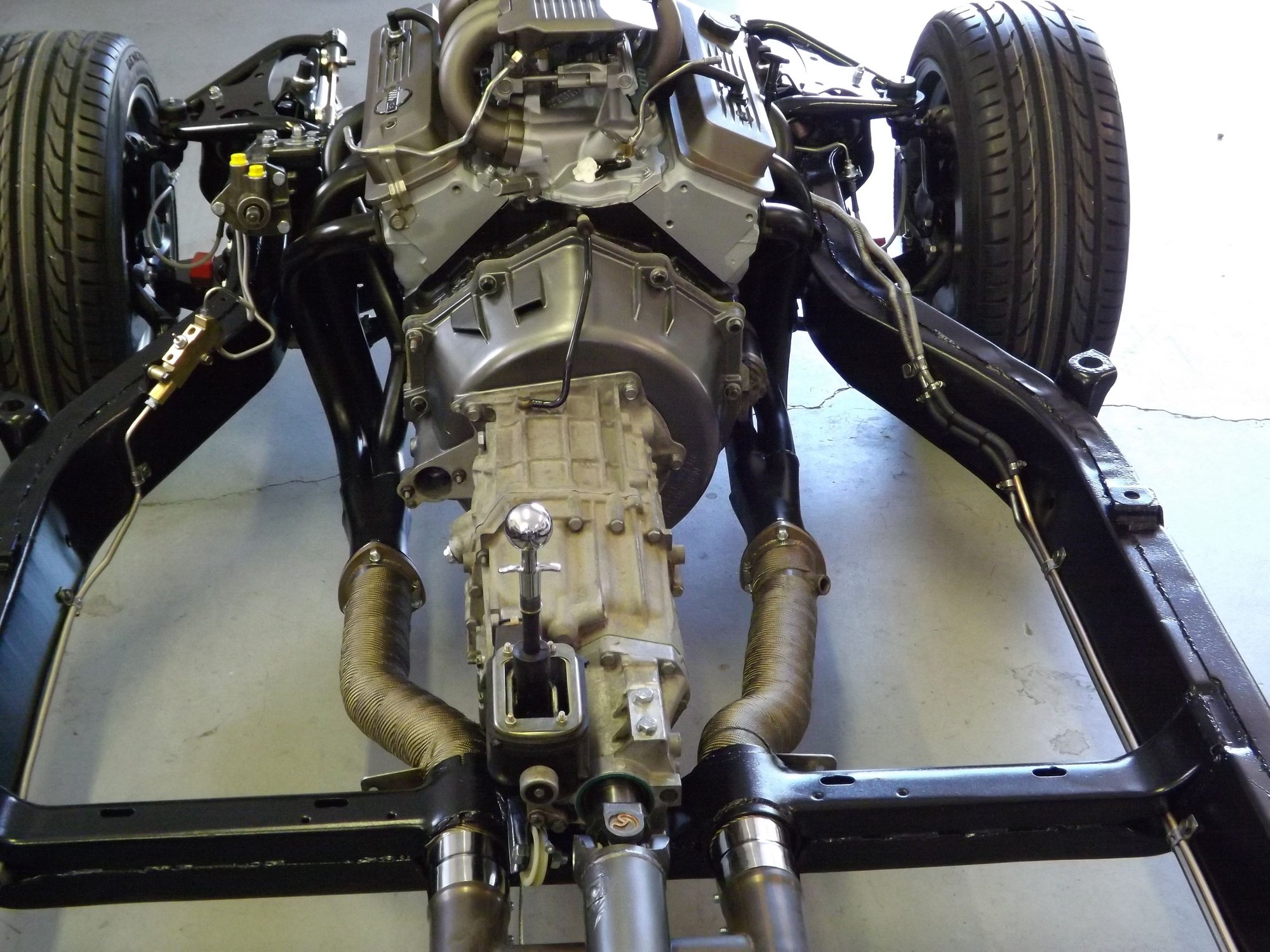

I have a set of Hedman headers on my 68. They were jet coated perhaps 10 years ago, and with only limited driving, they look like crap. The JetHot coating is pealing off and the steel underneath is badly rusted. I have another set of new, in the box header. Can someone refer me to someone's whose ceramic coating was successful? Thankss
I'd really like to have these headers duplicated in stainless...I see this as to the ultimate solution.
I have Hedman side-pipe headers which are used in conjunction with the factory 69 side pipe exhaust system covers and mufflers. Last time I looked, Hedman no longer had them in their catalog, but Summit still had them in inventory. They weren't expensive,...~$180. The header tubes are probably medium length. I've read they are mostly for appearance since the tubes are unequal length. They fit my 68 with a ZZ4 really well. Had to grind out the flange port openings a little to match the D port heads. On the passenger side, a grease zero fitting on the relay rod pivot required slightly dimpling of one tube.
