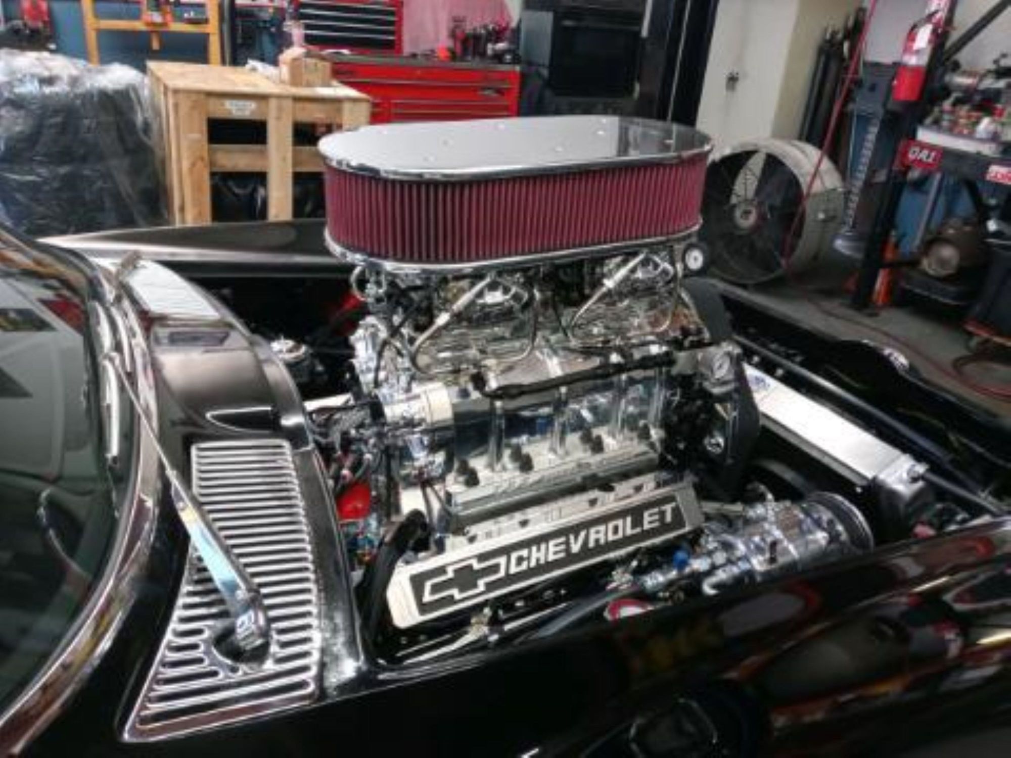

and then there's this kind of power . this is my 66 which I am having a dart little m block with all the good parts to go with it.
