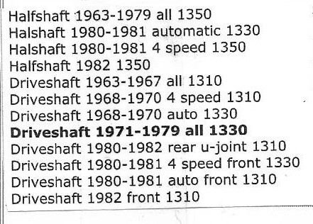

I believe the OP is talking about half shaft u joints. So from the above chart, that would be 1350 type u joints, 4 total.
