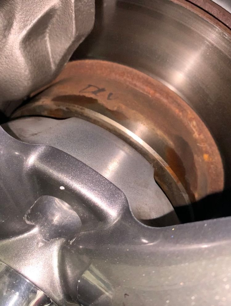

Well after all that it appears one of the new calipers is leaking. Ugh. One step forward, two steps back…
Can you tell if it's coming from the, bleeder, brake line, or the pistons? Only one step backwards,,,, at least your brakes work now.
Old May 8, 2022 | 02:41 PM
  #76
sci85's Avatar
sci85
Joined: May 2021
Posts: 225
Likes: 73
From: Missouri
Yeah it’s definitely not the bleeder. From the pattern it looks like the piston but I’ll need to pull the wheel off and the pads and take a closer look. But yes, brakes are working finally! Many thanks to all of y’all for helping me figure this out.

That "damp spot" on the rotor might just line-up with a bleeder or brake line port.
Back at post 31, you had trouble with ill-fitting bleeders.
Doesn’t appear to be the bleeder. That’s the driver front so the bleeder is on the inner side of the rotor and the bleeder itself was dry. Unfortunately I think it’s seal between the halves or a piston. I’ll remove it this week for a closer look.
