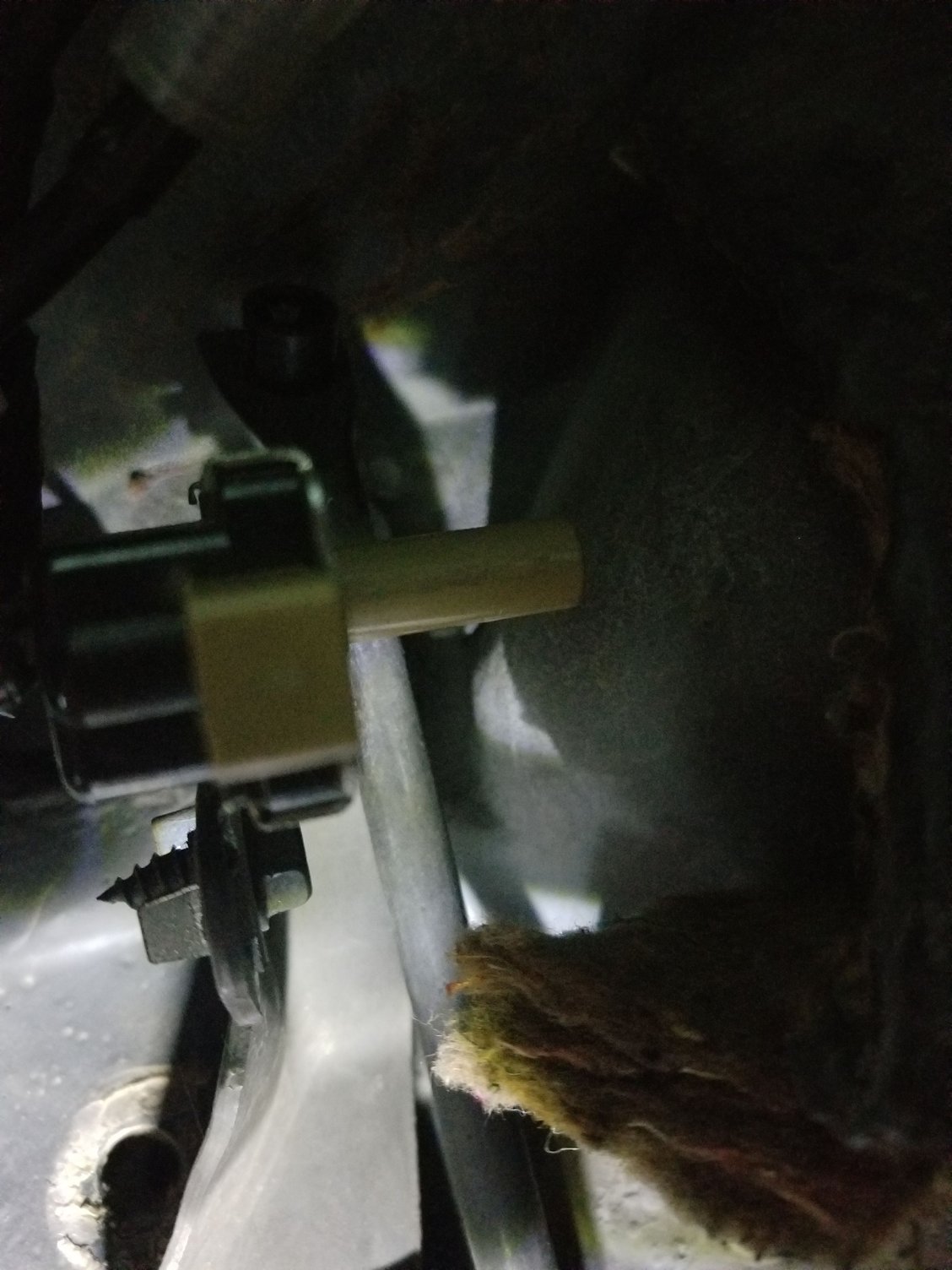

Question, induction worked fine. After removing Qjet for rebuild/restoration it simply stopped working. I see the switch, see pics, and I can push the plastic side stud up. Seems to move freely and spring back down.
What are the best steps to find the issue.
Tks. Doug

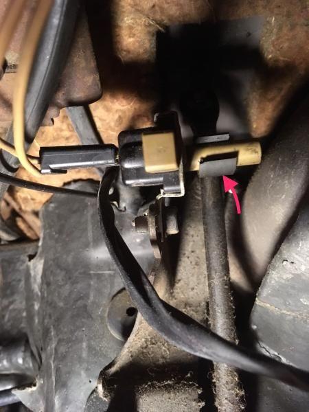

Hi again Doug,
Here is a little tip recommended by some to get your kick down ( as it's called ) switch to activate your Cowl induction Solenoid. I've tried it and it does work. Just cut a small piece if vacuum hose (what I used) and slip it on the switch in the location shown below in the photo. It allows the throttle rod to make contact to the switch sooner. These pics are from my '73. I believe my switch to be original. Your switch doesn't look exactly like mine but it just might be your camera angle, or it might be a newer switch. Better yet, it just might need to be reset!
However, I've also been told there is a way to reset the switch by using the directions in the GM Service manual, and the "trick" isn't needed! If you have one, try that first. I have one, but I won't be able to check it out until late tomorrow.
I'd suggest trying these tips first before purchasing another switch.
Jimmy
Switch with added piece of rubber!
Original '73 Cowl induction Solenoid activation switch. Also serves as the THM400 'kickdown' switch.

Ok I'll try the above things, take a closer look at the switch to pedal.
Funny thing is it did work just fine before, then stopped working. I can push the switch side post
and it snaps up and springs back down, is that how the switch works?
Tks. Doug

wire connected. Per assembly manual to set switch I pushed switch stud up, seated in place. Manual says next WOT will reset switch. I pressed accelerator with my hand and pedal rod did contact switch stud and move switch arm. So, will take a ride later and see it it works.
Tks. Doug
