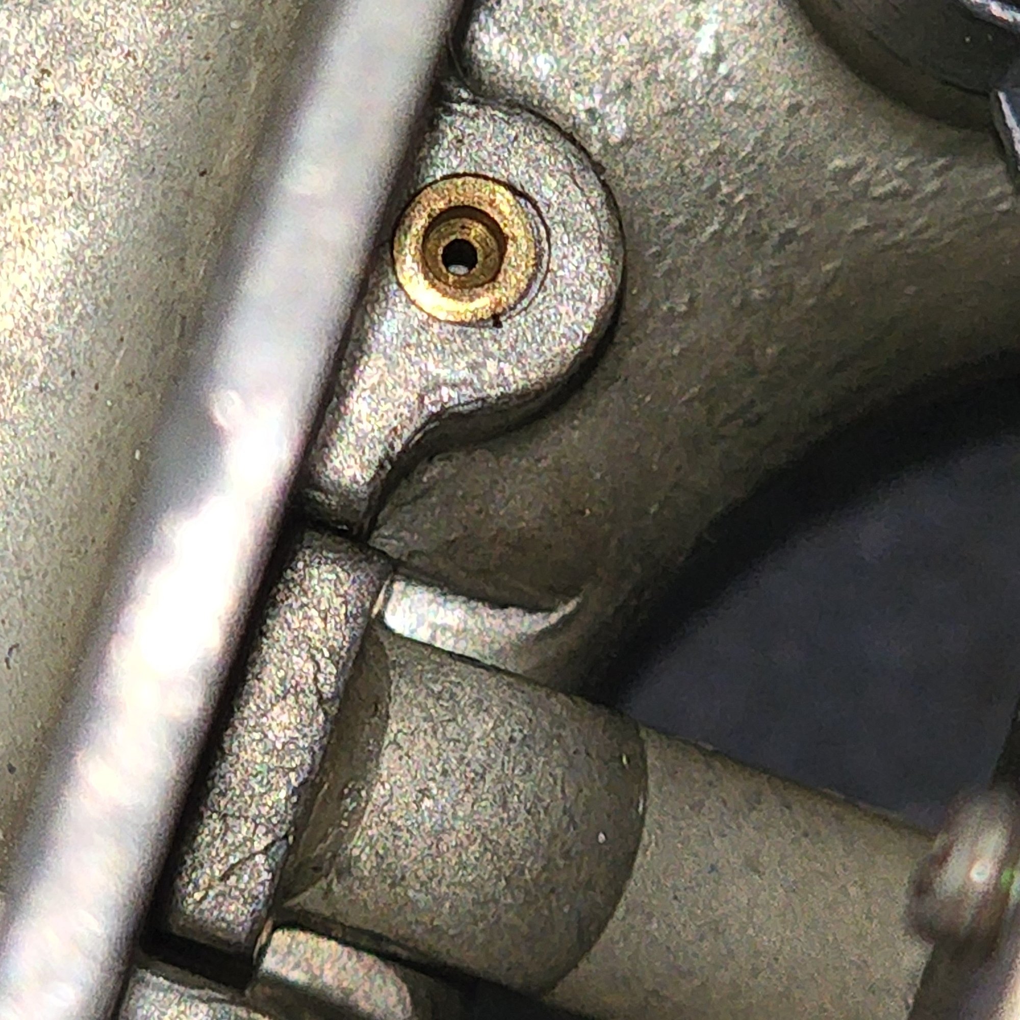

There was a post recently about the plugged hole in the from of the LT-1 Holley. Had a lot of info.Anyone have a link to that?

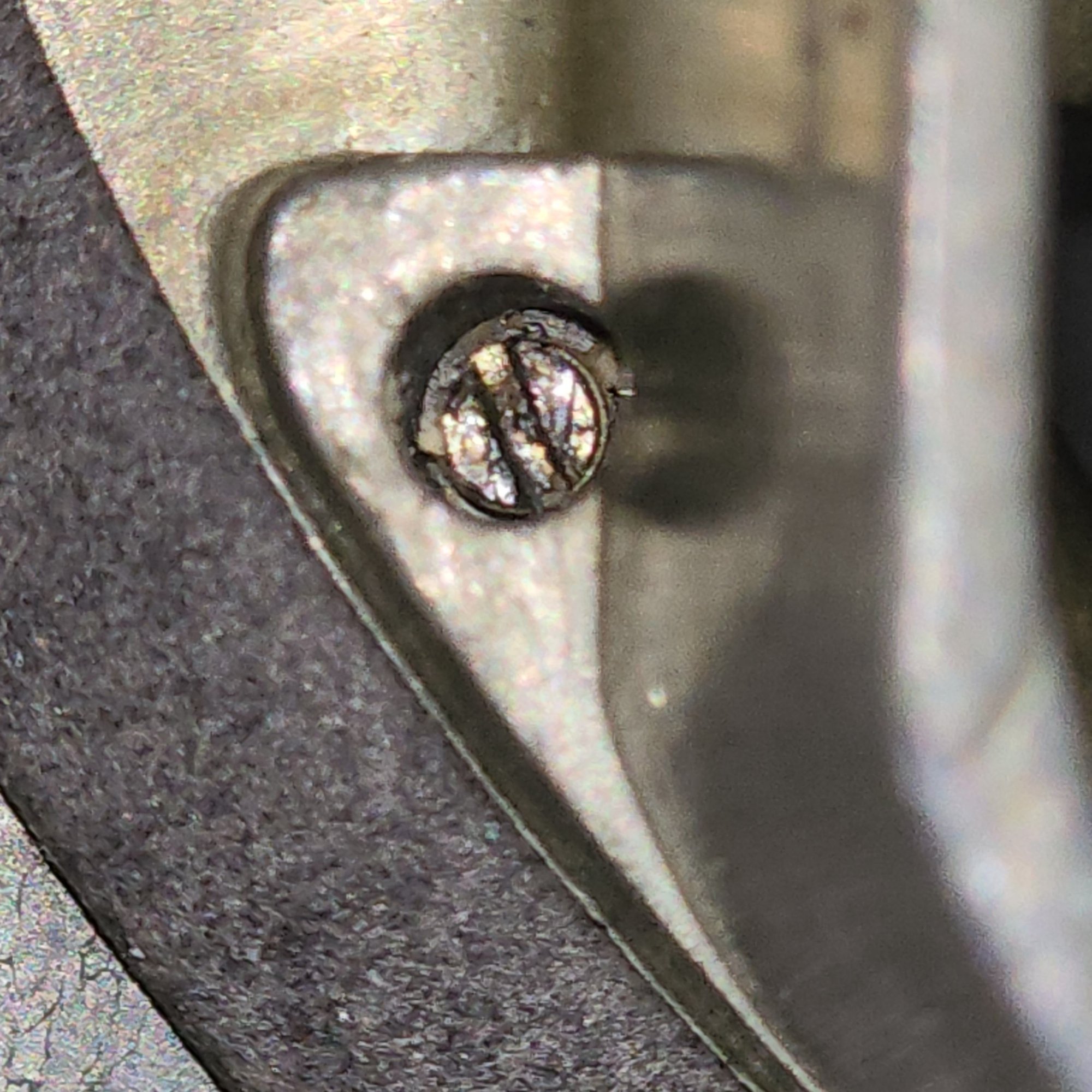

Found what appears to be a threaded plug in the hole of my spare holley.

Yes. Adjustable air bleeds. Only on factory carbs. For emissions tuning.
https://www.corvetteforum.com/forums...-1-vacuum.html
Got a picture of the air bleed just opposite that on the other side of the air horn?
Dated carb?

Hey Leigh. I thought you had posted that thread.
I do have a pic. This isn't a factory carb

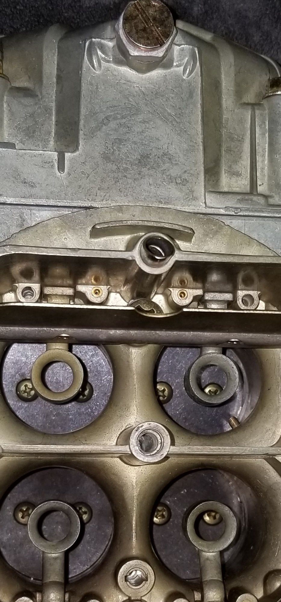

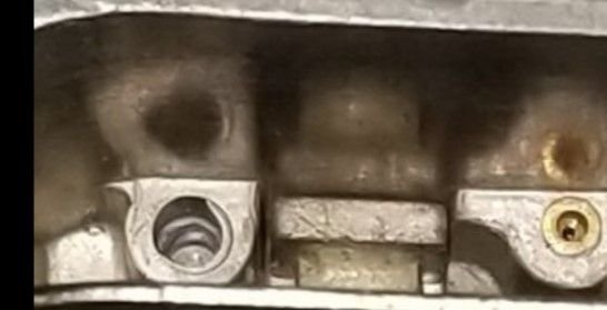

Very interesting!
Do you have a pic of the codes on the choke horn?
This outer air bleed looks like it has been tampered with. That is the one controlled by the screw you found.
Think it's possible somebody tried to "add" these adjustable bleeds?
