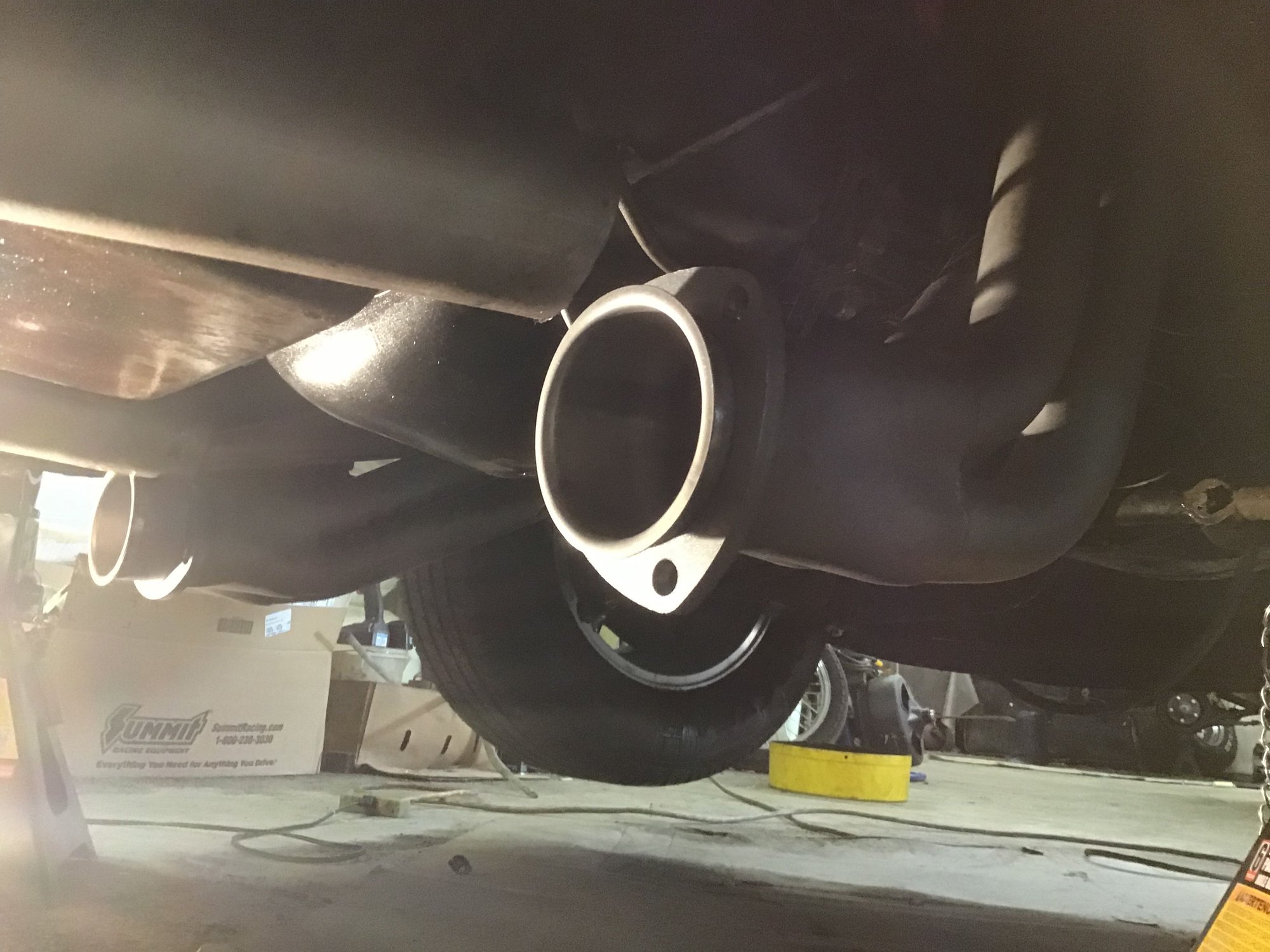

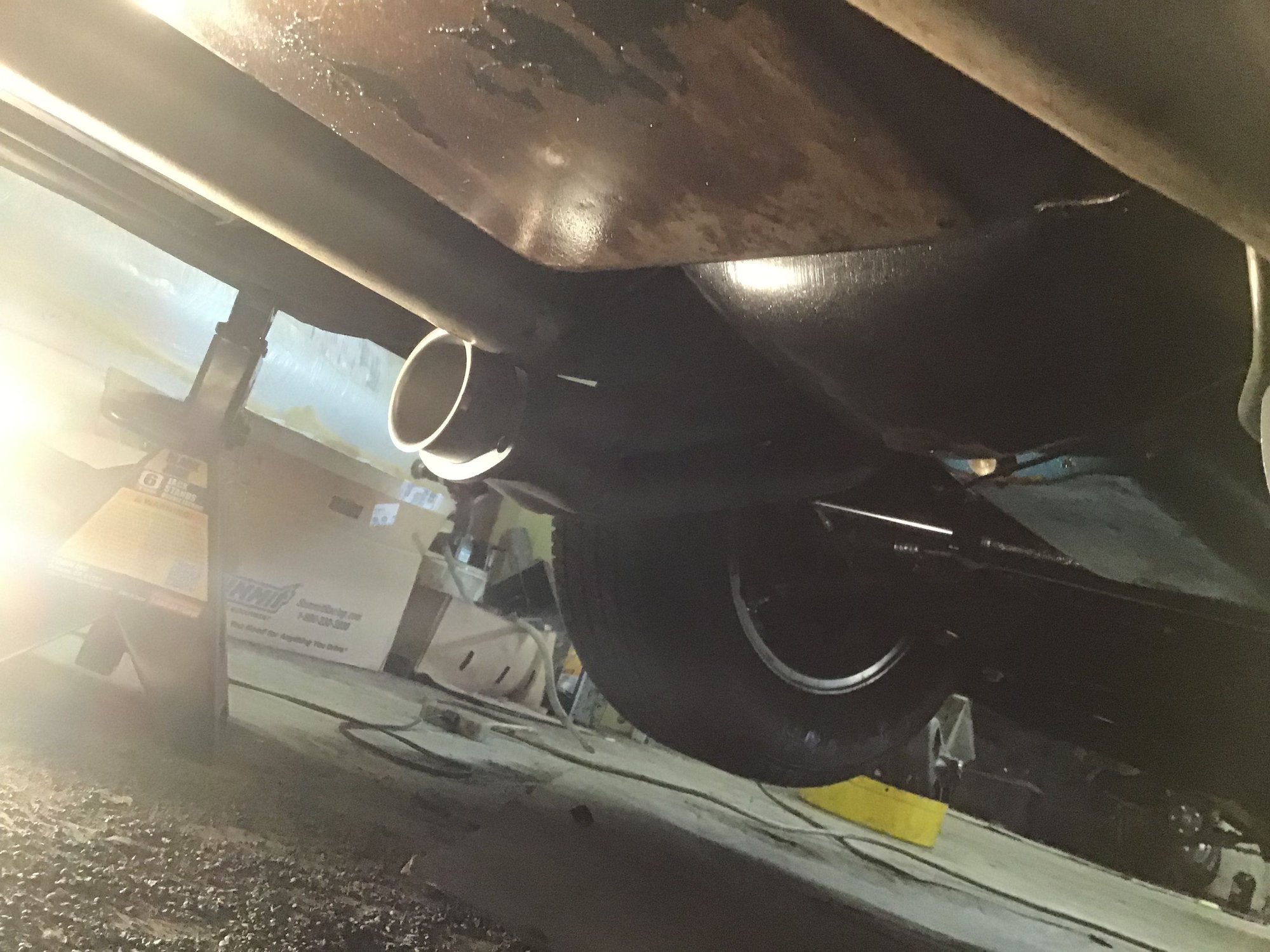

I’m in the same process,trying to get everything wired and hooked up,so,maybe a week or two at the most,before I try to crank it,I have my headers on the engine,and will have to take it to a muffler shop to have them welded,and it’s about a foot off the ground now,but hey are about 2-3 inches below my existing pipe,and actually a inch or so below the pan,what kind of ground clearance do you have,oh,I have a 1981.and I replaced e street heads,Edelbrock intake,AVS2 carburetor,and HEI distributor,and headers. Thanks

They are about 2-3 inches below existing pipes
actually I bought ceramic coated flowtech full length and they match almost identical to my previous true duals that run through the trans crossmember. I am taking mine to a shop next week to go fro 2 1/4 to 2 1/2”

Those headers hang to low.You need Corvette specific

and the headers. we need to remember the corvette engine is lower than all others. our front pulley is just above the rounded crossmember that on all other cars is under the oil pan.

Yea,I was kidding.,I would raise the engine before I would put taller tires on. I haven’t dropped to the floor yet,but I think I might have 3 inches of ground clearance.

I urge you to get the correct headers now......you will have nothing but grief with those.

Thanks Jebby might be my only choice,so,I’m assuming hooker or Hedman headers.

steve. OP. what do you have for ground clearance? and for comparison's sake, fender lip to ground at the center of the tire Golferdad. if you can't find a number on those headers to tell what they are for, sell them to anybody that has a small block in anything else. these cars hit the ground enough already.
