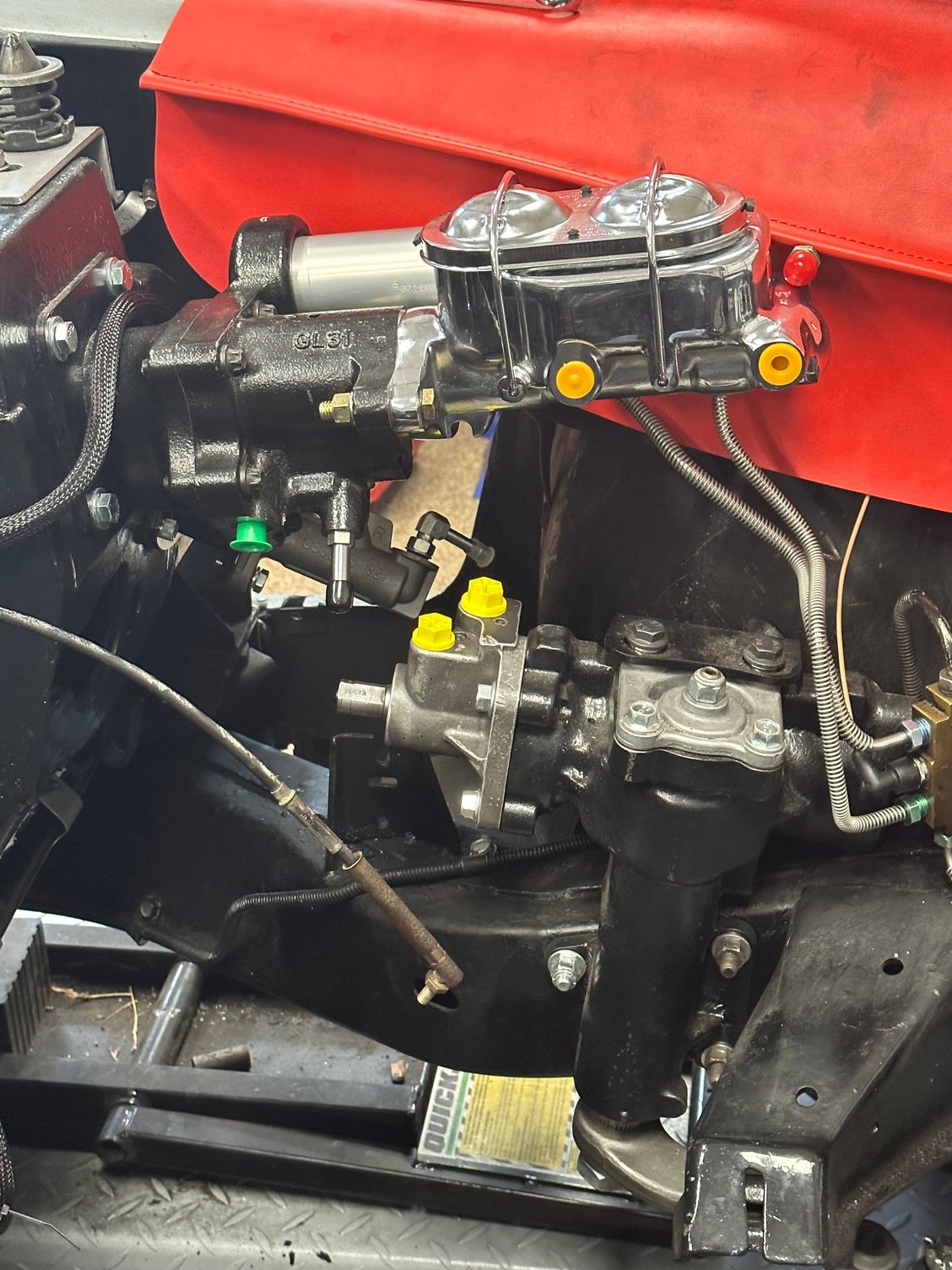

Making good progress although not good at posting and updating. The suspension and brakes are done and the Vansteel coilovers etc went in without drama. Upgraded the brakes to Wilwood and bled them yesterday. the Hydroboost and mc are bolted in and will finish the hoses on the hydroboost once engine is in. Borgenson box is in. Dakota Digital gauges are in and the control box as well as the CDI box are under the passenger dash. the interior is in and will install steering column once engine is in.
All the wiring is completed including Richard454 headlight and wiper cover electrics. Relays are in for the the electric fuel pump ( in tank ) headlights etc. New L88 hood arrived and just on for a test fit ( L88 cold air chamber installed )

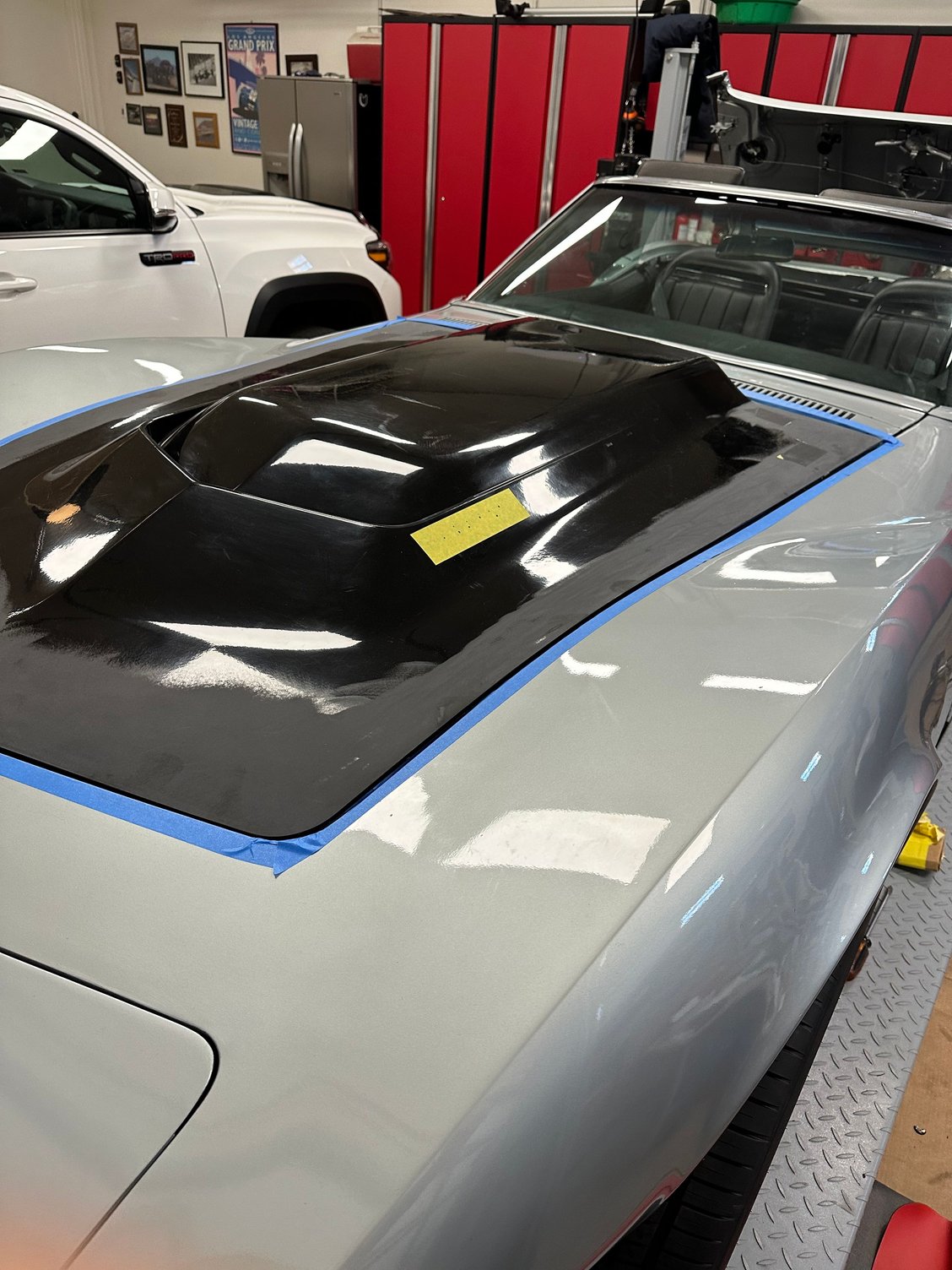

New L88 hood with cold air chamber

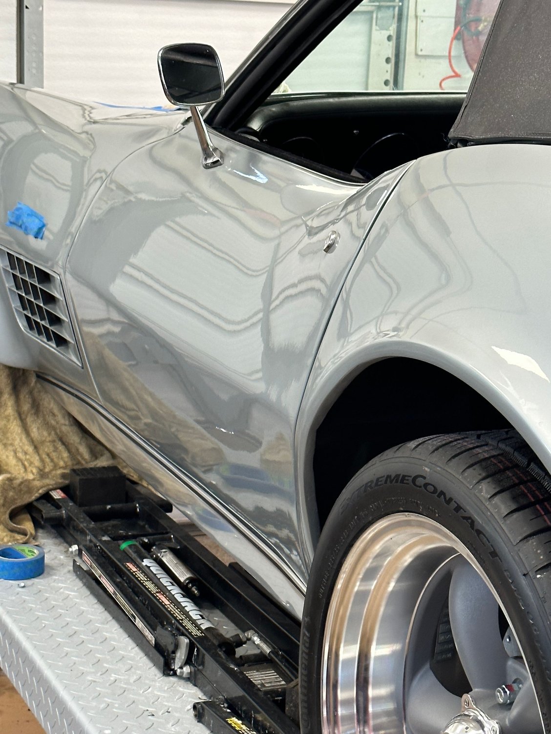

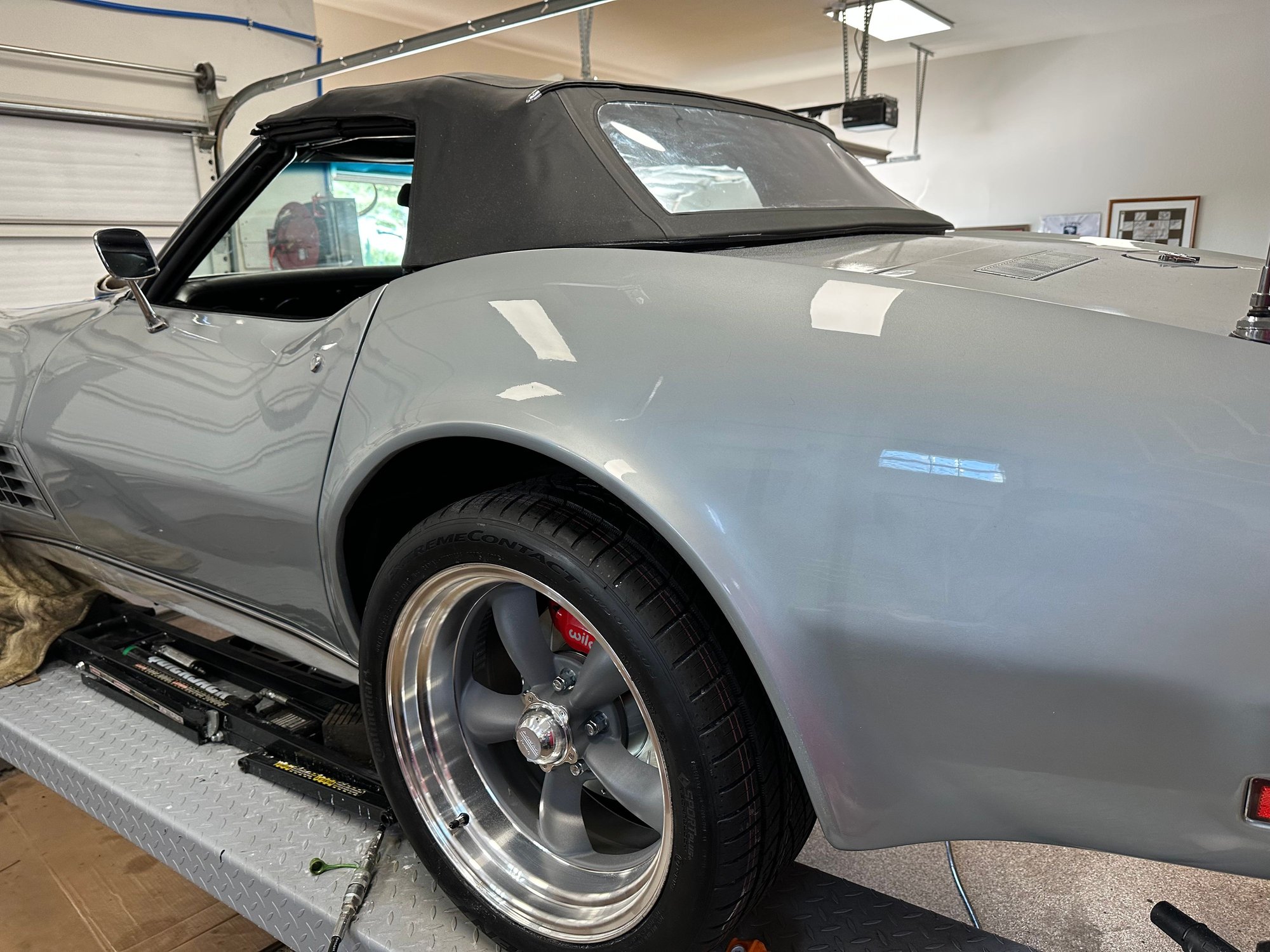

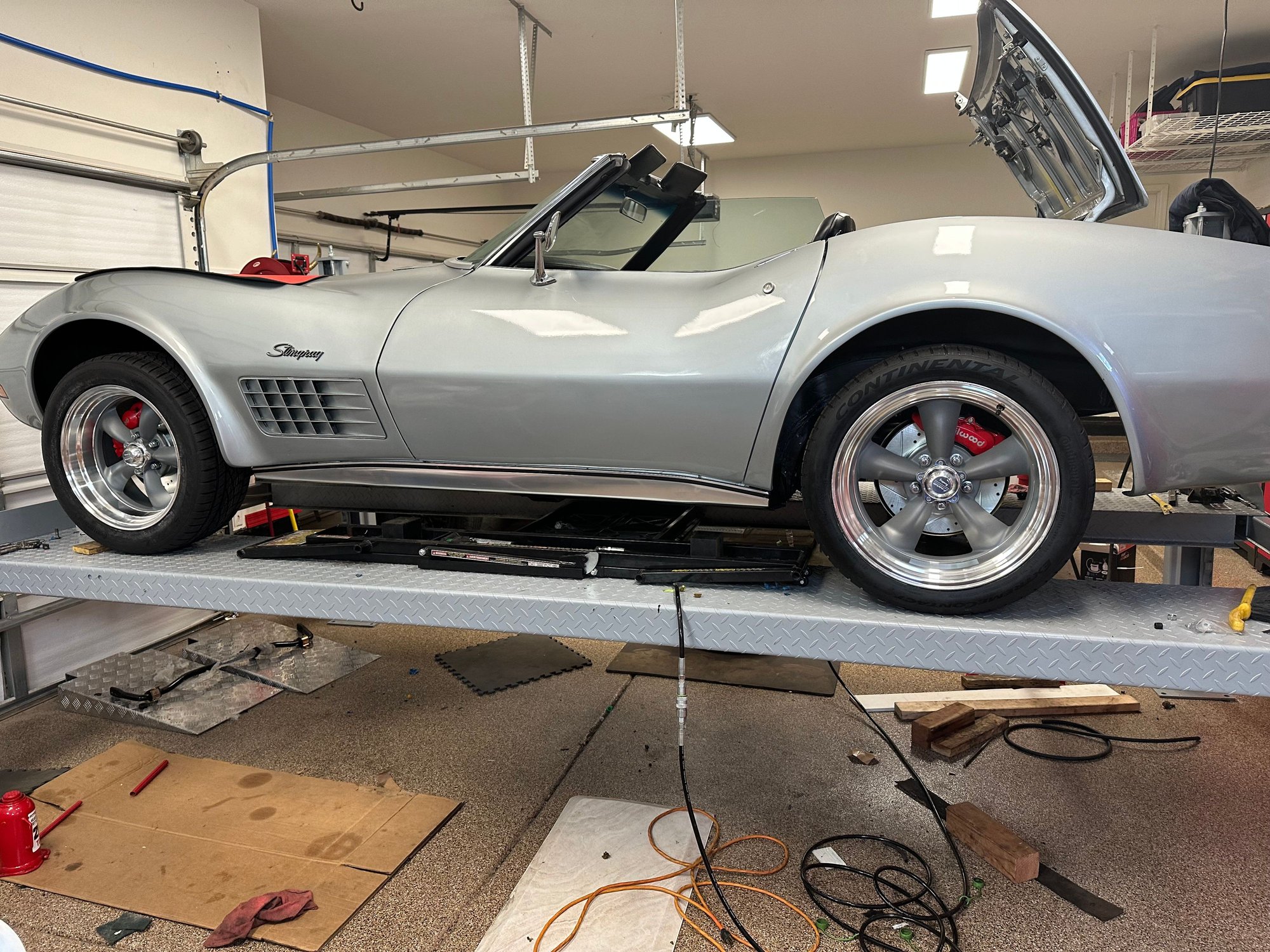

New wheels and tires. Ride height will be adjusted once engine is in

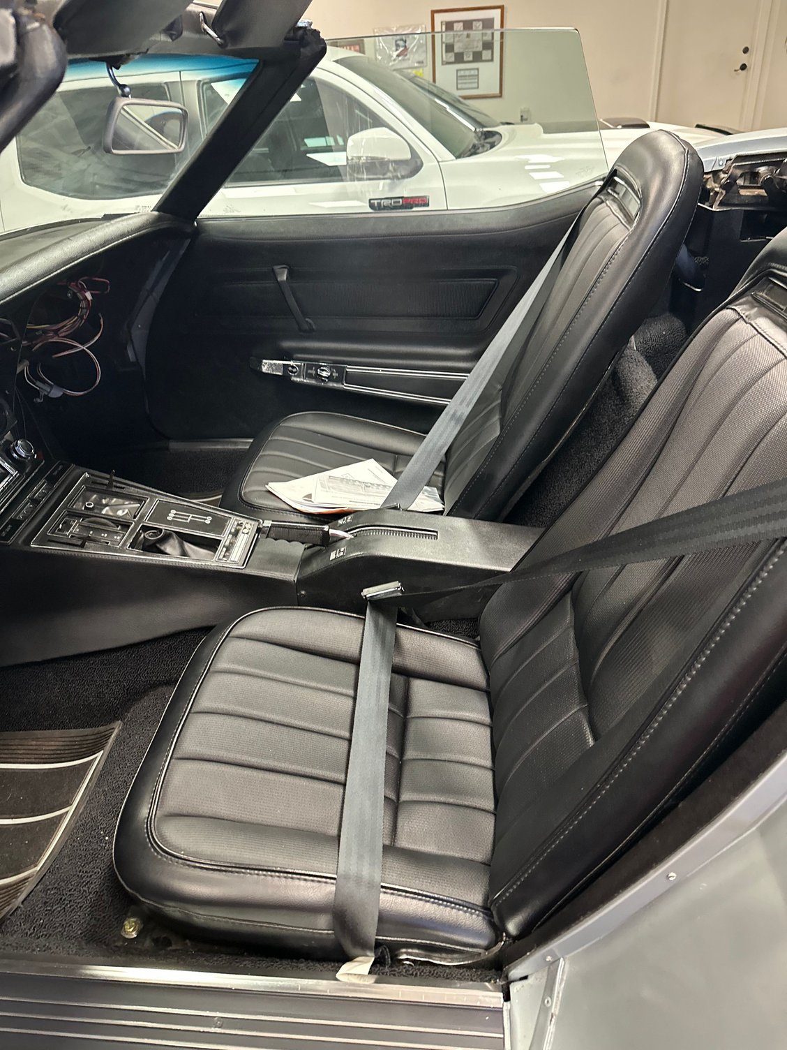

Interior with retractable shoulder belts
Hydroboost

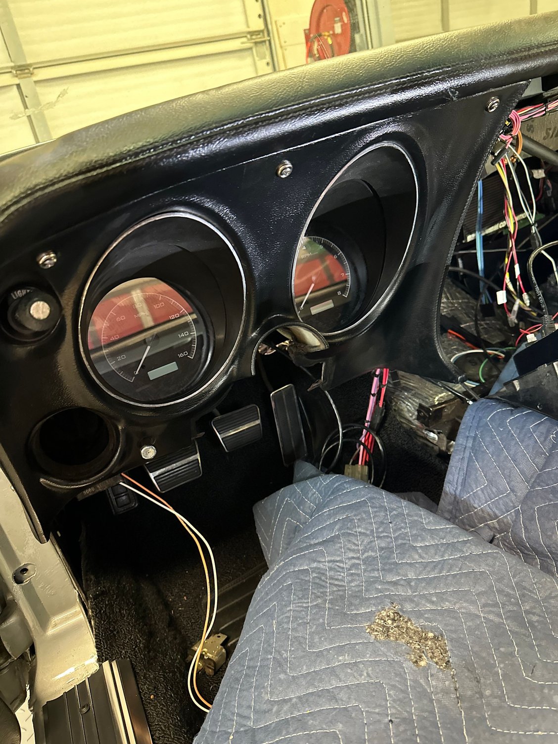

Dakota Digital

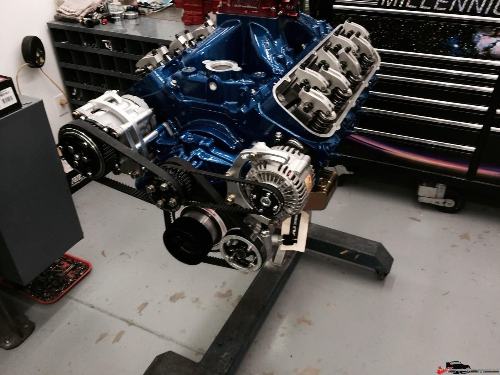

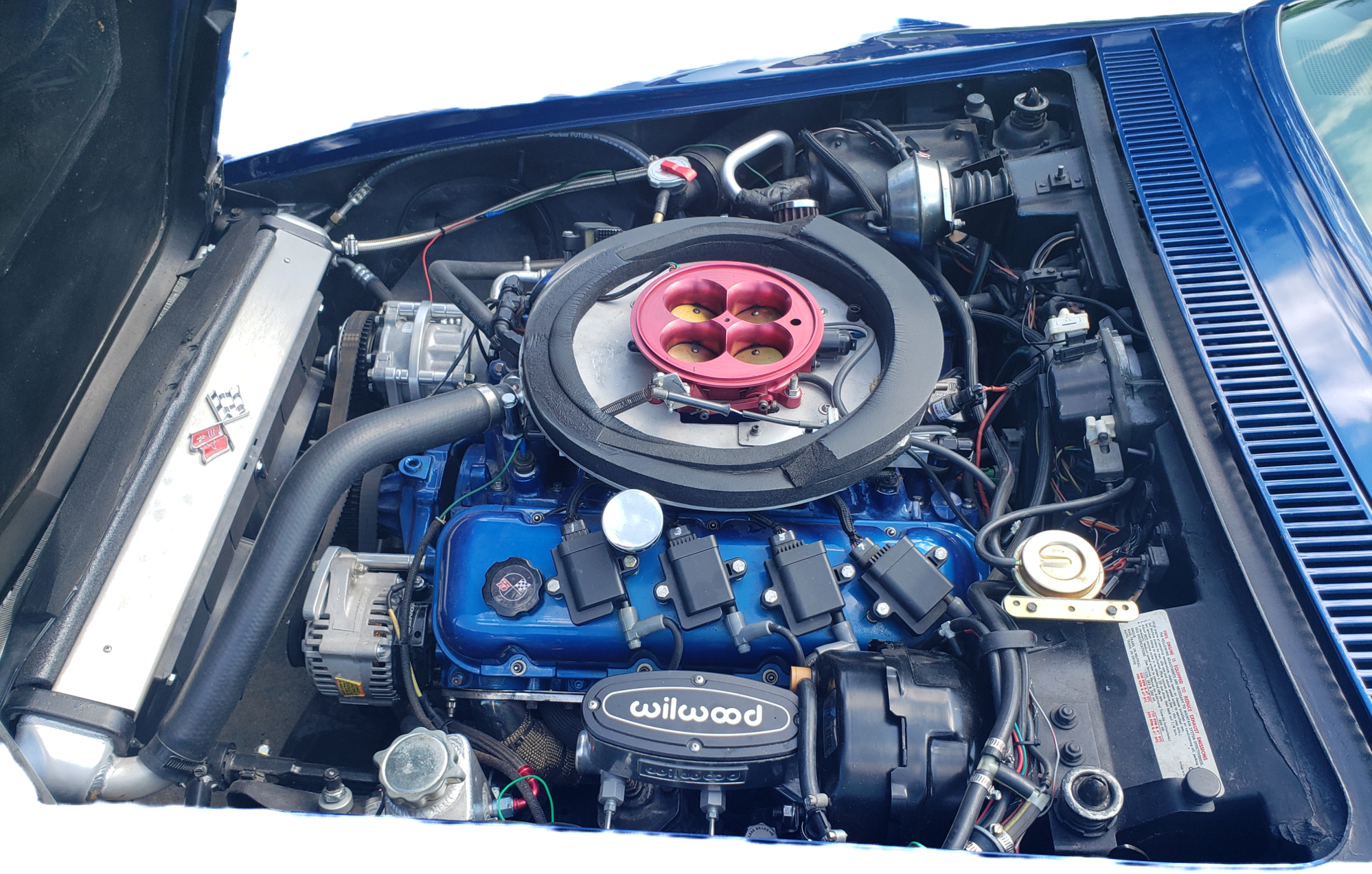

Not to derail any of you guys, Just FYI. Awhile back when I did the Blue Angel 69 resto-mod, I went with the Jones accessory package. Fit like a glove! Very happy with it.

That looks really nice. Did that fit in a corvette big block?

yes, 1969 convertible with stock L88 hood.

Not to derail thread but what kind of lift is that , it looks like a low profile set up .

Default Accessory drive
Nicely done. I’m using an L88 hood with cold air. Mine will look a bit more stock but not by much

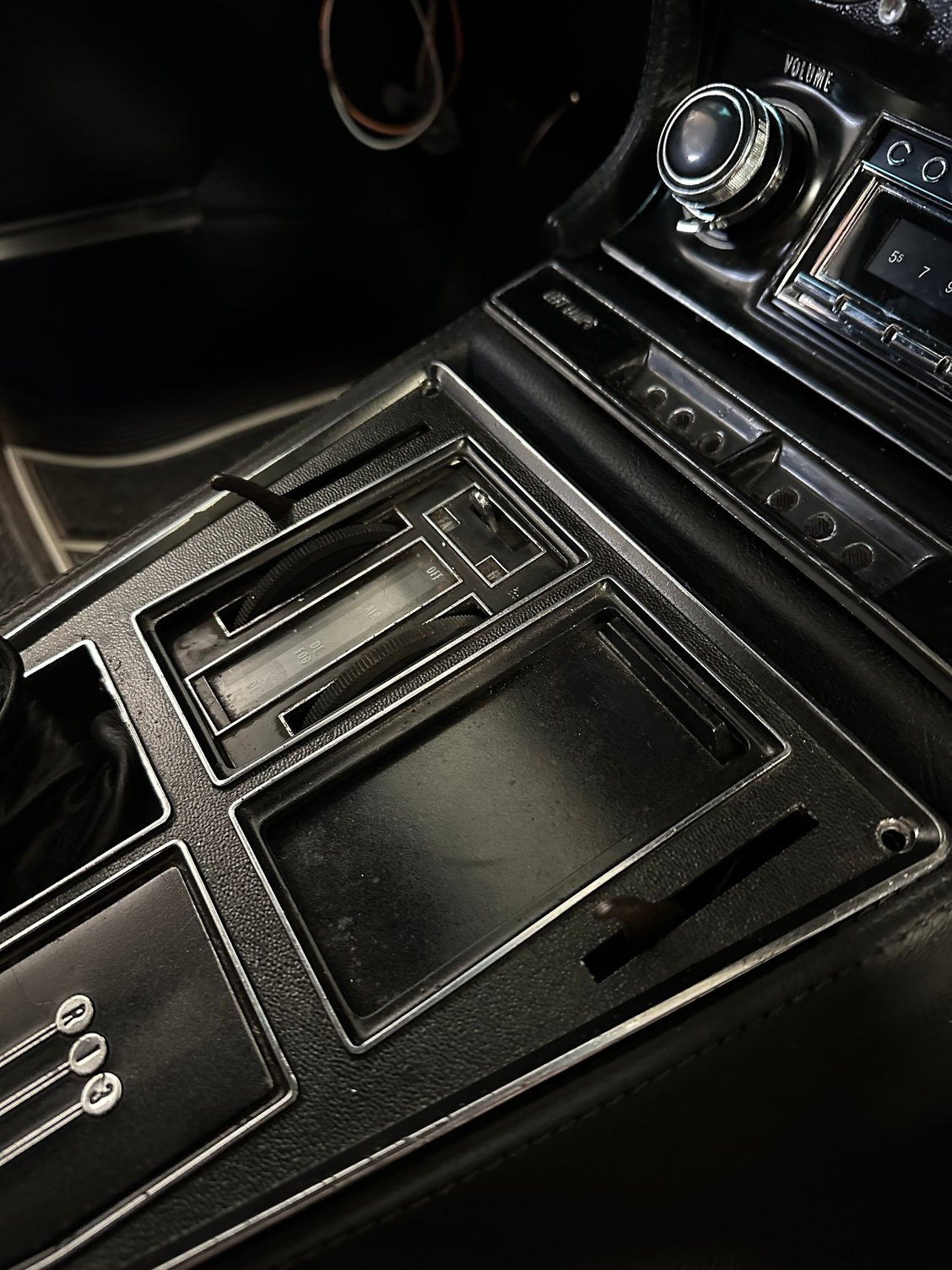

I realized I won’t be using a cigarette lighter so I enlarged the opening to add a usb port. Just open the ashtray and plug in. This connects to my updated stereo

I went ahead and deleted the ashtray as well. Besides the USB dual charging ports, I added a blue digital volt meter gauge. Nice supplement to the ammeter for battery charging diagnostic.

My lift is a standard 4 post and I can walk under the car when working. they are surprisingly reasonable ( about $3500 about 18 months ago ) runs on 110 current and works great . I do have a high ceiling garage but its not an RV garage. the best part its a 4 car garage and I can park 5 cars if I drive under the car on lift.

While taking some downtime from wrenching I thought I would do a cut and polish. Took me three days and my back still hurts. Wet sanded with 1000,1500,2500 and 5000. From there got the wool pad to buff then a foam pad. I don’t remember this being so much work when I was twenty som
