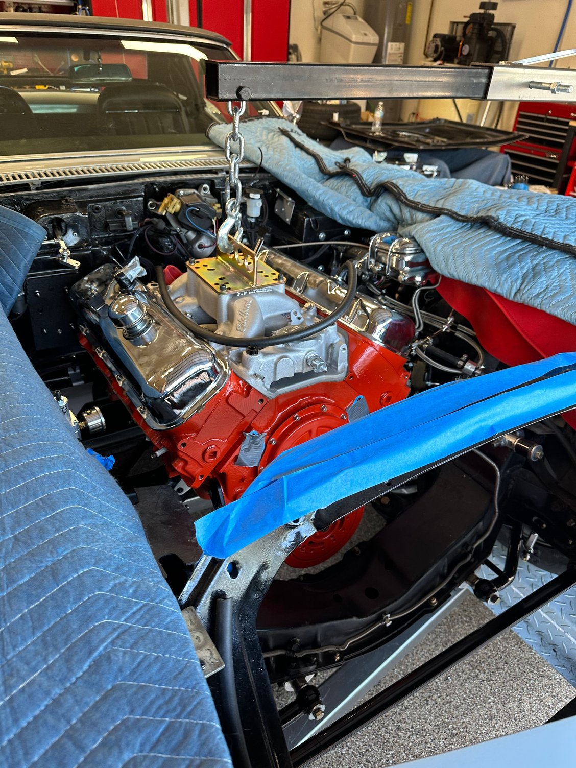

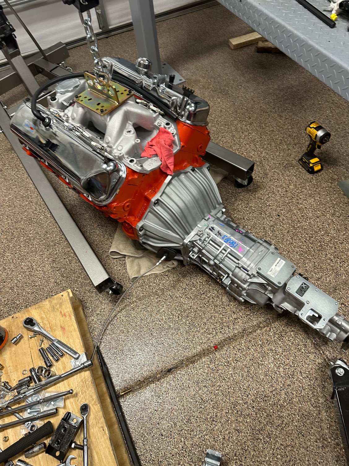

I made a lot of progress this weekend when my buddy was in town. We installed the engine, Tremec TKX, headers, DeWitts 4 core aluminum radiator with electric fans. Previous to him coming out I ran the lines for the hydroboost which I will terminate once the power steering pump is mounted. I do have to say the Tremec was not as easy as we thought. With the hydraulic release bearing it was a bear to get it seated into the pilot bearing. After installing the engine and trying several times to mate the trans under the car we finally decided to pull the engine, bolt on the trans and install as one unit. Hoisting the mated components over the fender and sliding it in under extreme angle was nerve racking to say the least. Thankfully I had installed a removeable cross member previously so this was possible.

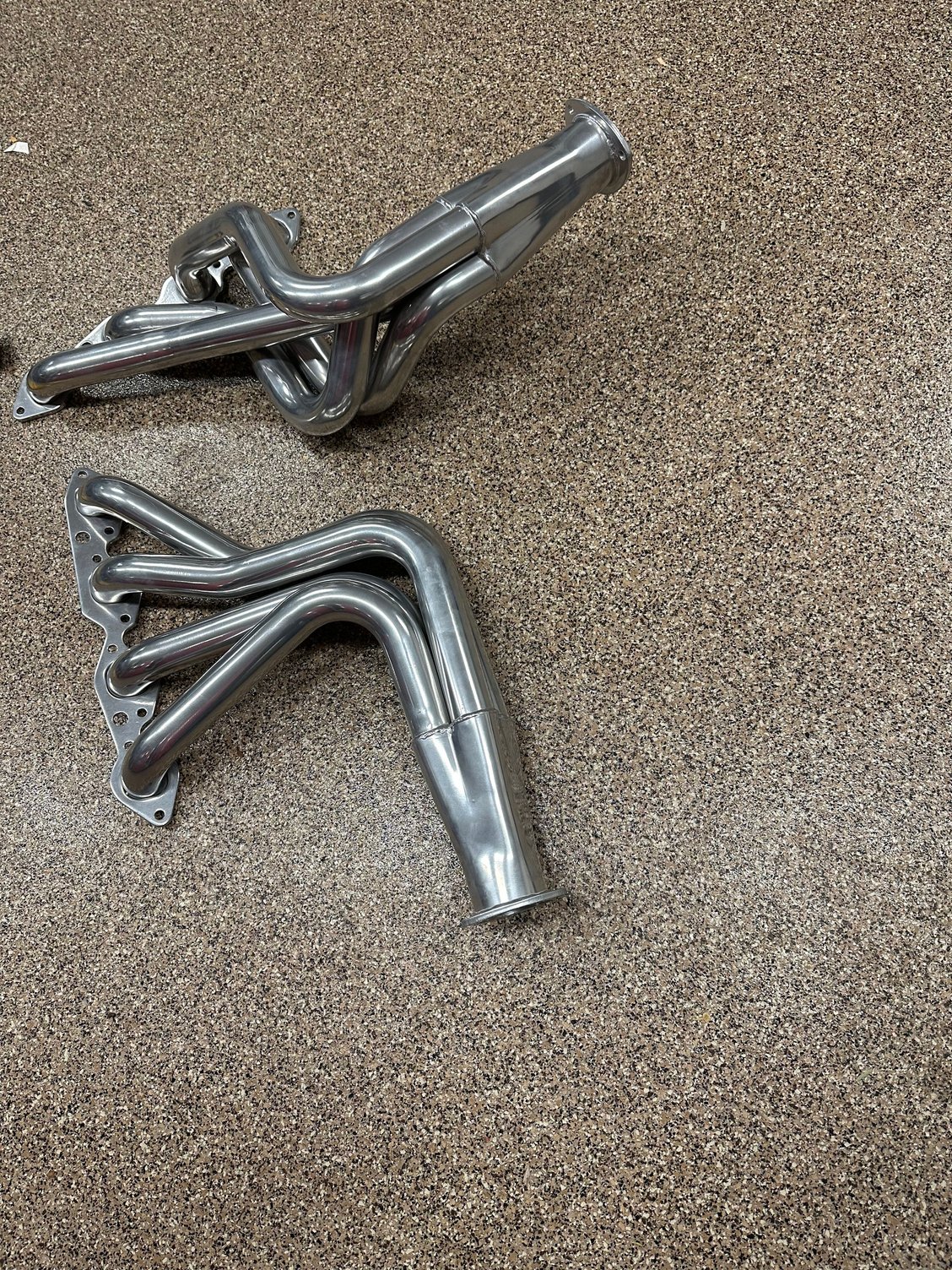

One note for those modding your cars with a Borgenson steering gear, its safe to say that a big block with Hooker long tube 1 7/8 headers fit without issue. One of the easiest header installs I've done. Not sure I will tackle another tremec install but at 67 years young I hope I never have to again. I just have to mount the alternator, steering pump, carb and assorted lines, finish connecting sensors and steering column before I prime the oil and drop in distributor for first fire up.

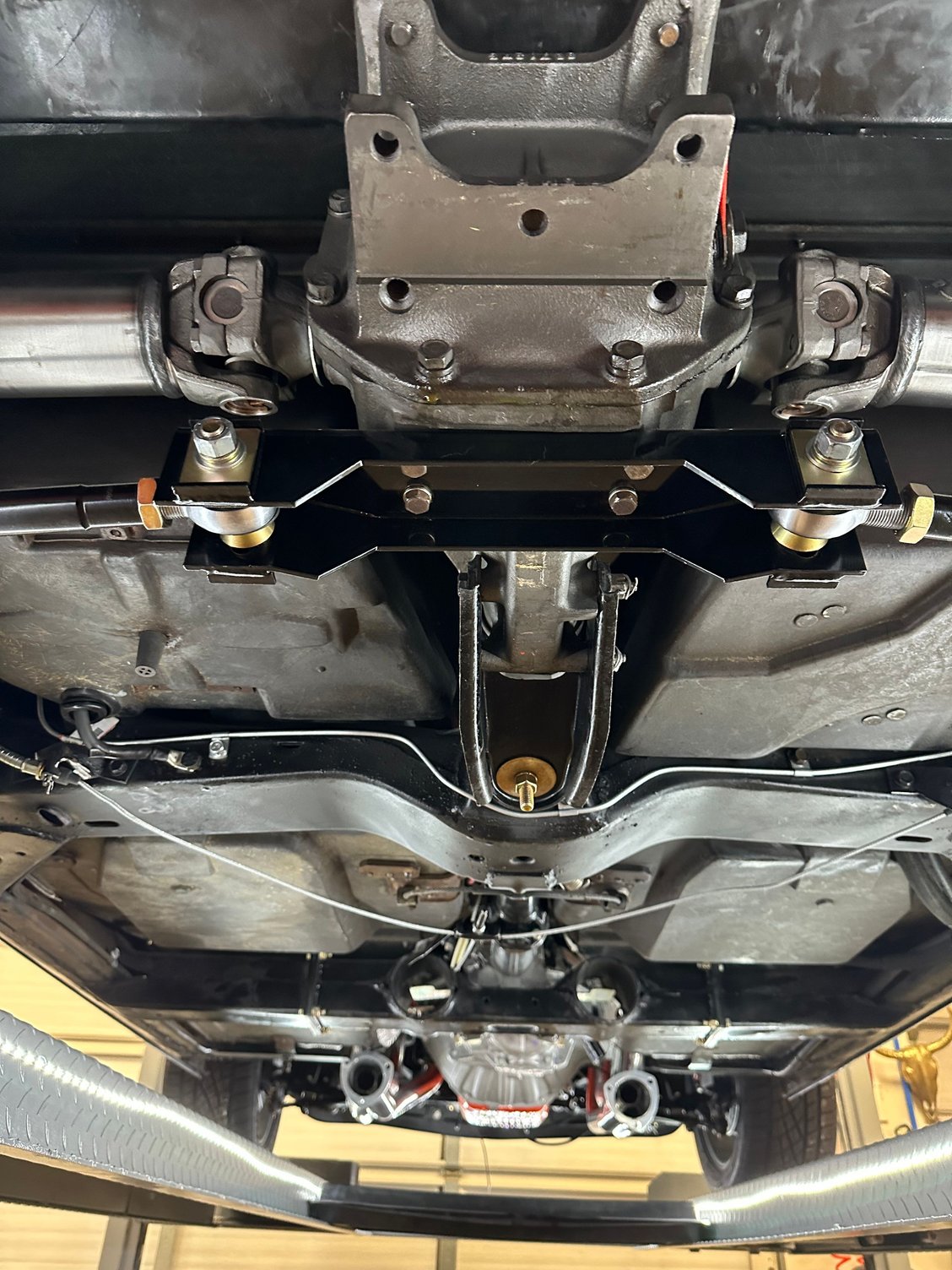

Tkx has plenty of room, just a pain to get it mated under the car. We pulled the engine and it slid together fine. Wish I had a body off chassis to make life easy.
I’m using spicers with 3 inch half shafts from Ft Wayne driveline.

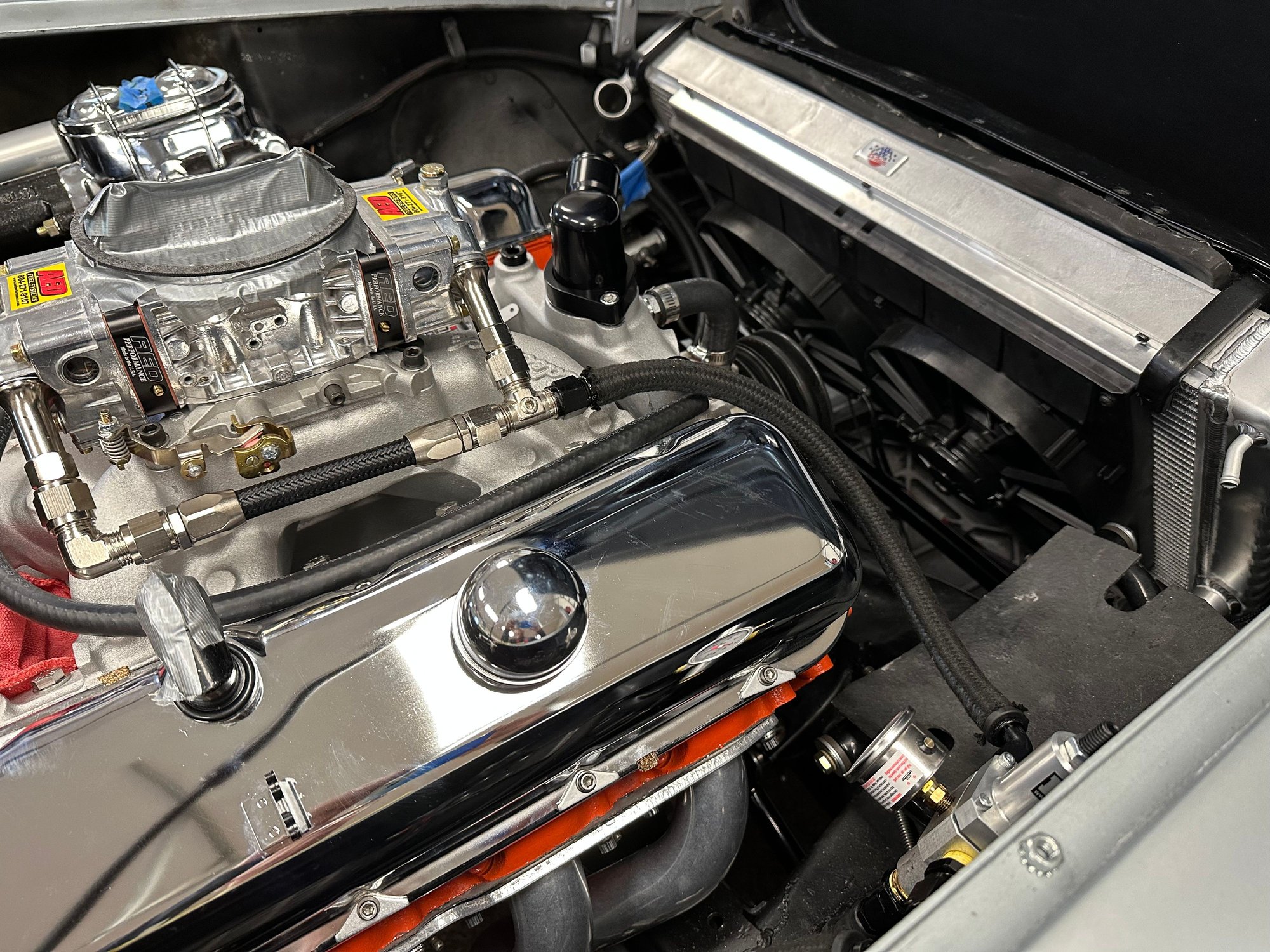

Finished the 8AN lines from regulator to carb and thermostat housing to intake. Still need to finish shifter install inside center console

These are spicer 1350 hd solid from Fort Wayne Driveline with the 3 inch half shafts
