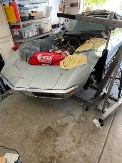

Well its been a journey to say the least. Sorry for no updates so far but I moved the car to my new house in AZ and getting ready to retire ( easier said than done ).
the good news is that my house has a large 4 car garage and I already installed a 4 post lift to help my old joints. my engine is getting wrapped up by Mark Jones at Vortec Pro and should be done this week. It will ship from Texas when done. I will share the dyno numbers when finished but it should be in excess of 570 HP according to Mark. As usual there were some surprises in this 52 year old engine that Mark had to deal with by it is sorted out.

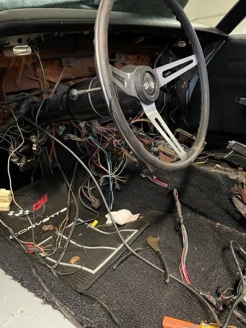

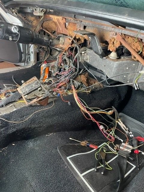

The car is on a lift as I am currently tackling the wiring which is a mess. I am glad I decided to go with an American Autowire resto kit. At least I know all the burnt and frayed wires are out.
Since the engine is out I am doing all the detailing I can without removing the body. Power brakes are going to be handled by a Hydroboost system powering Wilwood calipers. Vansteel on coilovers, tubular arms and offset trailing arms. I decided to go with Dakota Digital gauges to match the wiring.
Since I have a 3.08 differential i went with a wide ratio Tremec TKX. With a 3.27 first gear it will pull hard off the line and still get decent mileage ( LOL )
Ill post some pics when I have a chance but its far from pretty at this point.
Old Jan 4, 2023 | 10:57 AM
wvleon's Avatar
wvleon
Joined: Apr 2018
Posts: 190
Likes: 95
From: Phoenix, Arizona
some new photos to share
