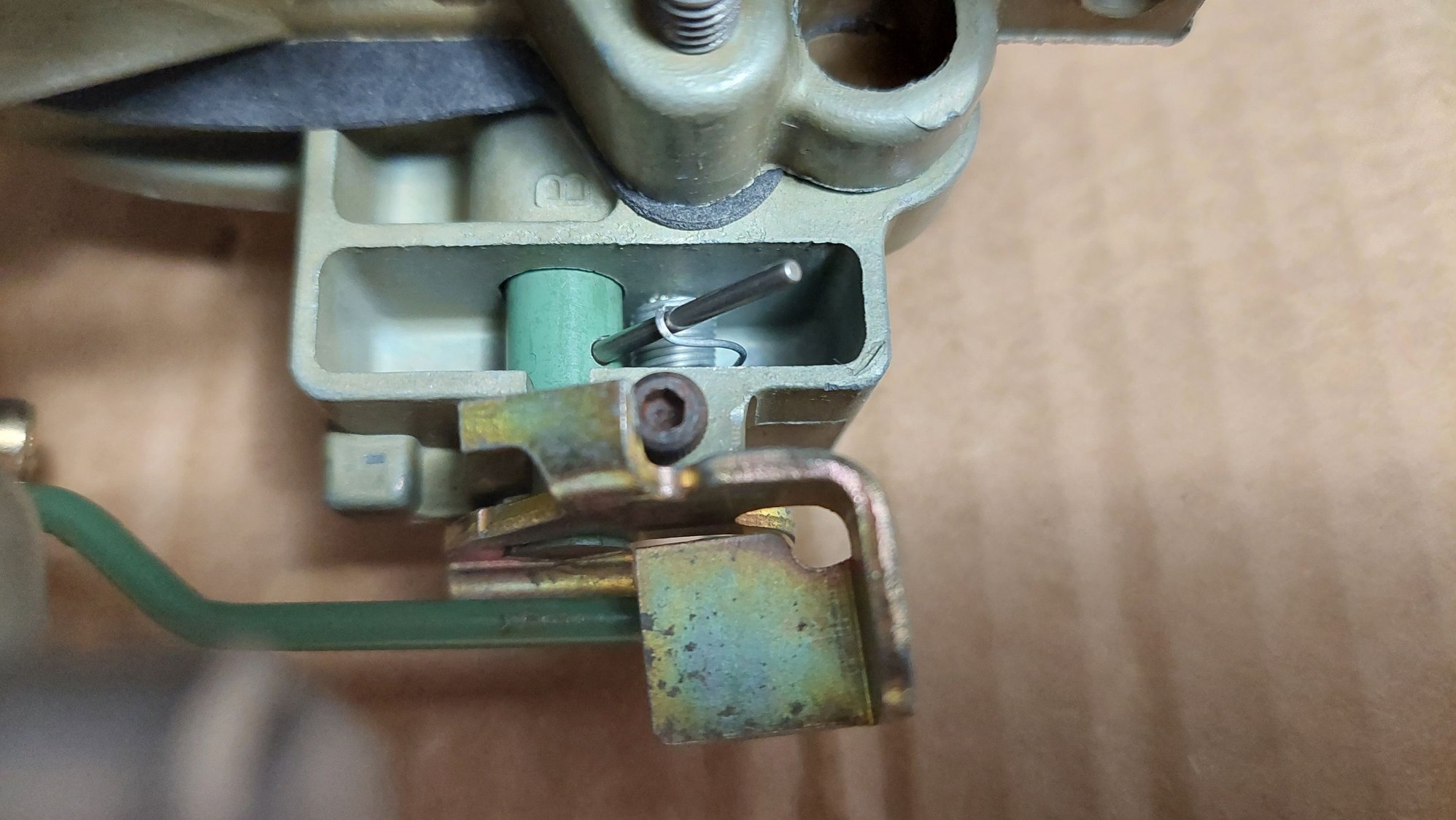

Do you recommend that before making the adjustment, air doors closed rotate the slotted shaft so the pin in main shaft just makes contact with the loop of the spring before making adjustment?
in case he doesn't answer soon, the 3/4 setting is from the point where you already have enough tension against the spring to hold the door fully closed so in order for that to happen the pin would have to be in contact with the spring.
