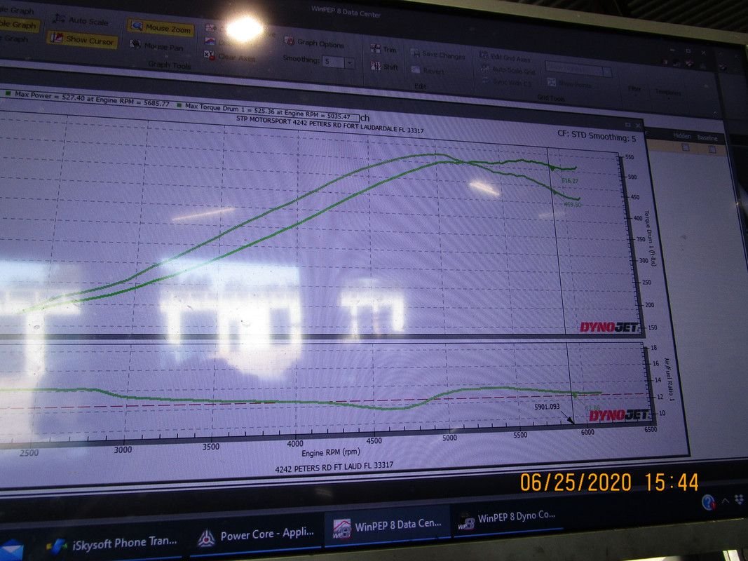

What I learned over decades of performance combustion is that for anything other than a true all out race car, I want the lightest spring possible, the lowest lift, and the slowest ramp rate on the lobe of the camshaft. This is how we can preserve the valvetrain reliability, control the valve well at high rpm.
It doesn't take big lift or powerful springs to make power. For example I am using a PAC-1218 valve spring and a cam with .520 to .550 lift ranges using a turbocharger and the slowest ramp cam lobe I can find. A turbo makes an engine more reliable as high exhaust gas pressure protects the rod cap/rod bolts allowing the engine to make serious power up top with factory bolts and rod hardware without damaging the engine bearings or pulling apart the connecting rod.
Here is TFS-30602001 which is a very slow ramp camshaft and fairly low lift couple summers ago on a 200,000 miles 5.3L w/ 4l80e
14psi of boost using 93 octane gasoline, no meth no E85. Just back to back dyno runs in the Florida summer heat, it was the hottest day possible.
5.3L free(low cost engine) from any junkyard with Stock lifters, stock pushrods, stock head, stock piston/rod/etc... Didn't open the bottom end. I put 40,000 miles on it since 2017 still driving it, reaching 220k miles this year total on the motor.
The high mileage helps the engine handle the power, everything is a bit looser and the compression is down a bit making it safe to spin and boost
I bet its close to 620rwhp now, I doubled the injectors since 2020 so I can raise the boost to max the turbo out. I am planning a return to the dyno, perhaps July again 2022 to see the difference.
Good results with a cheap engine from 2002 with 200,000 miles can be extremely reliable and make significant power using a small cam and light spring, gasoline.
It seems crazy to push the limits of cam and spring- using lift specc'd out to generate power is unnecessary if we are shooting for just 500 to 1000hp. What you really want is the turbocharger and a very low lift, a lazy cam. Hyd or solid roller, either will work great, just keep the lift down mainly. This way you can drive the engine like a normal car and it will last like a normal car and make decent power. And as a bonus, the engine is disposable, no investment, no problems no matter what happens to it.
