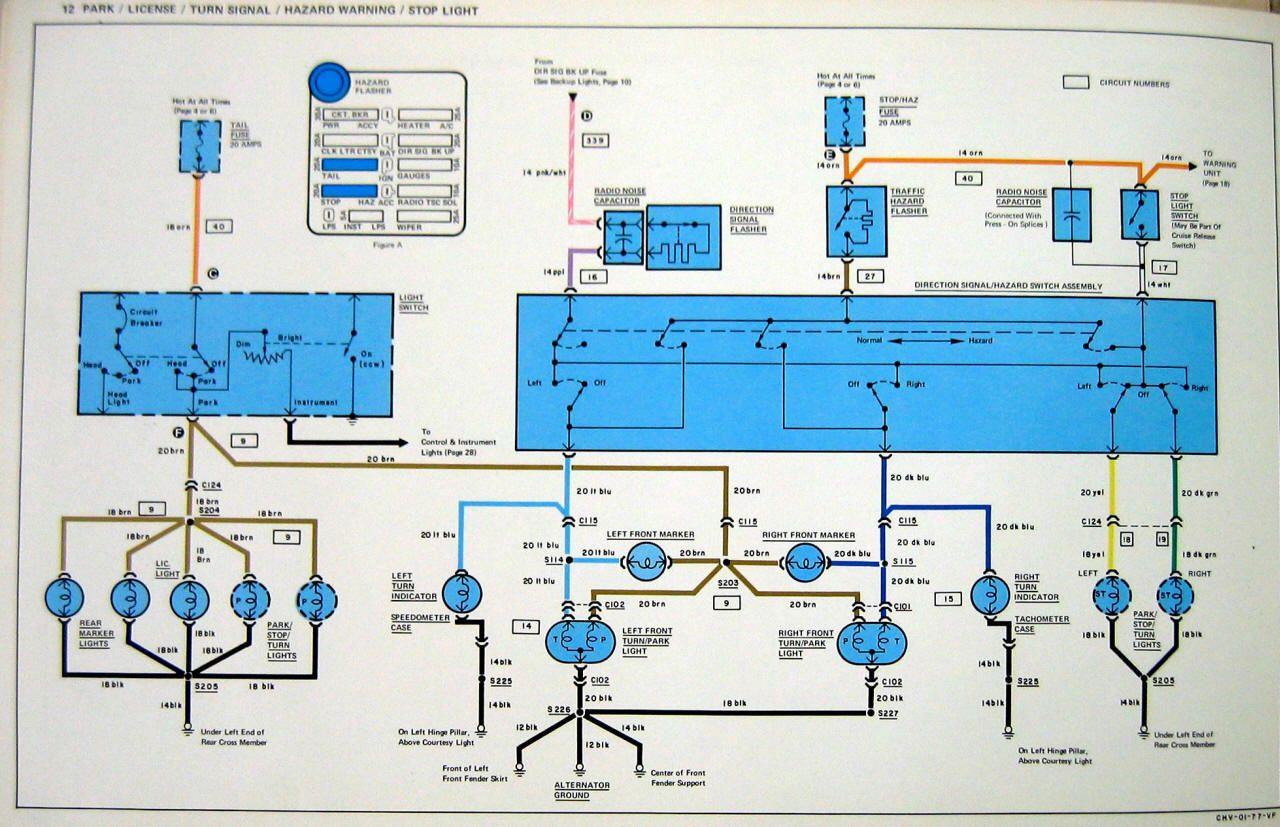

Before you start replacing stuff, isolate your problem.
Analyze your wiring diagram to determine what circuits could be responsible for your brake light problem.
Your directional signals work, but your 4 ways do not?
Do your backup lights work? Rear Side Marker lights? License plate illumination lamps?
I'd first start with simple and cheap. Fuse is ok? There is a common ground at body rear for Stop/Directional lamps - is that ground good?
Mapman
GM/Chevrolet wiring diagrams for your 1974 have circuit numbers. 1972 and earlier GM do not. Circuit numbers make it much easier to trace those "spaghetti" charts.

narrow down the problem (turn signal switch is a big pain to get at, remover steering wheel etc)
The brake and hazards are on a common fuse... is it ok?
M

Unfortunately the orange power wire that feed both the brake switch and the e-flasher comes right from the fuse box
Test the fuse for power at both ends (test light rather than a meter) and it it's ok and there's a problem with the wire (orange)
M
