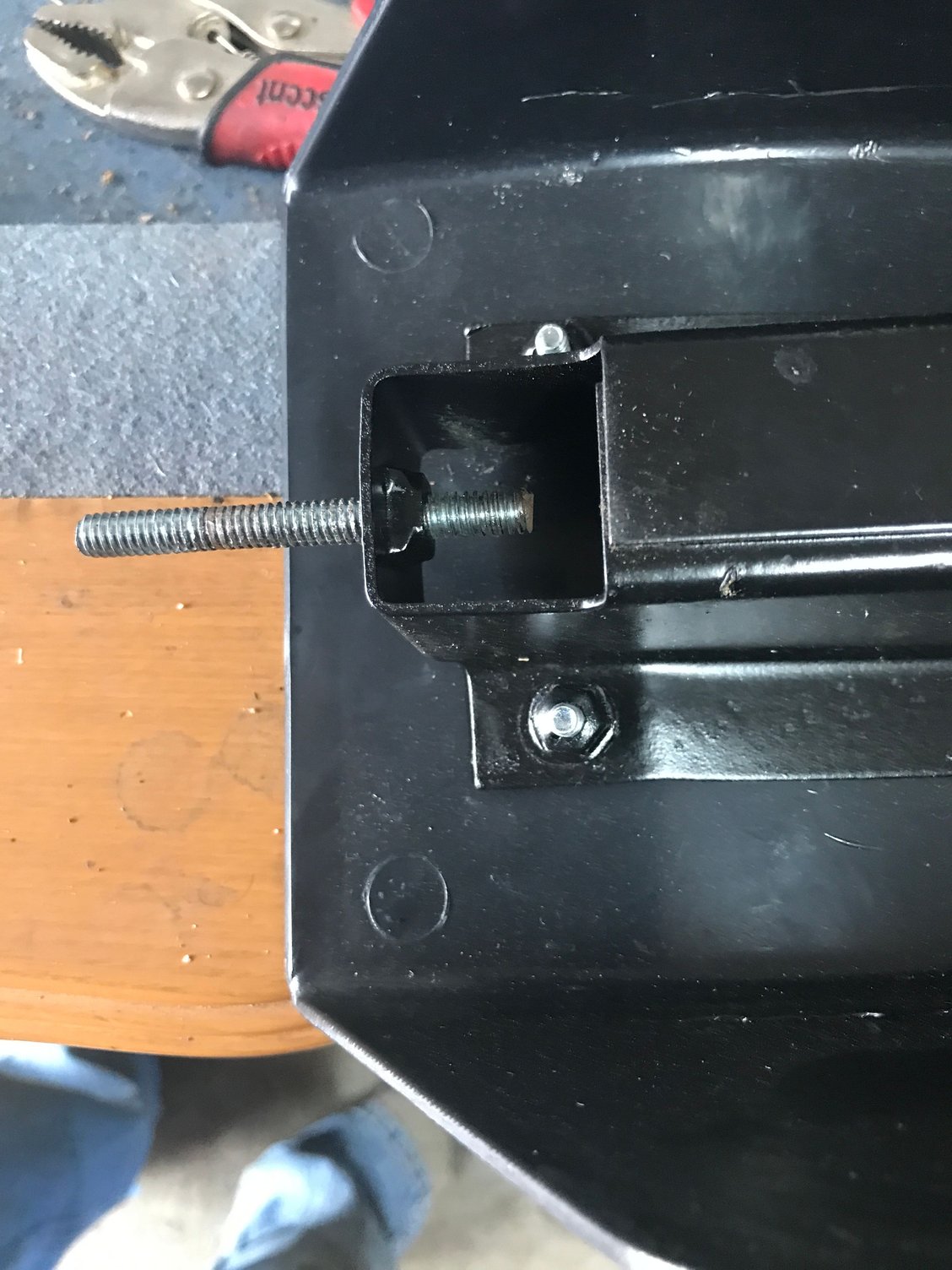

may I suggest wing nuts for the center console and put a stud on the back of the hand brake console instead of fishing for the hole with the bolt thru the bulk head
