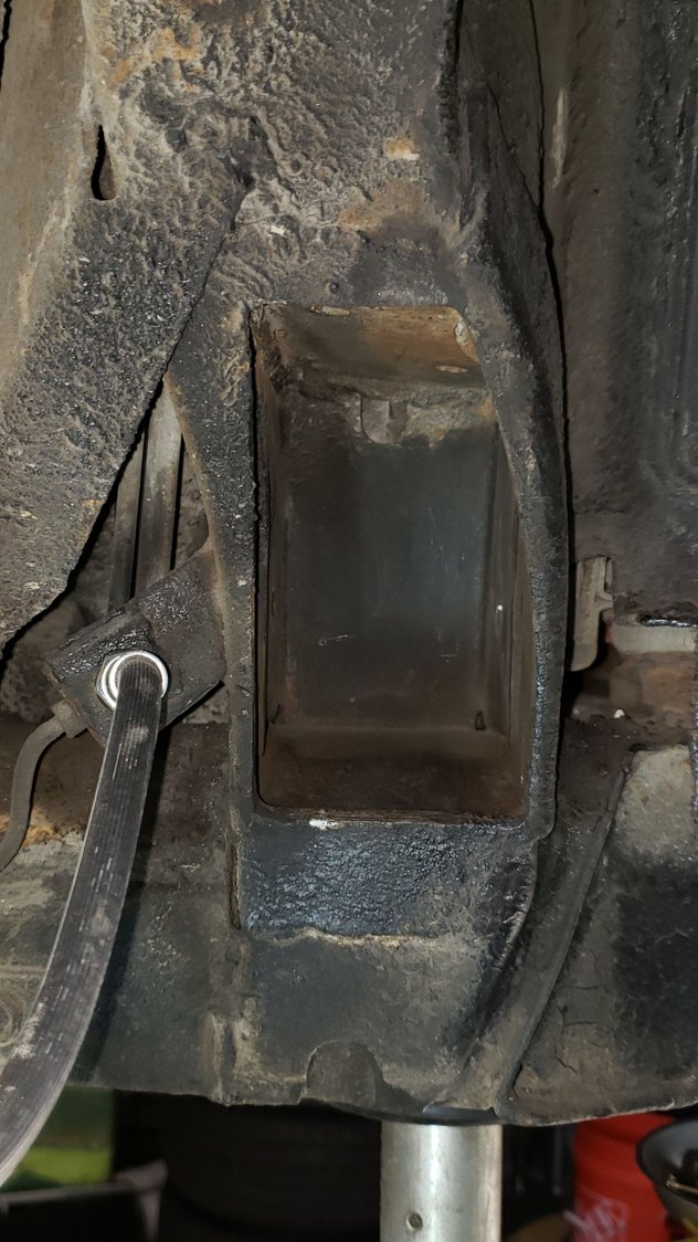

I had to cut them out and it took quite a while. I am surprised how good the frame looked after removing the shims which were one large clump of rust.
