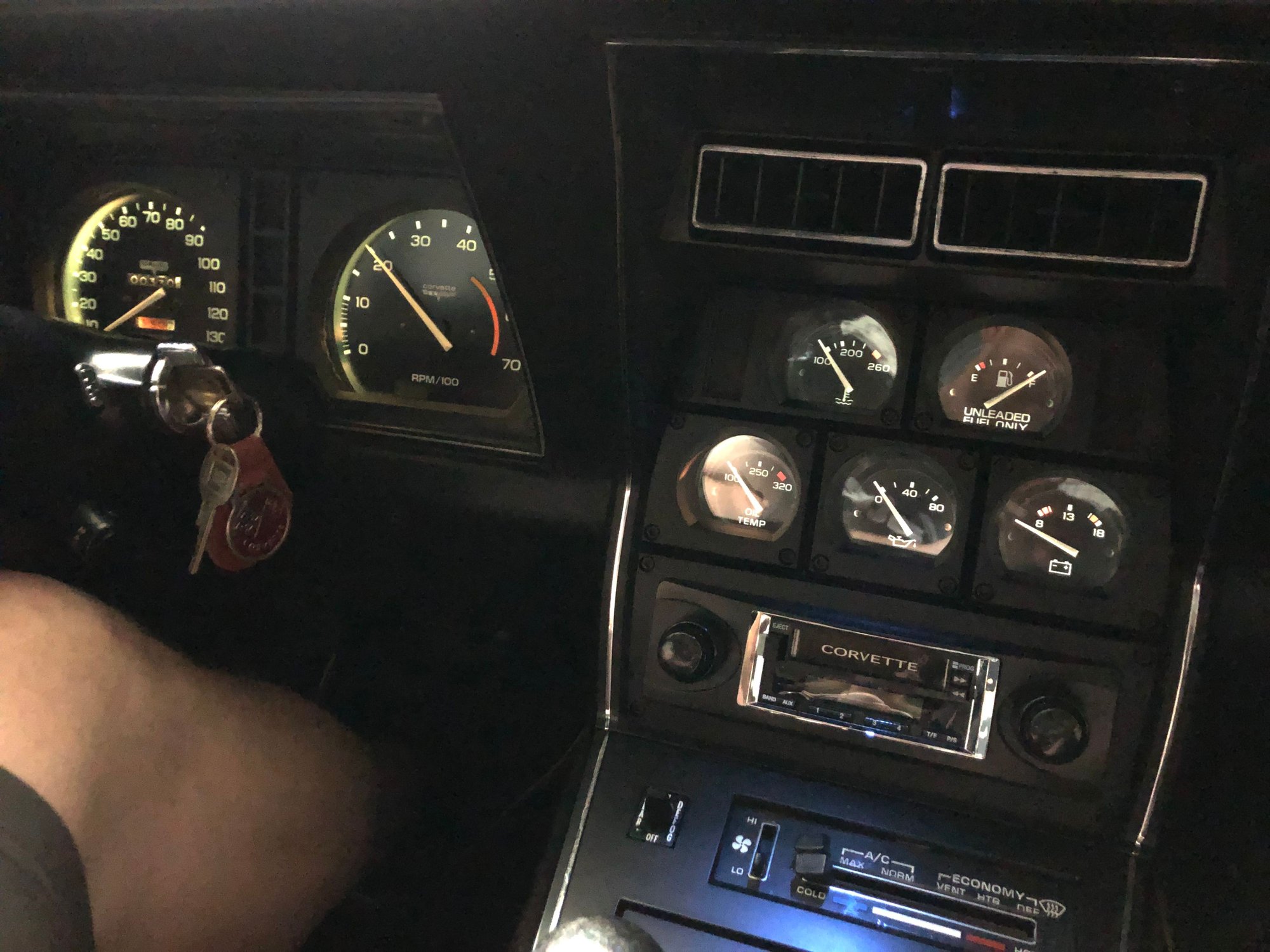

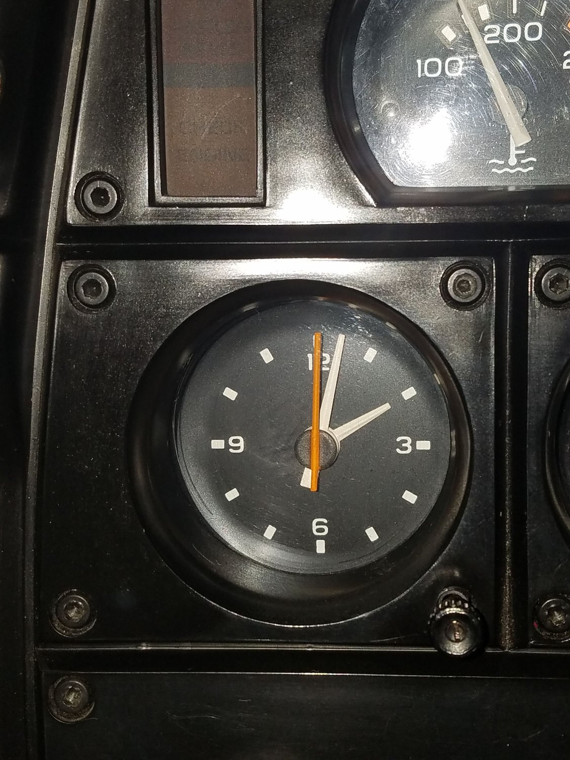

I have a non-operational clock in my 1980 corvette. Can someone please tell me if I can remove the existing clock without removing the entire center gauge cluster?
There are 3 allen screws and one **** on the clock face which can be removed I believe in order to remove the clock? Or do I have to pull the center gauge cluster and remove the clock from the back. Also, are these allen screws on the from of the clock, if so, I cant seem to find an allen wrench to fit.

The allen screws are just for decoration and are part of the center cluster.

Yes you have to pull the gauge cluster and remove the clock from the back. Like stated above, the allen screws are for looks only. They don't come out.

I also have an 80, and having issues with clock as well. There are 2 screws up top in front of air vents, 2 on the sides in front of gauges, then there are 2 on each side in the bottom. The bottom ones are screwed into center console, so be careful not break plastic. You must first remove side carpets to get to bottom ones.

cmon where is sense of adventure and nostalgia?
as above..
- pull seats
- pull side carpets
- remove screws as needed PAY ATTENTION TO the top and bottom screws and be careful on the light in the top as well..
a great opportunity to clean the plastic gauges front and back to look like new and any bulbs that need to be replaced..
not a horrific job..

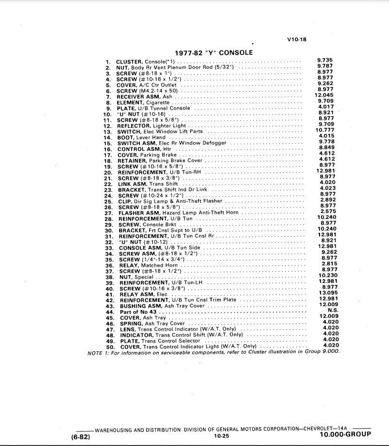

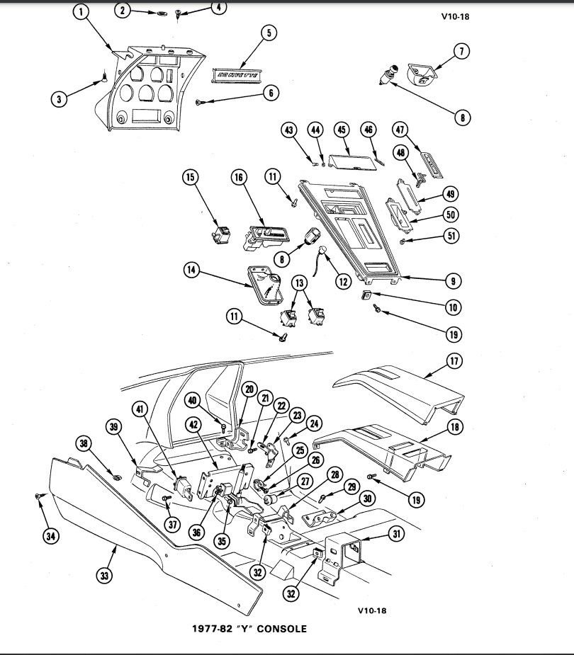

get a manual and AIM, or at least get this for free..
https://www.corvetteforum.com/forums...ette-lonk.html
here is my repair
https://www.corvetteforum.com/forums...ck-repair.html
from the parts and illustrations download

Thank you, now I understand the Allen screws are only decorative

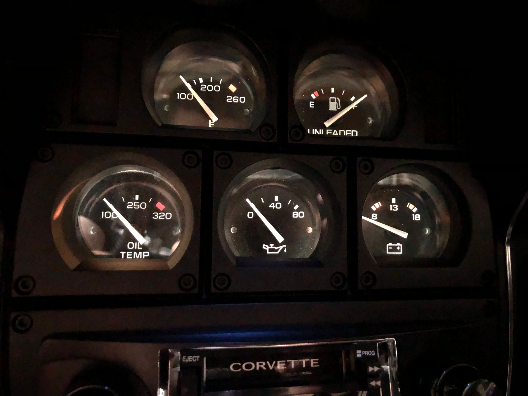

You could also replace the broken clock with an oil temp gauge from an '81-'82 like I did.
Its kind of a pain to take all that interior stuff out just to get to that damn clock.

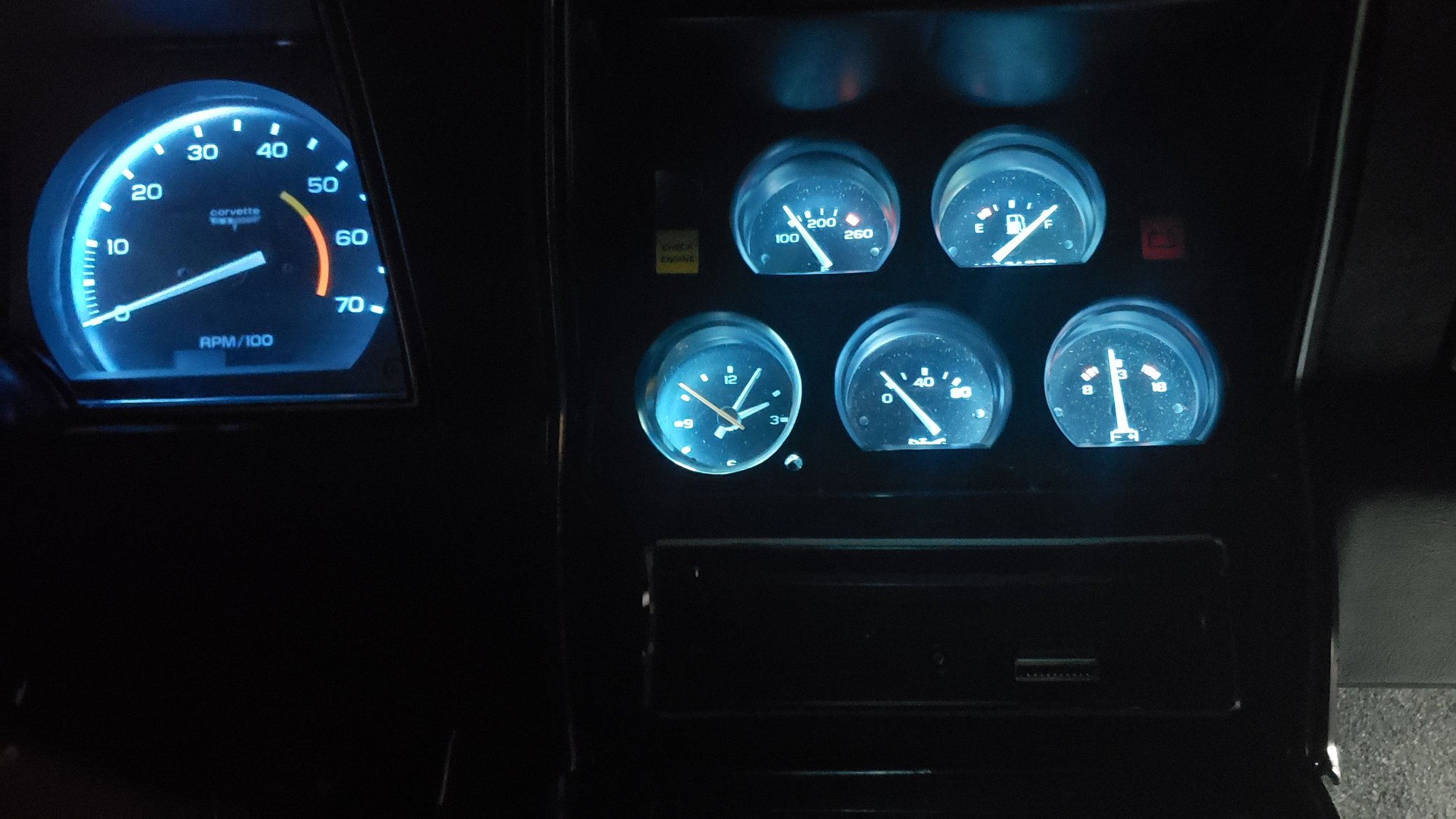

While you take it apart you can also change the bulbs to (LEDs) a color of your choice and paint the interior.
Blue LEDs and painted plastic background.

Zip sells an oil temp gauge that was stock in 81 and 82 C3s. Might be more useful than a clock.
