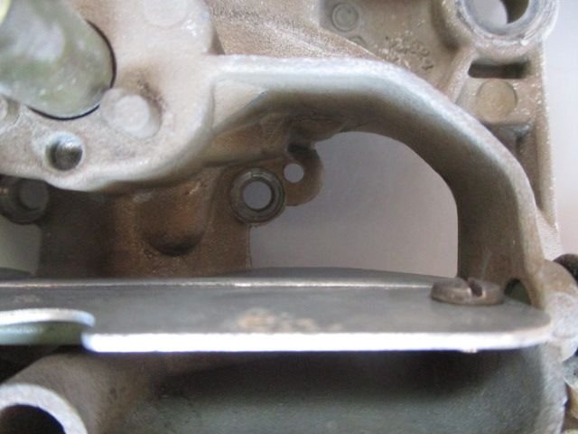

For the benefit of those wanting some more info on the problems associated with these "mix-n-match" commercially built carbs that are pieced together with various different makes and years of parts, here are some things to look at and why these carbs cannot be made to work.
As noted, the OPs carb has been pieced together with parts from different carbs. The float bowl is stamped 7042902, which is a 1972 Vette 350 California carb. The OP owns a 1970 Vette, which should have a 7040207 (if it's the high performance engine option with manual trans). He has indicated that the '72 carb has been set up to mimic the '70 specs. The jetting on the stock 1972 carb is 74/45 (jet/rod), and the jetting on the '70 carb is 76/44. We might, then, assume that his '72 carb has been re-jetted to the 1970 76/44 specs.
We also know that the carb's throttle plate is not a 1972 or 1970 throttle plate since the throttle lever has been cut off and a 1972-style throttle lever has been screw-attached to the primary shaft. So the idle air bypass hole sizes in the throttle plate are not correct for the carb. But of greatest concern and intrigue is the airhorn on the carb (the "top" of the carb). The airhorn is not only the incorrect year (it's neither a 1972 nor a 1970), but it's also off of a Marine carb. Here is the airhorn on the carb:
Originally Posted by djs70vet
If you look down the primary venturies, you can see the 2 airhorn attach screws (incorrect silver phillips screws in the bores). Just forward and outboard of those screws you can see air bleed holes. Those are the upper main air bleeds. Note that they have brass bushings pressed into them to "size" the bleeds. Chevy Q-Jets up through 1969 used these brass inserts to restrict air bleed into the main fuel discharge circuit. This is the reason that a 1969 and earlier Q-Jet can use main metering jets in the 66 - 71 size range. Starting in 1970, Rochester removed the brass upper main air bleed restrictors, and simply left the upper main air bleeds wide open at .120" diameter. To compensate, the primary jets were bumped up to sizes typically in the 74 - 77 size range. If a 1970-72 float bowl is used with an airhorn equipped with upper main air bleed restrictors, and if the 1970-72 bowl is set up with the jetting for that bowl (in this case with either 74 or 76 jets), the carb will run pig-rich at all conditions other than idle. It will run terrible.
But, wait... look at the photo again: Just forward and inboard of the main air bleeds you can see additional air bleed holes in the OPs airhorn. These holes are upper idle air bleed holes. Rochester had 2 different configurations for upper idle air bleeds: Early (pre-1968) Chevys and many of the Buick/Olds/Pontiac carbs had these air bleeds in the airhorn as shown in the photo above. After 1968, the Chevy air bleeds were moved to the float bowl, and were drilled from the idle fuel down channel into the venturi of the carb. Here is a 1972 airhorn that should be on the OPs carb. Notice the large .120" diameter main air bleeds and the lack of idle air bleeds:
If an airhorn with idle air bleeds is used on a float bowl that also has idle air bleeds, the carb will do nothing but suck air through the idle metering system, and the idle mixture cannot be controlled by the idle mixture screws. Since the carb will not idle properly, the idle speed will typically be cranked up to get the carb to idle on the main discharge circuit, resulting in some very poor idle quality with erratic and rough idle.
Look also at the OPs airhorn photo above and notice how the forward casting wall around the choke tower wraps around the bowl vent tube (which is installed backwards). Chevy car Q-Jets never used an airhorn configuration like this. The airhorn is off of a Marine carb. The 1972 Chevy car Q-Jet airhorn looks like this:
The 1970 car is similar, but has the hole in the forward surface for provision for the idle vent system:
So not only is the airhorn on the OPs carb not a 1972 or a 1970, it's not intended for a car carb. By having air bleeds incompatible with the float bowl being used, the carb can never be set up to idle or run right, no matter what you do with setup and jetting. It's possible that the commercial builder may have plugged or smashed the air bleeds in the float bowl (often done by commercial builders using a drift punch and a hammer to smash the air bleeds closed and destroy the bowl casting), but this just further hacks the carb, making it generally unusable.

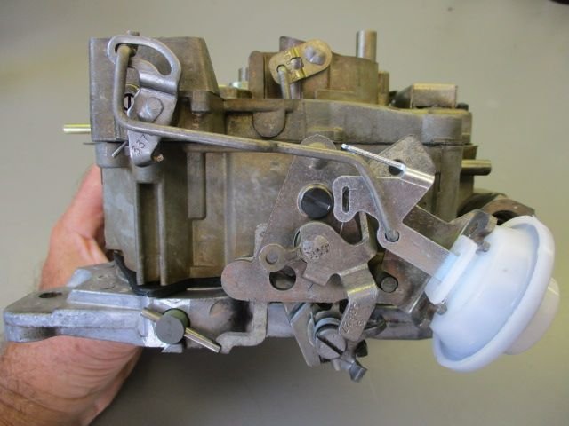

Further mix-n-match issues on the OPs carb is, obviously, the choke system. Here is the system installed on the carb:
It is a 1969 choke system with a 1972 fast idle cam installed.
Here is a 1969 choke system with the correct fast idle cam for a '69 (Service Bulletin steel replacement cam):
This is a correct 1970 choke system:
...and here is the 1972 choke system that should be on the 1972 float bowl. Notice that the 1972 system requires a 1972 airhorn with the non-slotted lever in the secondary airvalve lever, further "giving away" that the OPs airhorn does not belong on the 1972 bowl:
So watch out for these commercially assembled carbs. Many of them are not only unserviceable, but actually cannot be rebuilt or saved without replacing the major components of the carb.
