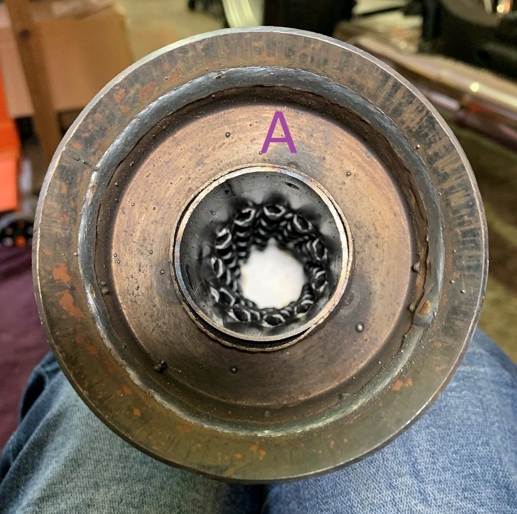

So...pictures:
Which side is for the FRONT? Is it A or B ?
Thanks!

I guess you could try it both ways. Looks like using side a as the input would break up the exhaust flow more.

A is the inlet and B is the outlet.
And they are extremely restrictive however a fair bit quieter than new stock mufflers.

the inlet is A so that the exhaust gas can enter the small perforations and break up the sound. If you use B the exhaust just flows past the perforations.

Note how on this reverse flow/quiet no perforations and hole is offset. You are sure you have the correct insert?

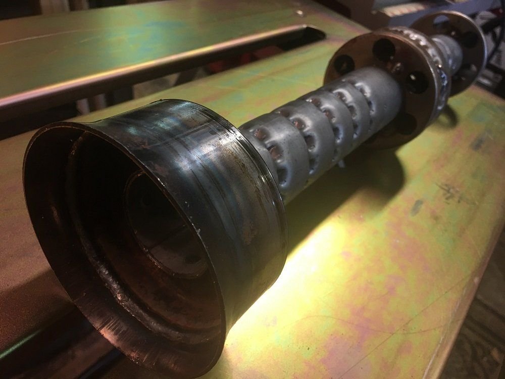

I checked mine on the car, they are installed with the punched holes facing forwards just as they would be in a standard glass pack installation.
Here are photos of the Hooker 21002HKR cut apart.

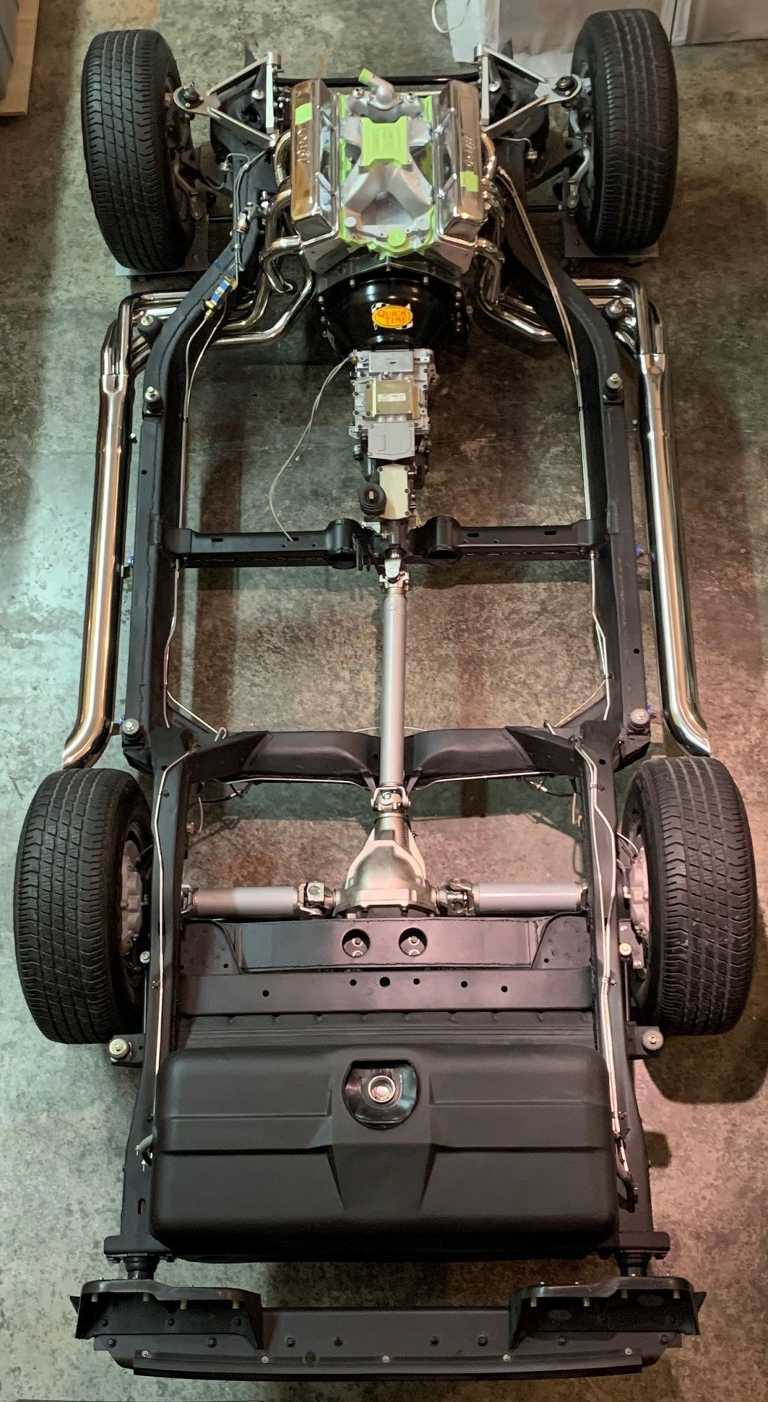

Picture time:

LOL, your photos really helped me figure out the flow path, thanks again.
