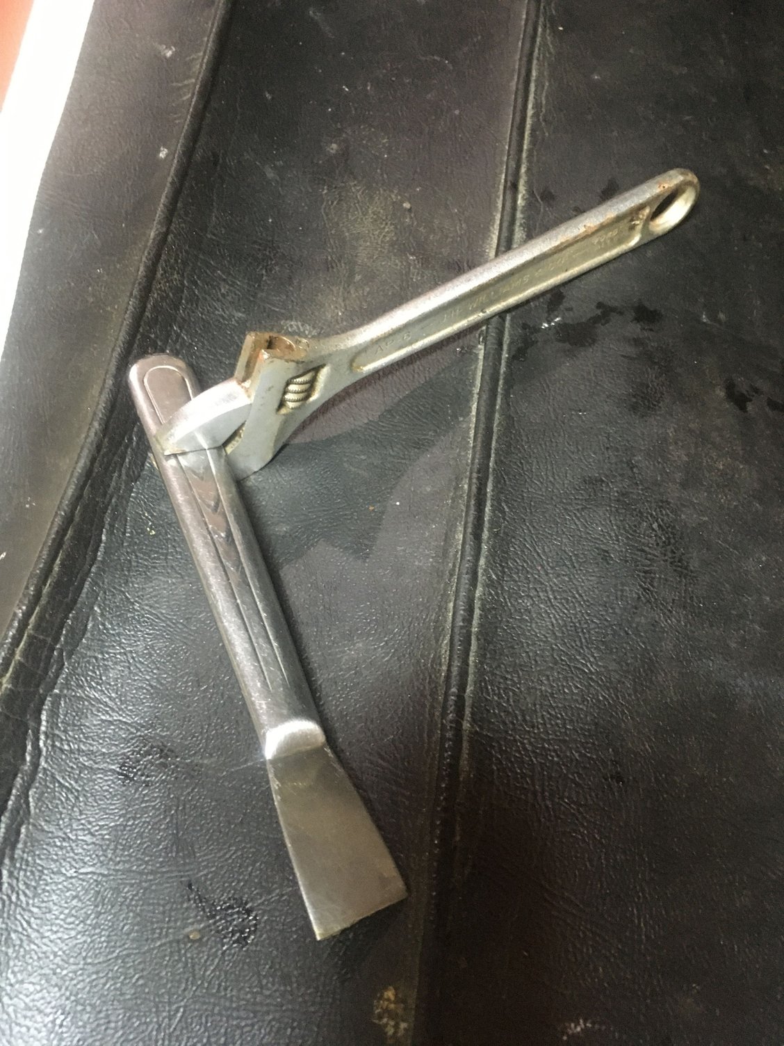

I’m about to swap out the distributor cross gear assembly for my tach drive.
Went out today to see what I could get in a screwdriver with a thin blade that is about 3/4” wide and no luck so far. Looking like I have to fabricate my own tool to remove the old assembly and install the new.
What have you guys come up with for this ?

Just a flat piece of steel sheet metal that fits tightly in the groove, and then a Crescent wrench to apply force to the sheet metal piece.

I used a short bladed engineer's square. The end of a steel rule may work. In my experience, they're not in there all that tightly. Even the back of an old butter knife would probably work!

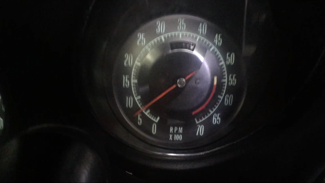

Had the needed part for awhile but have been dodging this job and getting others done. Still when I drive the car I’ve got that dead tach staring me in the face.
so last weekend at a cars and coffee I was speaking with a fellow who

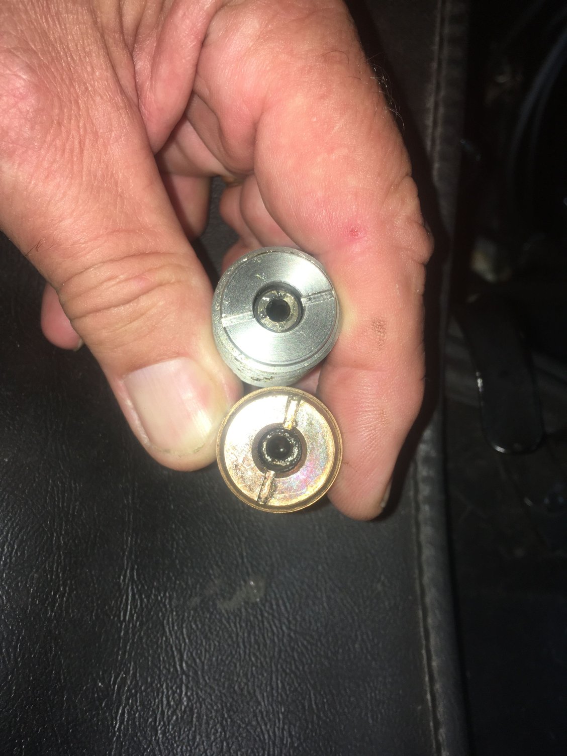

had a ‘68 427 car too and had the same tach issue. He said he changed the cross gear, it wasn’t hard and it fixed the issue. Great ! This was what I needed to hear to get motivated to do mine.
I needed that 3/4” wide tool to fit the end of the assembly. I cut a butter knife (don’t tell my wife ) used a wrench on it and it worked perfectly.
Comparing old and new I really couldn’t see and obvious reason why the old gear didn’t work….
but as they say the proofs in the puddin
