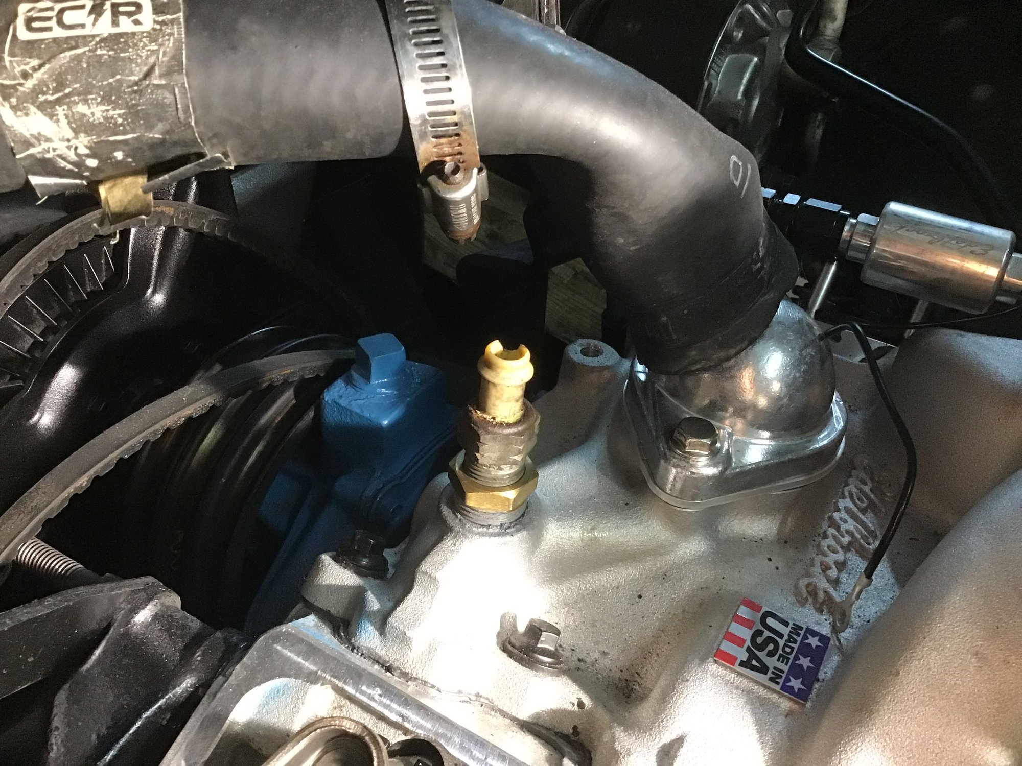

And might have to make this work,with a different hose of course.

I’m curious if I even need this one hooked up,I thought the sensor on my head was my temperature.unless I have two of them.

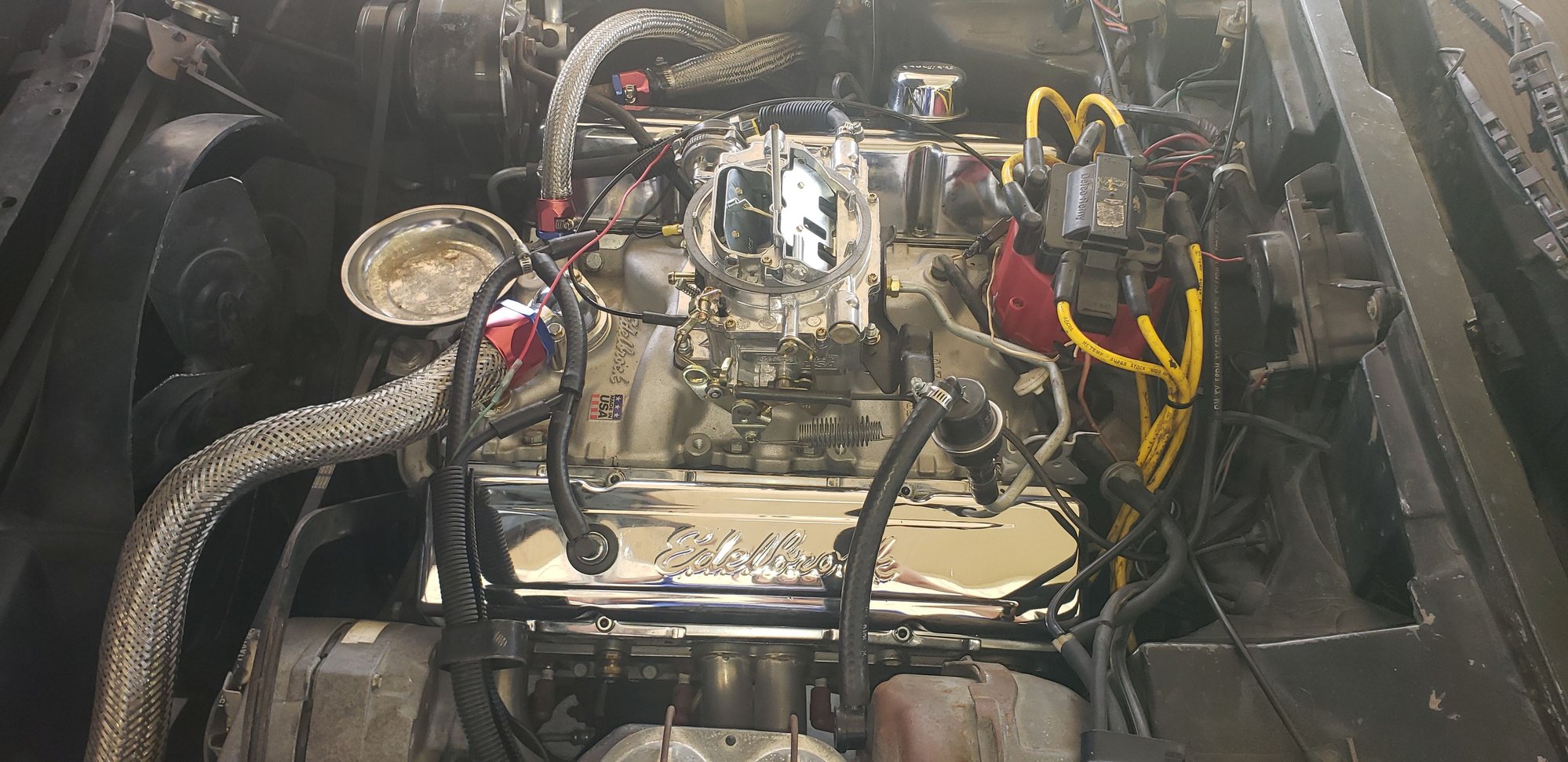

Originally Posted by Golferdad
I think I saw on one of my earlier post,that someone said I can switch to intake,but curious where at,I do have two holes, one for the water temperature sensor,and one for heater hole,is there another hole somewhere I can use?
This,I have assuming that is heater hose that runs to water pump.
I have to replace the waterneck to upright to put my temperature sensor there.so,where could you put another sensor?
I have the 64 cc E street heads and we were able to put the temp sensor with no problems.
Forgive me for including the magnetic tray in pic. LOL.

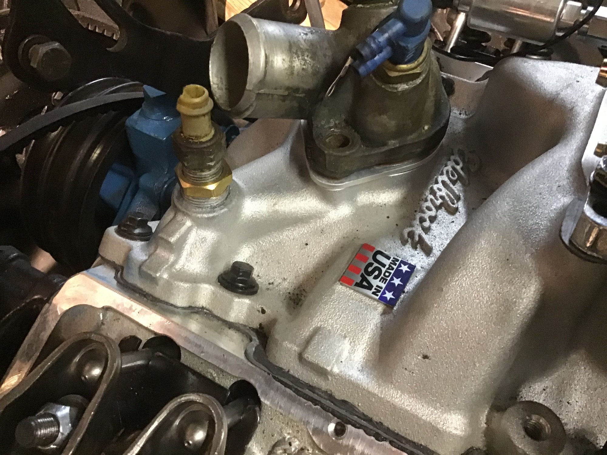

Well,I don’t even see your sensor,so,I’m sure you’re radiator hose is on top of it,and I’m also assuming you’re hole is 1/2 which my hole is 1/2,but once again my sensor is 3/8,so have to have a reducer from 1/2 to 3/8 which makes it over 2 inches tall.

I keep hearing people say they have this same set up with no problems,and I say IT WILL NOT WORK. And I have the assembly manual and it shows 2 temp sensors.

If I didn’t have the reducer screwed in the intake,I could probably make it work,and for the time being will put a plug in it till I fire it up,and go from there.

[QUOTE=rmrtrex;1605333864]I have the 64 cc E street heads and we were able to put the temp sensor with no problems.[/QUOTE
Here is a better picture of sensor on E street heads. I think we have the same one.
