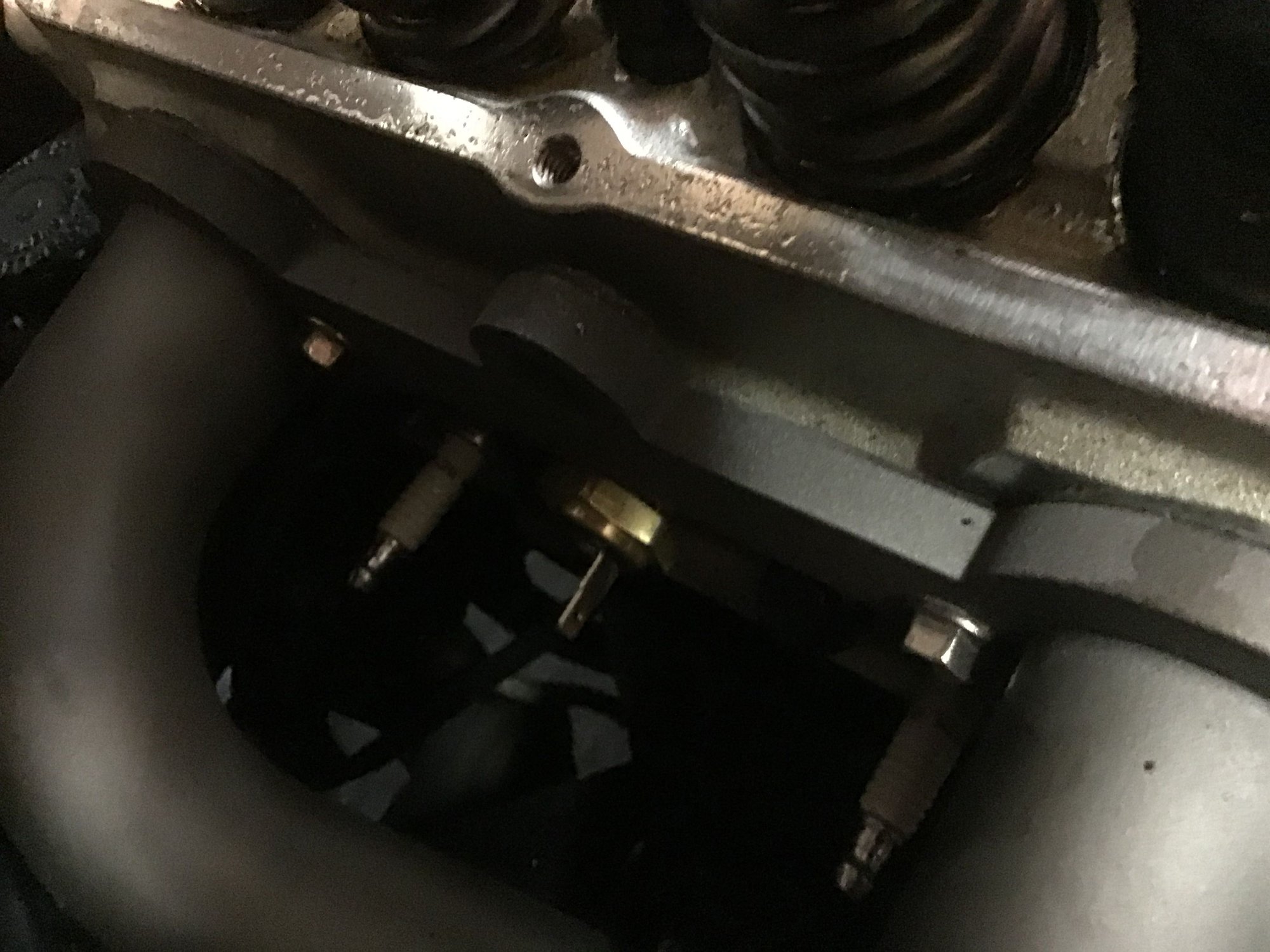

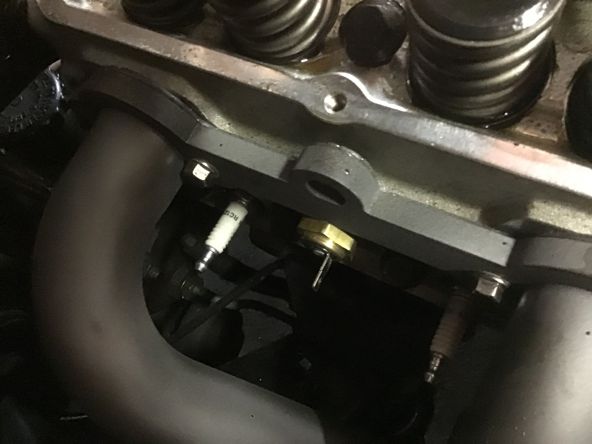

I replaced my heads with Edelbrock E street heads,these heads are 1/2,not 3/8 like stock heads,so ordered a new from a earlier model that were 1/2,I think early 70’s.
The problem is I can’t screw it all the way in because it’s wedging,actually barely the corners are hitting headers,but I can get half the threads in the head before it hits headers,so not sure if that’s enough,and if it would seal.so,first will this even work with my 🚗,and to get it screwing all the way in tight,do I need to take a little off the flange of header.

Why not use an adapter for the sender rather than taking a chance the sender will not provide an accurate reading to the gauge?
Grind the header flange if you have a clearance problem.

get a 1/2 to 3/8 bushing. and use orig sensor.

I would grind the header flange for it to clear, or consider moving it to the intake. Additionally, before you install it you should test it. Lots of the replacements do not have the correct resistance for the gauge to read properly at temperature. To test it, put it in boiling water on the stove and read the resitance to make sure it is where it needs to be.

I tried that also,but then the bushing will hit it also,because the other side passenger side also has a sensor,I think either for the transmission or possibly something with the fan,not sure,but I have to use the original sensor for that side,so I do have a bushing to reduce to the 3/8,but still same issue it is hitting headers,so sounds like taking the headers off again,and grind enough off to clear it.

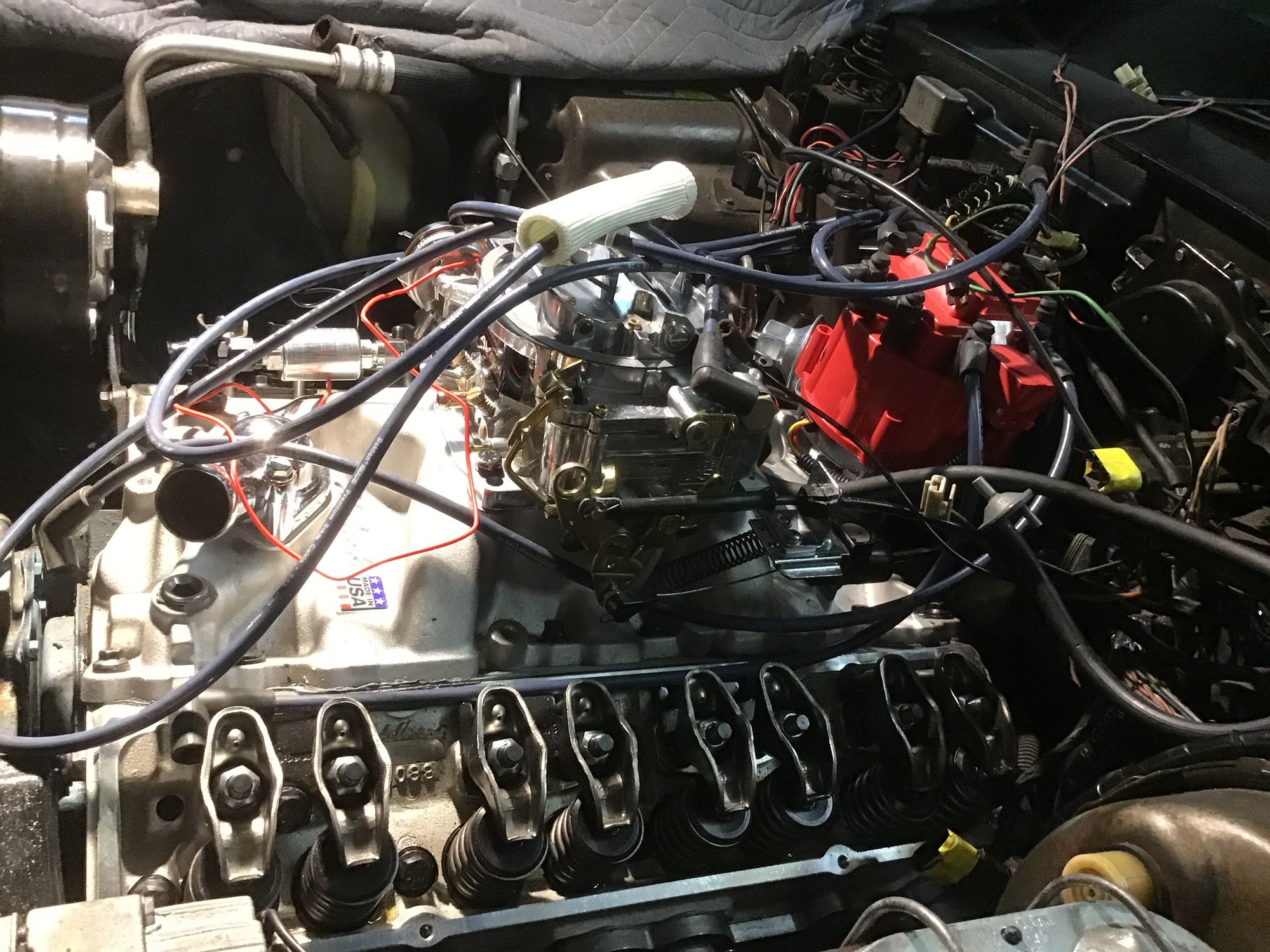

I think I saw on one of my earlier post,that someone said I can switch to intake,but curious where at,I do have two holes, one for the water temperature sensor,and one for heater hole,is there another hole somewhere I can use?
This,I have assuming that is heater hose that runs to water pump.
I have to replace the waterneck to upright to put my temperature sensor there.so,where could you put another sensor?

That is truly the thickest header flange I have ever seen. What are those, 7/16?
I would take a Sharpie and trace on the header flange where that sensor needs to go and how much clearance too. Then move the header back from the head and grind away. Perhaps a Dremel w/ metal cutting bit.
Regardless of what type of thread sealant you use, only apply it to the last few threads, away from the tip. You want a good coolant seal, but you also want an excellent GRD for the sensor / gauge accuracy.

I mounted my original sensor on the intake manifold where that plug is under the coolant water hose outlet in your last picture above... also have a newer digital temp sensor mounted in the passenger side head... They read the same. electric fan sensor mounted in drivers side head.
