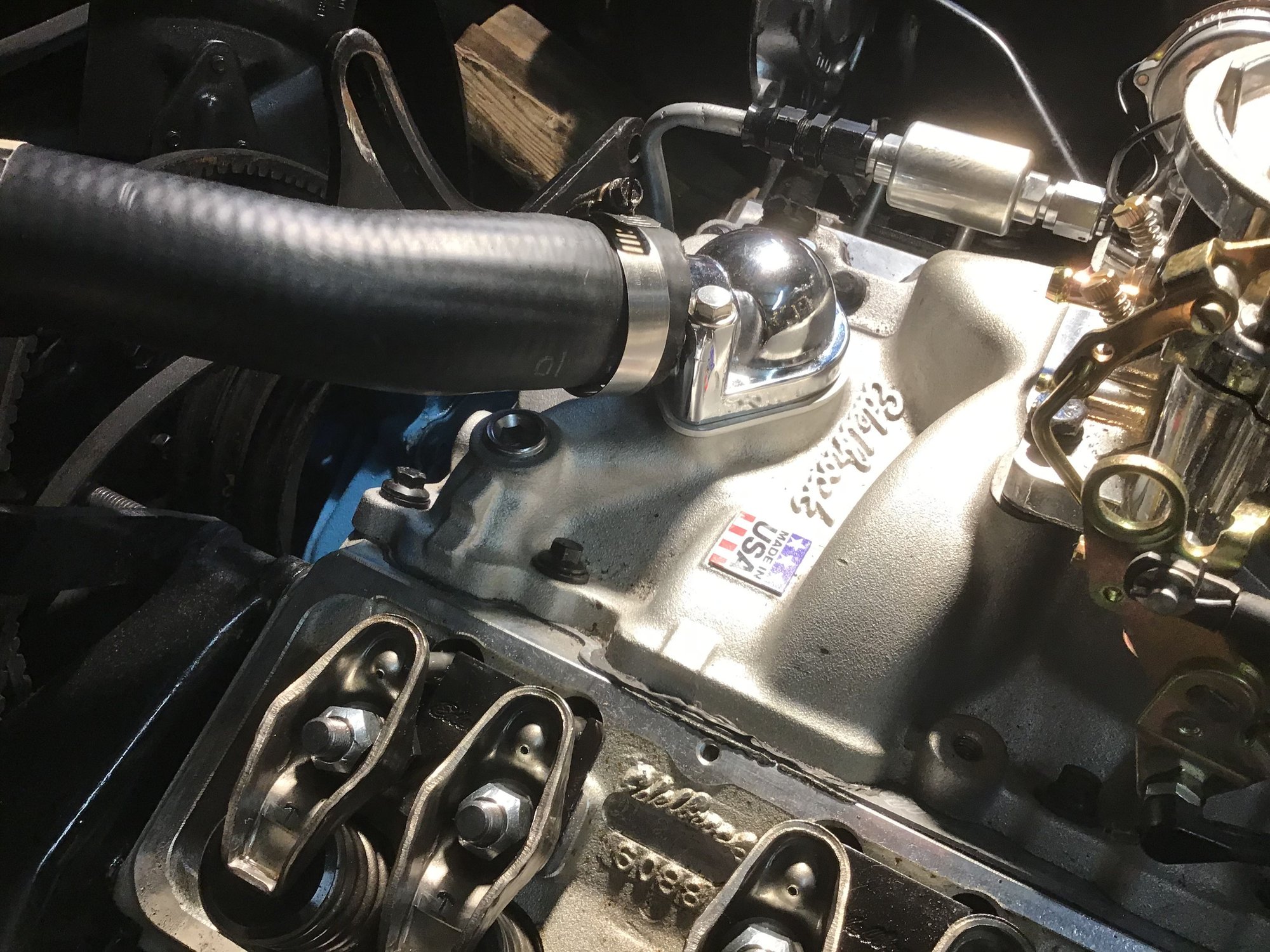

This is a new waterneck that doesn’t look like it will work,but did go to my wiring diagram and at least know what they are.

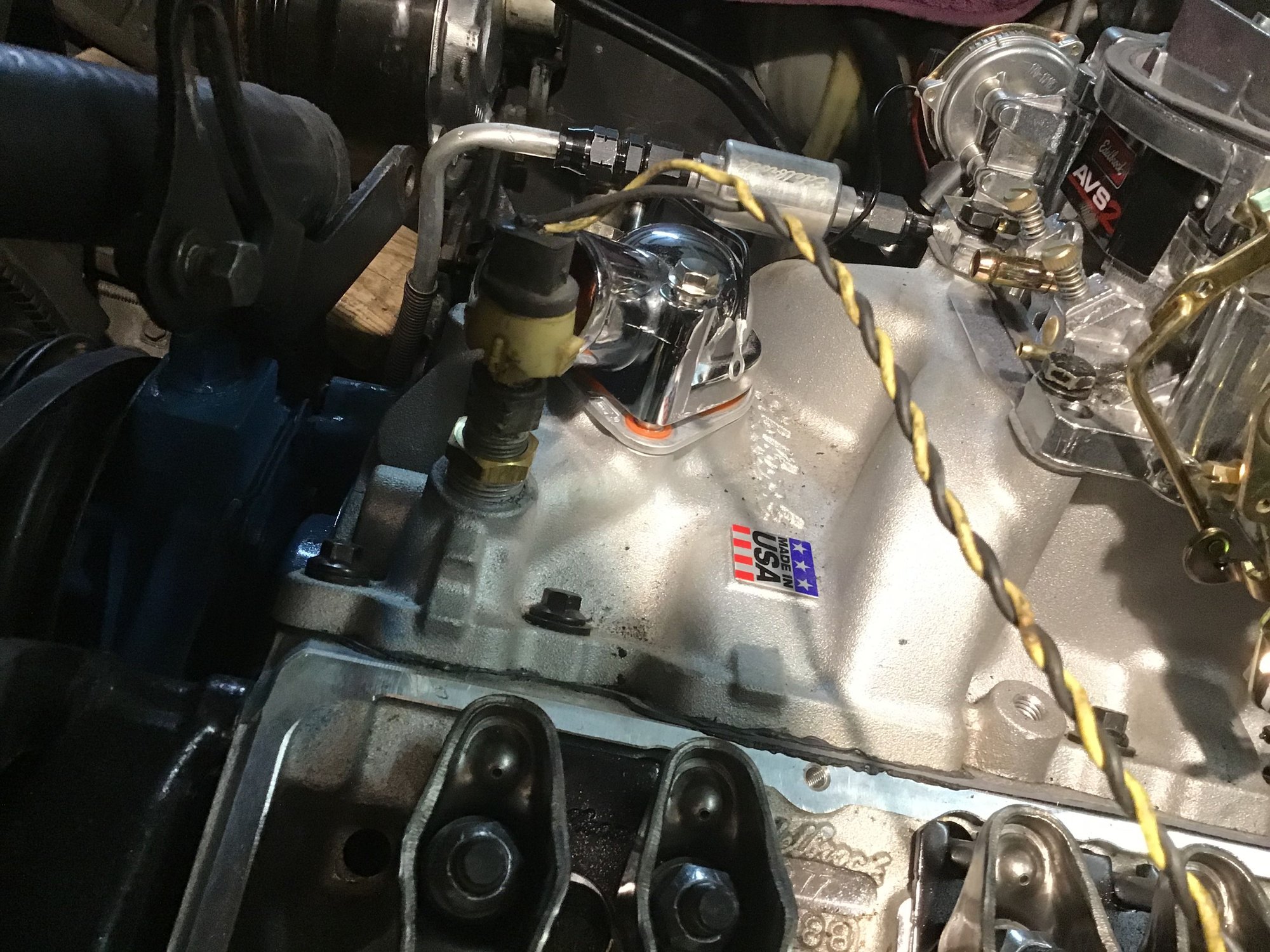

This is the one that goes to the intake,right under the upper radiator hose,but yellow and black is the Coolant Temp sensor.

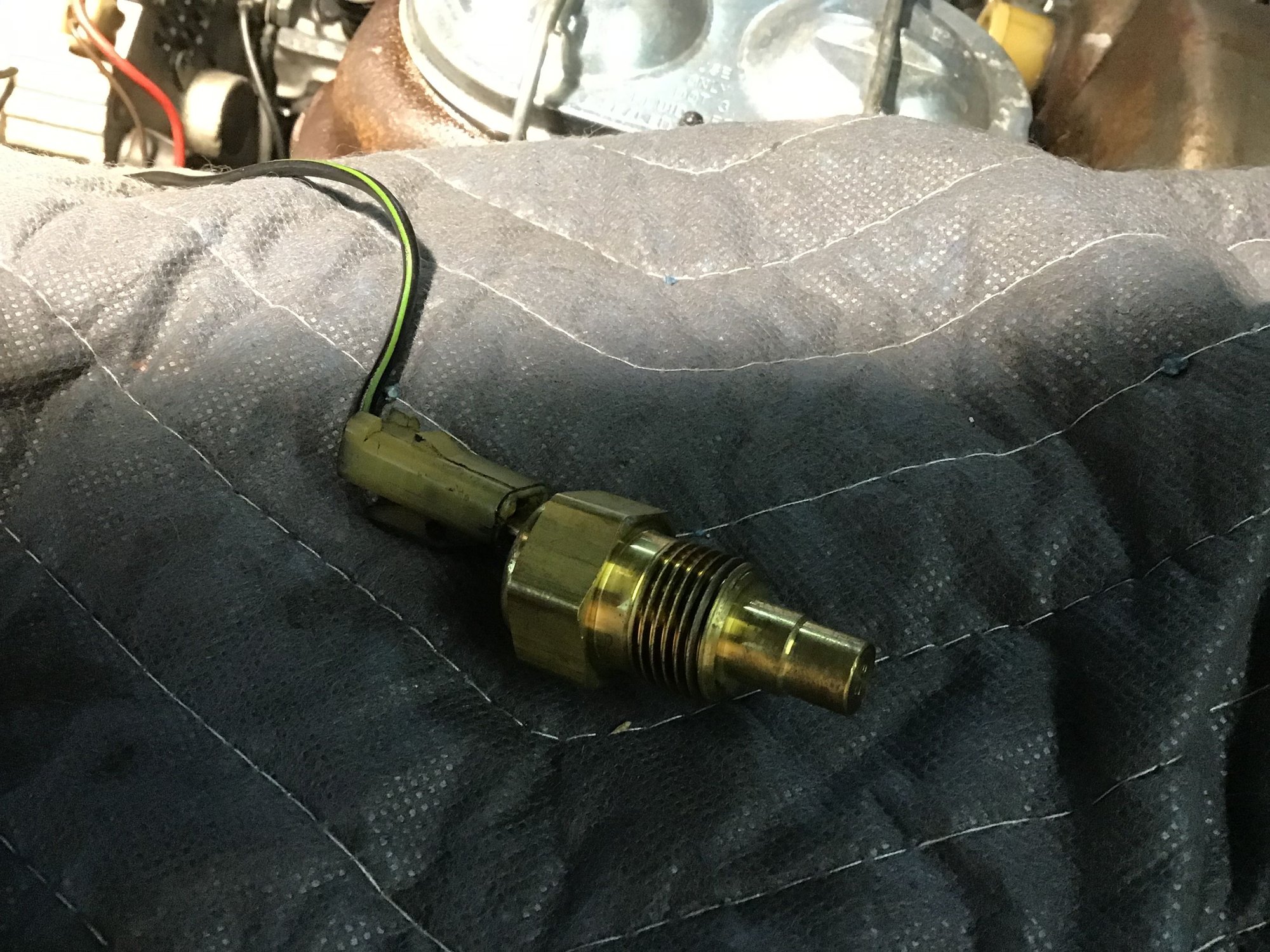

This is on the drivers side head,and is dark green and black and is temperature switch

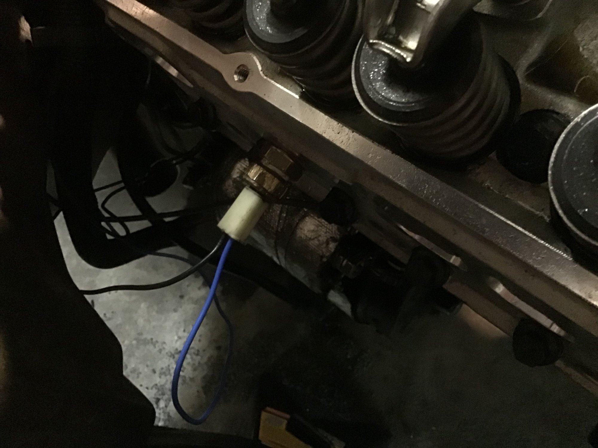

Temperature switch on drivers side has on pronge,and the passenger side head is light blue and black and it’s the engine temp switch.and it has two prongs,and it comes with the wire harness with the starter motor,which I replaced that whole harness.

And here is the Engine temperature switch,it says it’s light blue and black,lol....I wouldn’t call it light blue though,and this fits in the passenger side head.

FWIW, the passenger side head is the switch for the aux electric fan. The driver side head is the sender for the temp gauge in the cockpit. The sensor in the intake manifold, with the funny circular connector, goes to the 81 ECM. If that ECM has already been removed or bypassed, it should serve no purpose, and that hole can be plugged, or repurposed.

Thank you so much, I was curious if it had to do with the ccc ,because that particular yellow/black wire was some I disconnected from carburetor.but,thank you,a Plug looks he’ll of lot better.
