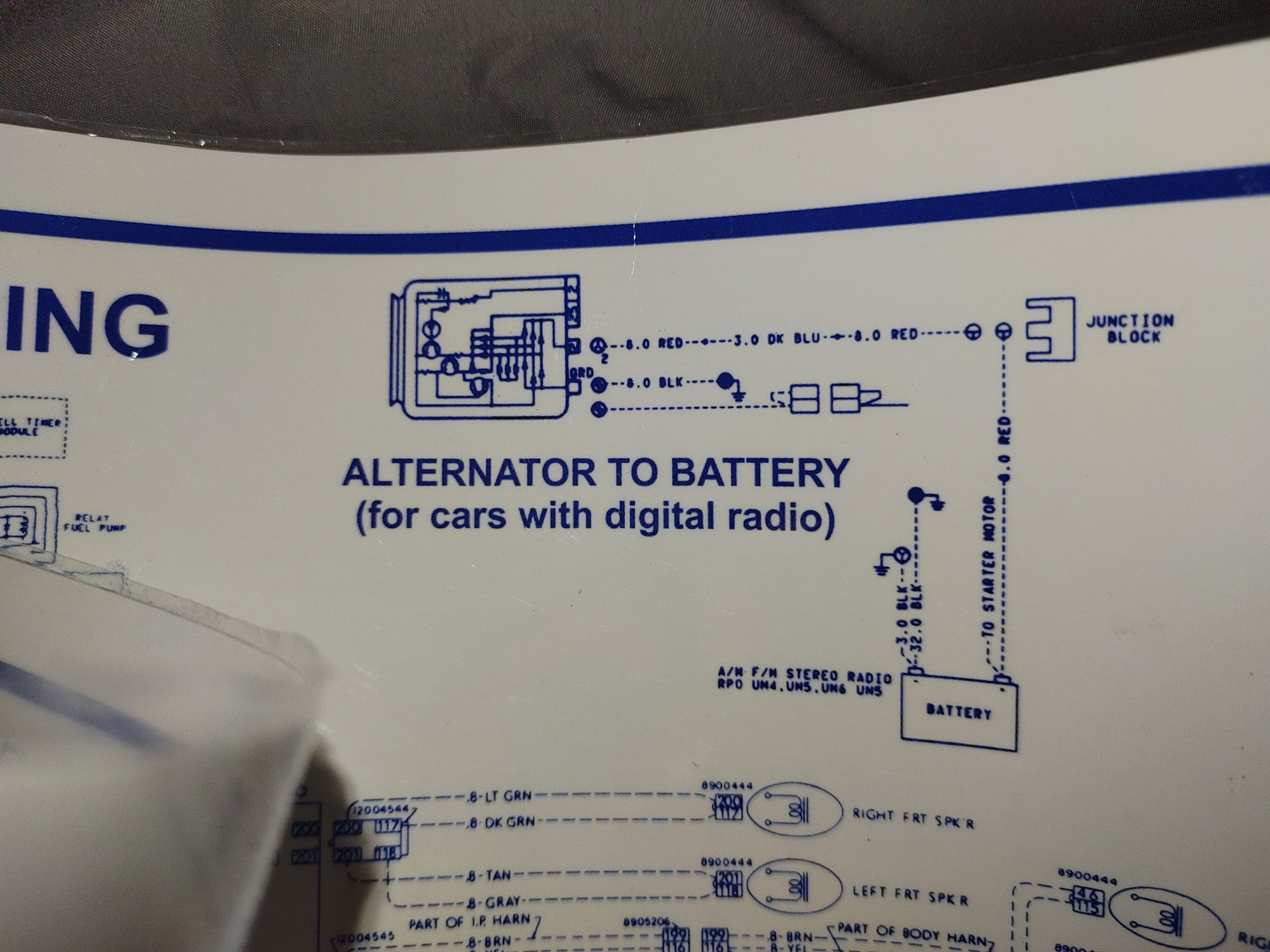

Originally Posted by Bikespace
Starting in 1980, the alternator charge lead connected directly back to the battery, so it makes sense that you have 12V at the alternator, starter, and battery.
Bike, only the cars with electronically tuned radios were wired that way.
Old Jun 29, 2022 | 08:59 AM
Bikespace's Avatar
Bikespace
Joined: Mar 2017
Posts: 11,949
Likes: 4,507
That I did not know. Do you have a reference for that? The only wiring diagrams I have handy show the wire, my 80 has it (but didn't come with the stock radio), and my assembly manual is far away.
Old Jun 29, 2022 | 09:54 AM
Fly skids up!'s Avatar
Fly skids up!
Joined: May 2021
Posts: 2,274
Likes: 1,318
From: Fleming Island, FL
This from a lectric limited wiring diagram. My 82 factory service manual doesn't even show this circuit but it's there. It's funny that the FSM does show a charging circuit for a diesel. And I thought the L-83 was the only engine available for the 82 Corvette lol.
