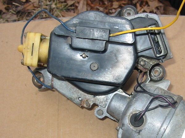

It appears your car has the washer pump with the opposing bullet connectors. I think this is your loose wire; the yellow color may be aged to an orange-y tint.
Alan '71 pic:
