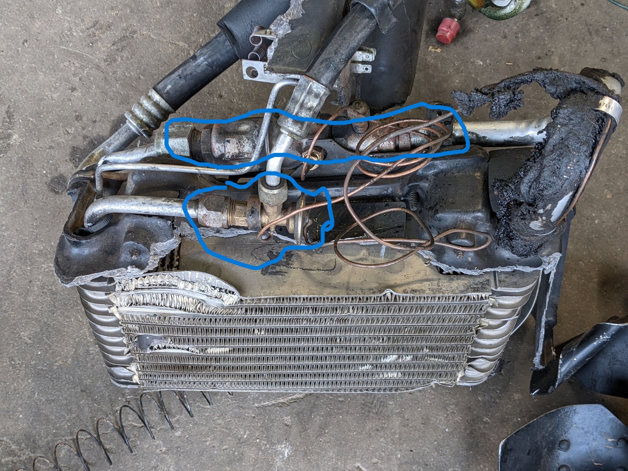

Here is a pic of a 1971 vette wreck from our shop, the top circle is the POA (pressure bypass) valve and the bottom circle is the expansion valve. (It's turned on it's side, normal up is to the right in this pic) These components are located on the left side and outside of the AC box on the car. They can both be accessed and/or replaced without opening the AC box. So I would not use later C3 parts, I would use the direct replacement POA eliminator kits) (You can see some remaining pieces of the fiberglass AC box.)
If "someone" was not able to get under 50 degree vent temps they did not do something correct. Most likely they used the 30psi pressure switch setting instead of the 21psi required for R134. That would keep the system from ever getting very cold. 2nd possibility is if it was cold when driving, but got warm in traffic or low airflow, then either the fans or the parallel condensor need to be upgraded. If the engine is not overheating the fans are not the problem, it would be the condensor. Their is NO reason for it not to be COLD if done properly. Their is zero reason to replace the evaporator radiator above, unless it is leaking. I recommend testing the system FIRST and see if it will hold vacuum for a long time.
