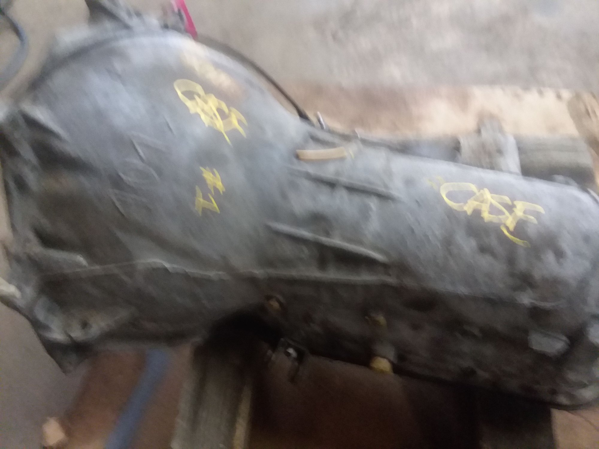

Well,the salvage yard finally called this Mourning and said they have my th200-4R transmission,and I’m assuming that they had it stored somewhere inside,looked to be in good shape,and he said that was his last one,and if I got these numbers and letters right,I think it came out of a 1985 Oldsmobile with a 307 in it,was hoping to find one a little later,but the way it looks I’m satisfied,and wished I could know the miles on it.but no way of knowing that,but from what I can see.pretty clean.will take some pictures.

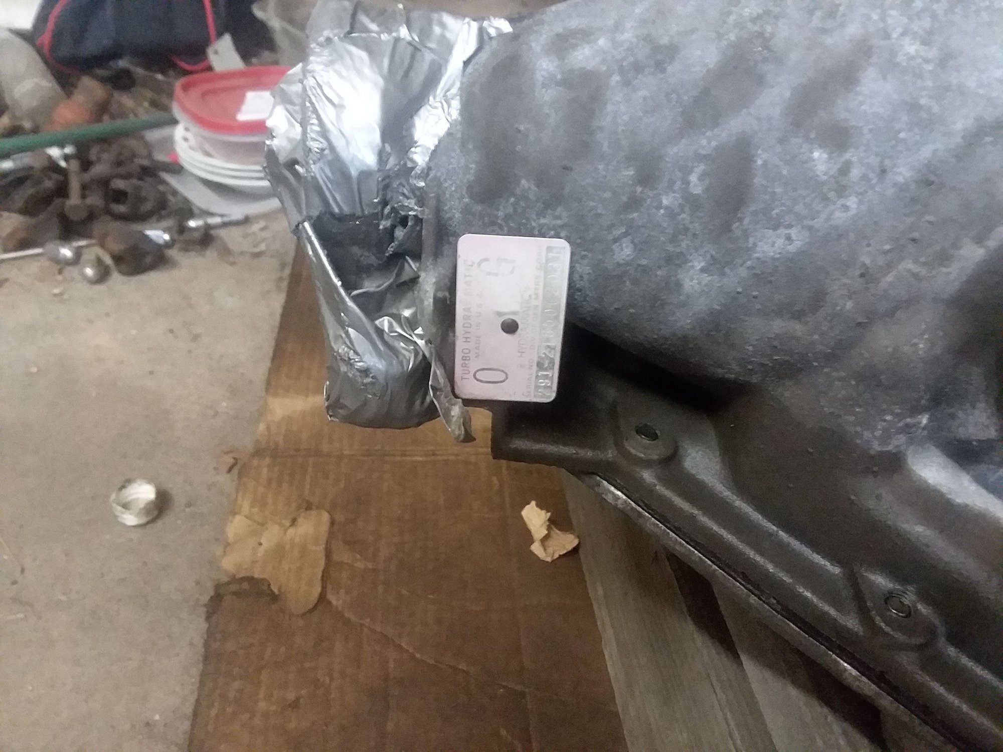

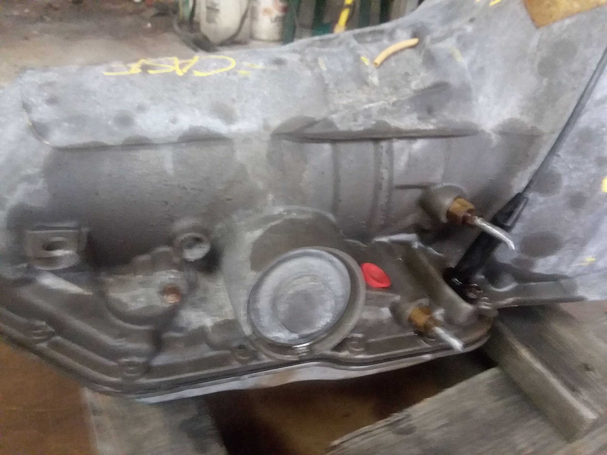

Old Jul 30, 2022 | 07:44 PM
Golferdad's Avatar
Golferdad
Joined: Feb 2022
Posts: 988
Likes: 183
From: South Carolina
Actually looks really good,pulled the pan off an still looks as if its new,and you can tell it was stored inside somewhere, so,might have got lucky wkth a good 200-4r.
Seems to have come out of 1985 oldsmobile cruiser,not sure what that is,maybe a wagon or luxury car,bot came with a 307 engine.

Motorvation's Avatar
Motorvation
Joined: Jul 2018
Posts: 331
Likes: 123
From: Sandusky, OH
Did ( overhauled) one of those, big Olds, 307 Chevy or corporate motors possible. All it really needed was the green nitrile o-ring that seals the lock up converter on the input shaft. Won’t stay locked up, in and out. Find a Superior Transmission Shift Correction Kit, works nice. Kills the Stack Shift problem these trans had. They have a high performance kit, but may be radical. 2000 to 2200 converter would be very streetable. Easy and breezy cruise machine….Buy the servo stuff if you plan on leaning on it. 2.95:1 low and 70% overdrive, perfect! Set TV with pressure gauge. Get the adapter for carb/ TV connection. A fresh filter and a can of Lubegard red. Keep us informed…..
Steve O.
