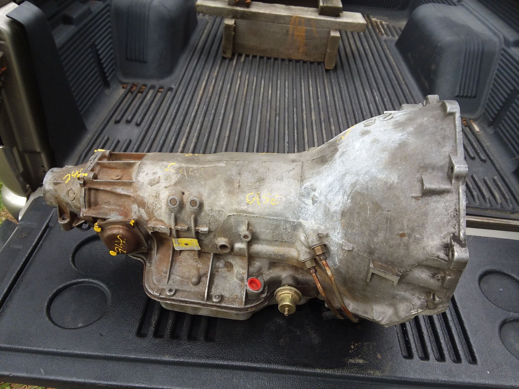

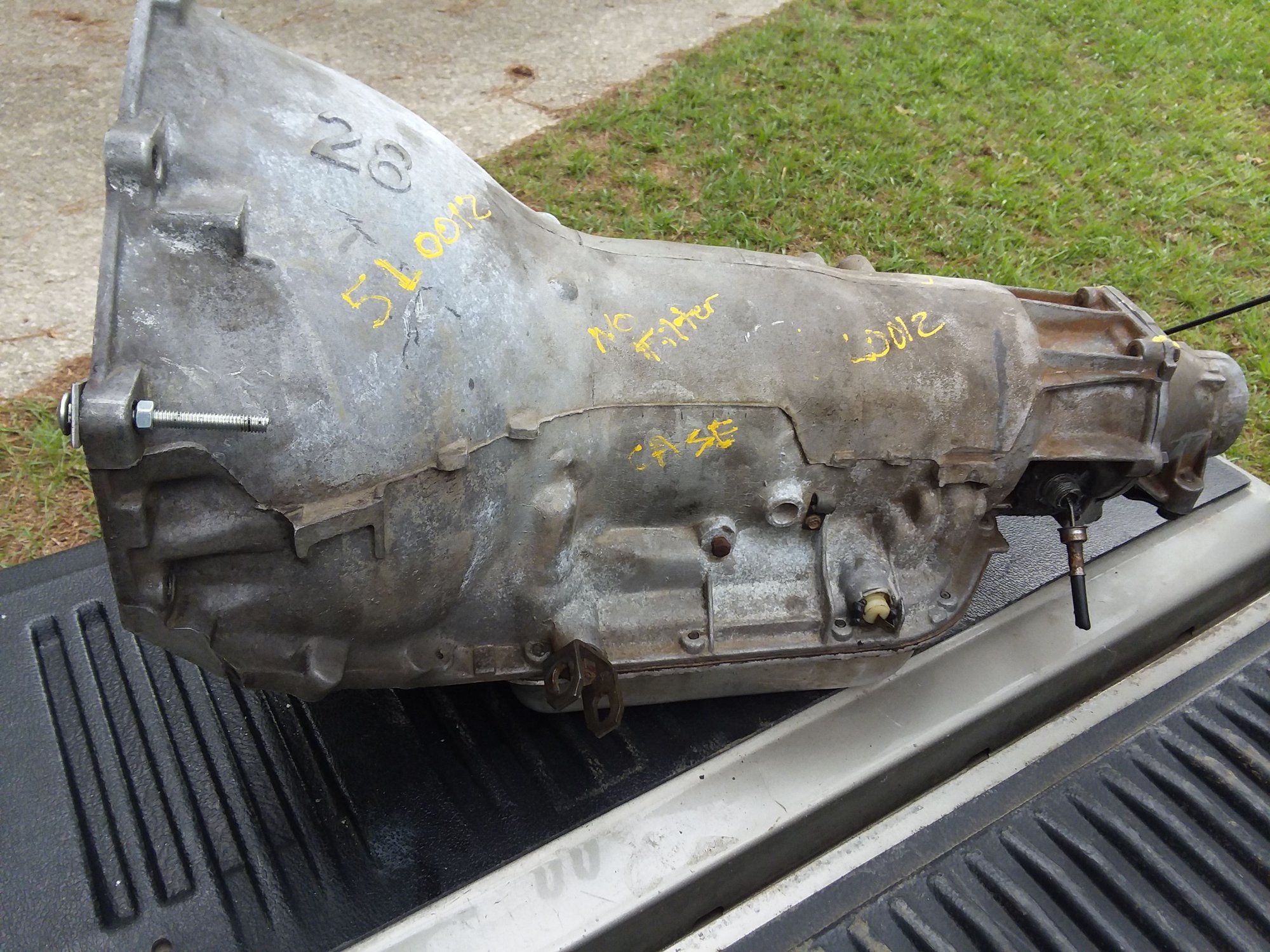

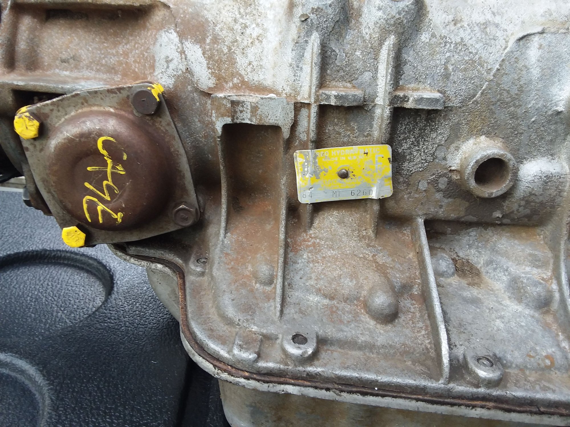

Old Jul 21, 2022 | 05:55 PM
Golferdad's Avatar
Golferdad
Joined: Feb 2022
Posts: 985
Likes: 183
From: South Carolina
I think this is it. $200 and already was pulled out.
Cant see the tag very well but it has 84 MT 6260 and has a big F at the top.
But going through the gears,I still only count 3 plus reverse,neutral and park.
Old Jul 21, 2022 | 06:26 PM
Fly skids up!'s Avatar
Fly skids up!
Joined: May 2021
Posts: 2,261
Likes: 1,304
From: Fleming Island, FL
That a turbo hydramatic 400. Definitely worth $200 but it's not what you're looking for.
Old Jul 21, 2022 | 06:55 PM
Golferdad's Avatar
Golferdad
Joined: Feb 2022
Posts: 985
Likes: 183
Yep,turned it over and it had 13 pan bolts,suppose to be 16. Now have to drive a hr and half and take it back,hopefully get the correct one,it’s a huge salvage yard.
