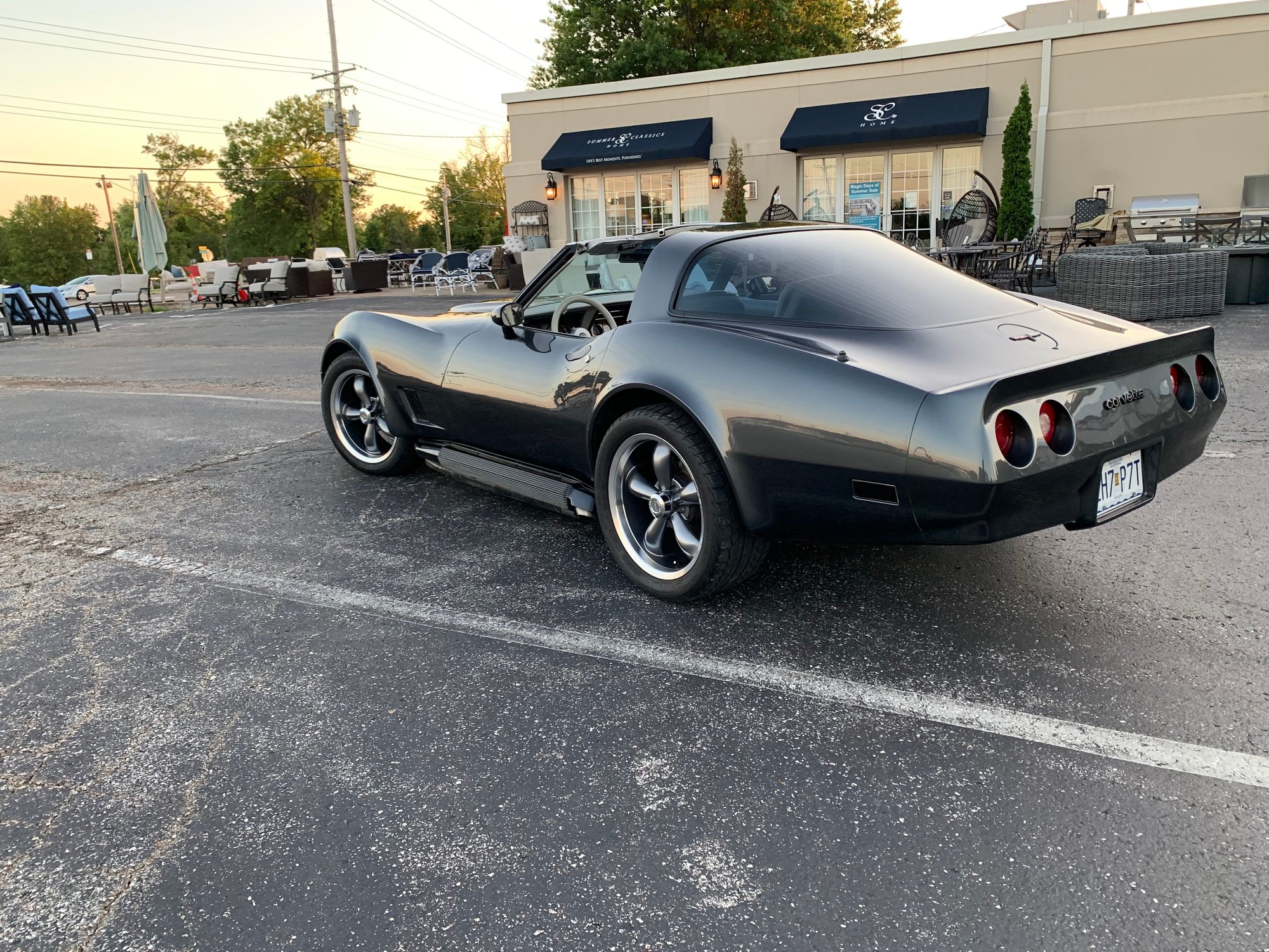

Mind sharing info on your wheels & tires? Love 'em.
Old Oct 14, 2022 | 08:45 AM
sci85's Avatar
sci85
Joined: May 2021
Posts: 225
Likes: 73
From: Missouri
Sure. I’m running Vision wheels, 18x8.5”, 4.5” backspacing. Tires are Front 235/50r18, Rear 275/40r18.
