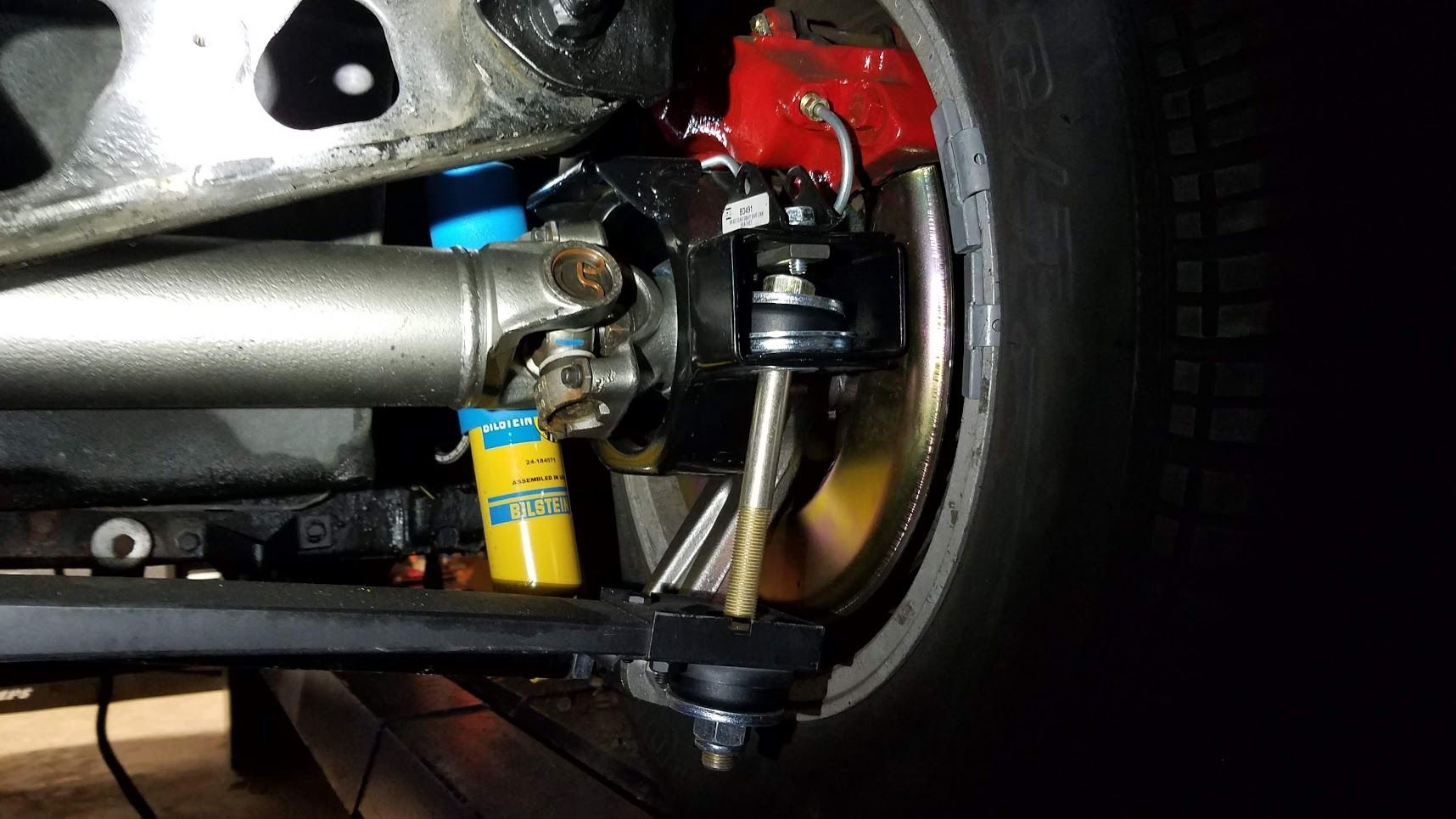

Hi all,
I have an '81 currently running a healthy LS and recently upgraded front and rear suspension components. Running 275/40R 18's in the rear. Bilstein B6/B8 combo, and moog 5758 front springs, stock rear mono leaf. Current rear ride height is 28 3/4" which I'd like to keep. I also swapped out the 2.87's for 3.73's recently.
I'm getting a lot of rear end squat and sharp bumps really upset the rear end. I've been reading through old posts but not certain where things sit with the current crop of mono leafs other than to avoid the TRW and Hyperco ones. Is Van Steel the current recommended go to mono leaf these days? Any others to consider? And what spring rate for a street driven car? I just want to firm things up a bit back there and eliminate the easy bottoming and squat under power without breaking the bank. Thanks!

By design, it does nothing for the squat. It will help with the body roll in corners, though. It depends on what you want to do with the car. Do you have an iron diff mated to the Batwing? I didn't think Gary worked on Dana diffs.
I'd look for some other examples on the Forum of folks with composite springs and your application. 9/16" may end up being just right for me. 5/8" might be better. Some folks run 3/4", which is a LOT of rear bar. Your car should have a 1 1/8" front bar already, which is a LOT of front bar.
Whatever you do, you don't want to make a car that suddenly, and surprisingly, leaves the track ***-end first.
