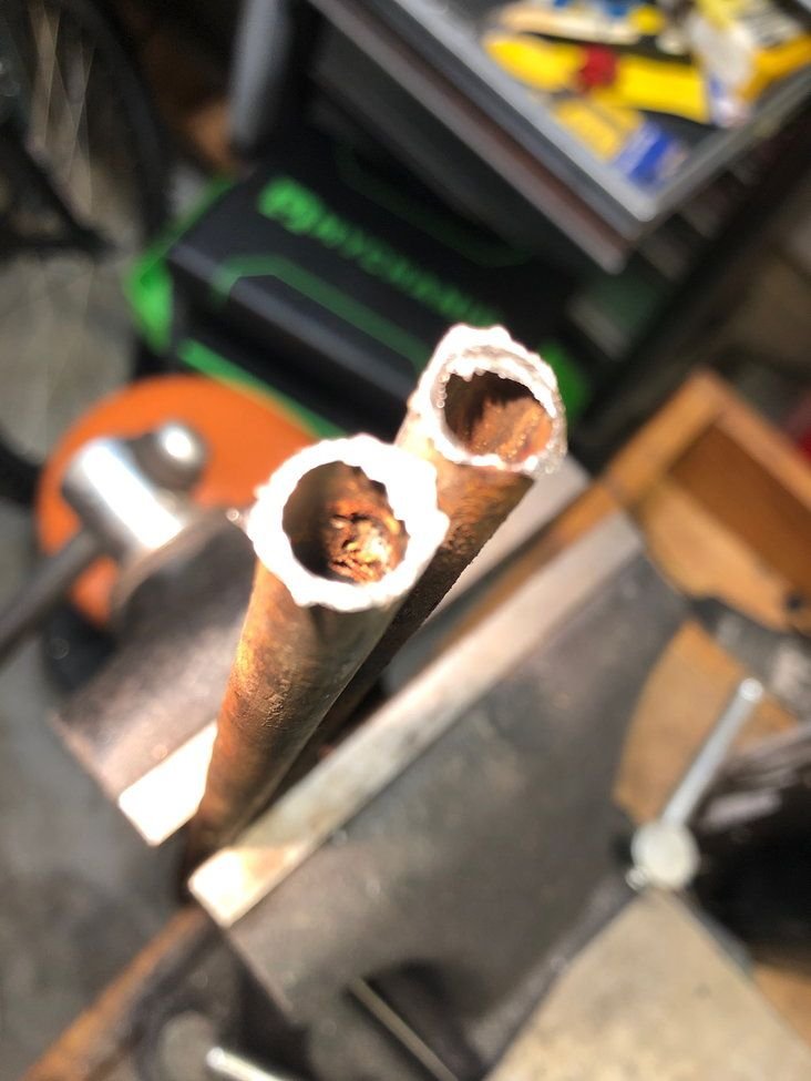

Having some fuel delivery issues with my 72. Replaced the carb, fuel pump, and checked all my vacuum lines. Car will accelerate to 35 just fine, then start to cut out around 50mph. Car hates hills over 10° and will die on them.
looks like the fuel line got kinked at the clip on the frame closest to the pump. What’s the easiest way to get the bolt off so I can fix the kink and get proper fuel delivery?

When you swapped out the pump, did you swap out the "S" hose too?
Not so sure that is a kink in the line. Looks to me like it's been rubbing a pinhole and spraying gas. Post 1, picture 1.

“S” hose replaced as well. No gas is being sprayed, I sprayed brake clean to clean off the 50 year old screw/clamp. I have confirmed multiple times now the system is not leaking at all. I also took a video of how the fuel system is working, in line fuel filter is filling up completely when car is off, drops down to 3/4 full at idle, and drops to maybe 1/4 full at full throttle, which at this point the engine starts acting up due to lack of fuel.

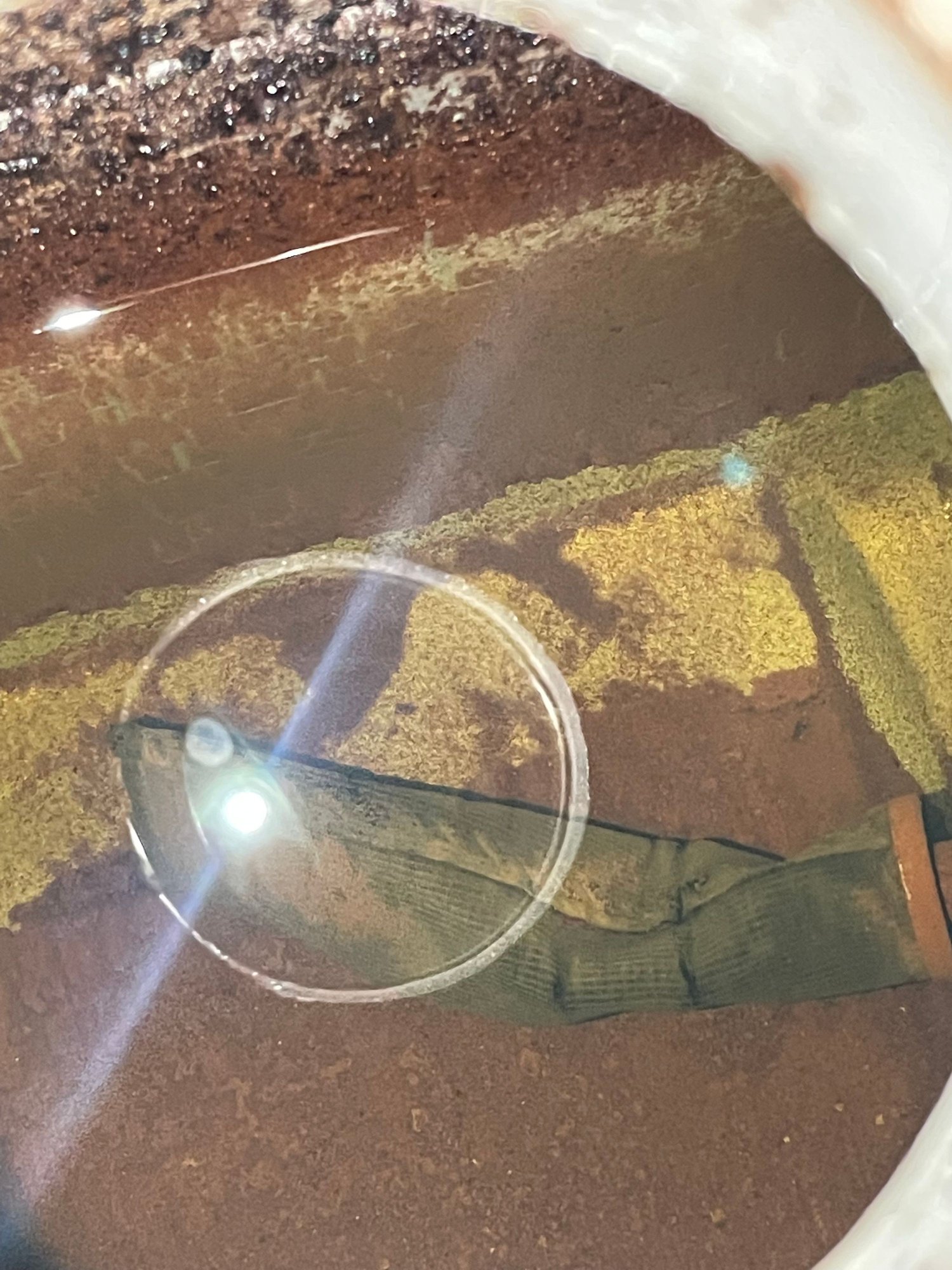

Is my fuel sock supposed to look like this?
NO, your sock looks collapsed , dirty and plugged up . It will cause a fuel restriction to carb .Also is that rust/dirt on bottom of tank ? , if so tank should be dropped and cleaned or replaced .

Agreed, inside of that tank looks absolutely horrible. And the pickup sock is totally shot. Complete flush and clean at a bare minimum. Plus if that rust has made it into your fuel feed line. Blockage could indeed be a major issue.
You can run a flexable fuel line without raising the body as I did with my EFI. but to replace those old, no doubt rusted original steel lines with replacement steel.
Yes you need to raise the body.

Took a pick tool and scraped the sock a bit, moved it around. Car now revs up to 5k before cutting out… replacing the tank next week. Ordering this weekend, guess I have another project to do!

Looking at all that rust in there. replacing that tank sounds like a good idea.
And while you have the tank out, back blow those fuel lines with compressed air. Couldn't hurt.
