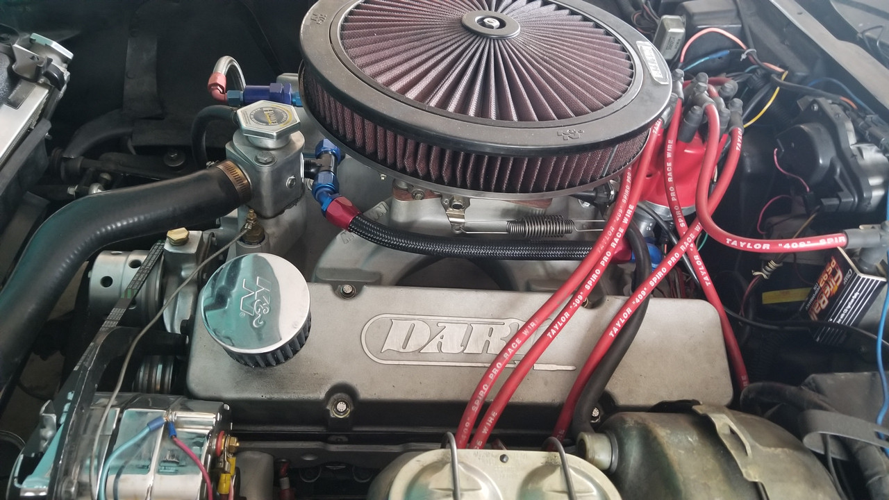

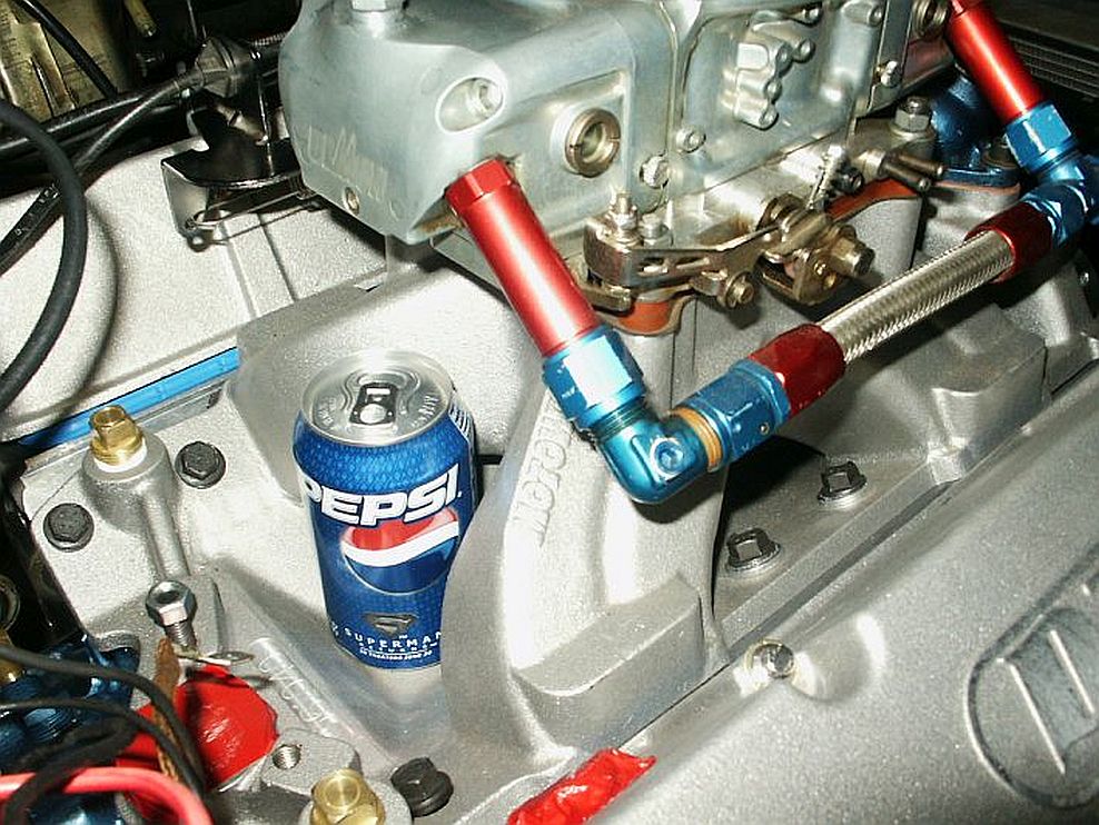

I use a really tall Motown single plane and a 1/2 inch 4 hole wood spacer. The angle that your motor installed matters. The front edge of the air cleaner is the closest point to the TT hood because the slope. I made a custom aluminum block spacer to raise the tranny tail shaft, which lowers the front edge of the air cleaner. I use a 830 cfm carb and it powers into my 7500 rpm rev limiter. My max HP is at 6800 rpm
Just taken today

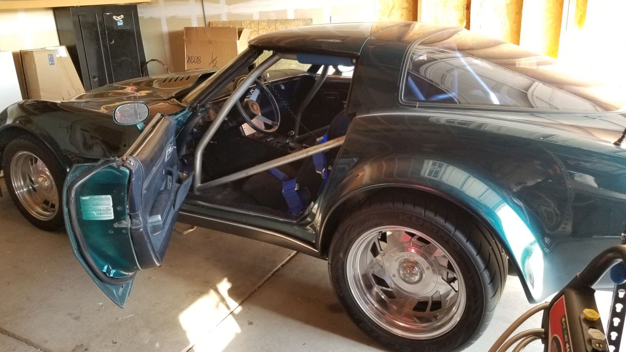

275/17 fronts with 335/17 rears. Big GT1 Wilwood road racing brakes. As I went faster with bigger motors the stock brakes with 600 degree fluid would completely fail in just a couple of laps with boiling.
The view most people see! Actually 345 width road racing slicks. 3 inch exhaust with H pipe into 3 1/2 in and 4 inch out race mufflers with 4 inch diameter chrome tips
