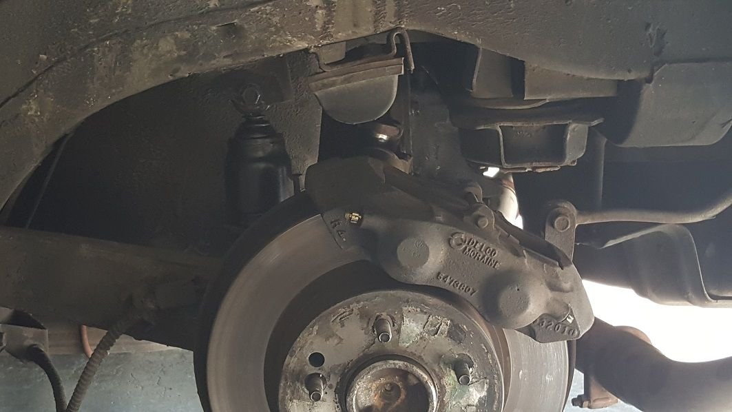

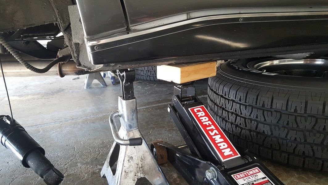

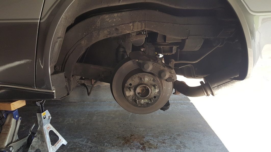

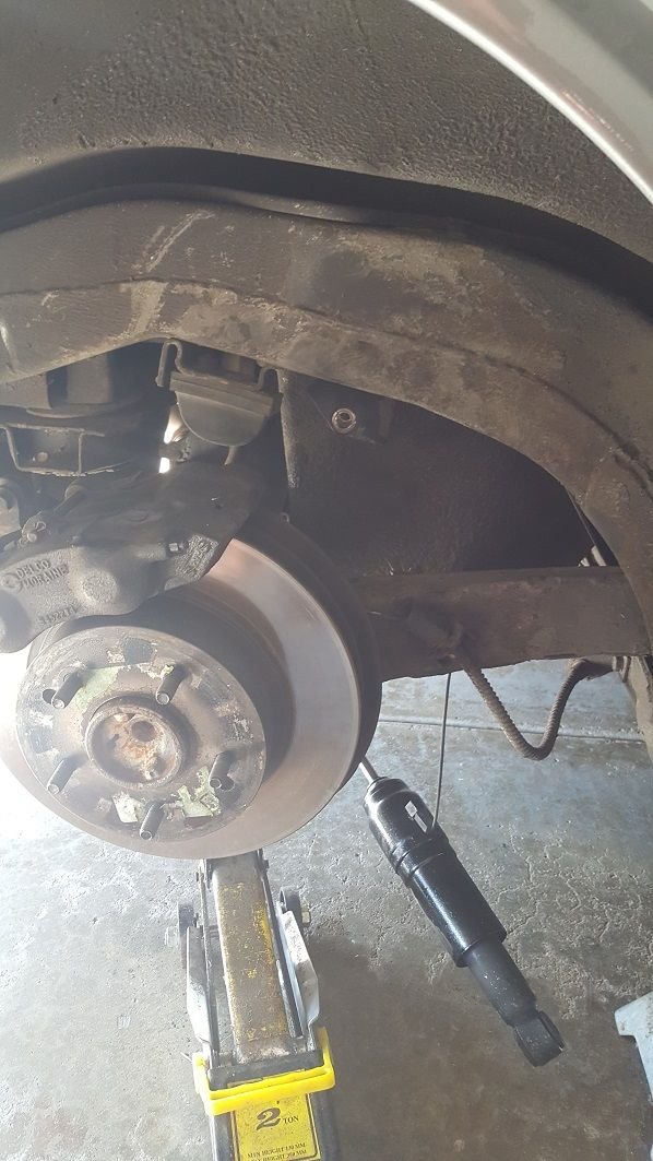

Thank you for all who helped with this. I took the morning off work to do this. It took 3 hours, 3 jacks, 4 jack stands, a few squirts of PB but not for rust, and a 2 lb. persuader.
The front left fell off the jack 2x's while getting it up. I finally moved it and threw caution to the wind on lifting it. I just wanted to make sure the jack stands were in the right place. I kept everything closed, locked, latched, etc. and had no issues. The hardest parts were the bolts on the top, getting them out and putting back in. Locally I was being quoted $450-ish to have a mechanic do the job. I spent $55 on the KYB Excel-G's through Walmart and borrowed 1 jack and the PB from a neighbor. Would I do it again? No, not without a real lift or 4 jacks that I could leave in place and forget about the jack stands except to have them in place for backup (safety). Without a proper lift, I'd rather take the grief and aggravation from the wife and pay a mechanic to do it.

very nice and clean car!!! well done..
i justified my Quickjack with outside costs.. so in your case.. 2x shock replacments from a mechanic pays for a Quickjack and you don't risk that nice car let alone your body
it is shocking what can be done with one.. let alone other cars..

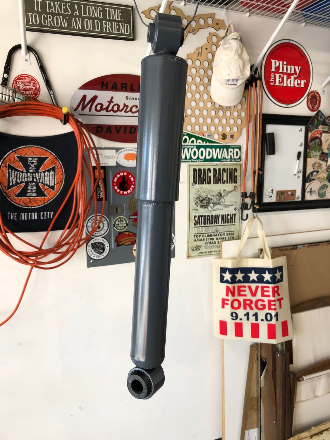

Yeah, just a little lol. So I went with the KYB Excel-G after watching a YouTube video where a guy had the KYB Gas A-just on his late 60's early 70's Mustang and went to the Excel-G's for a better ride. So far I like them. Very smooth and not too mushy. Closer to stock but better, and that's what I was looking for. The only problem I have now (as before) is the rear ride height is about 3/4" lower than the front. I'm planning on changing out the leaf spring bushings (not the spring or hardware) over the winter and I hope that will get me to where I want to be. I really don't want to mess with the front end although an inch lower would look nice...
