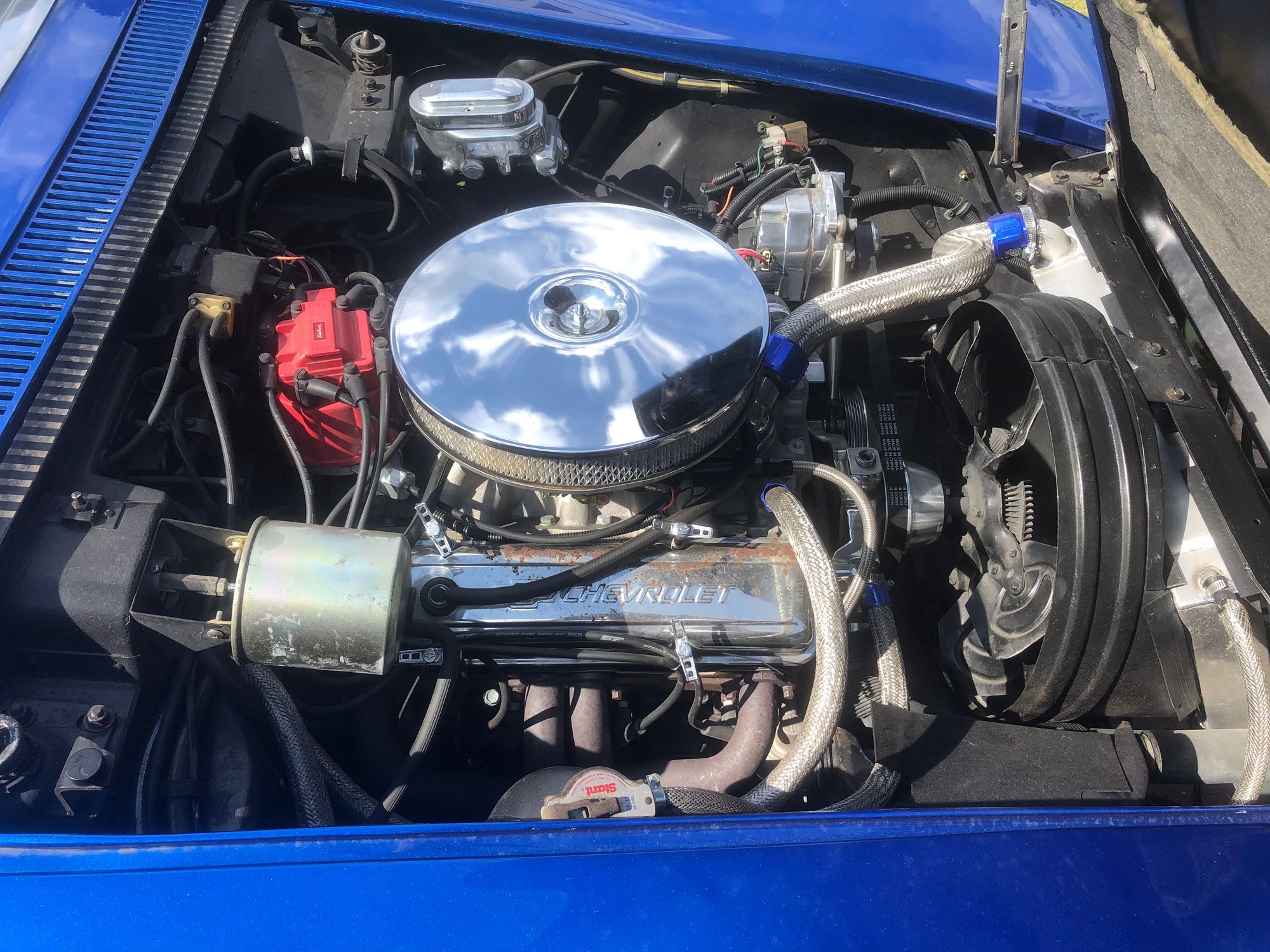

In my new 69 vert, i guess its not matching and it will be probably some crate engine, number on psg side is 1M0425 and under it 30VP..
many thanks for info!:-)
Belt is squeeking loud even it looks new snd very tight:-(

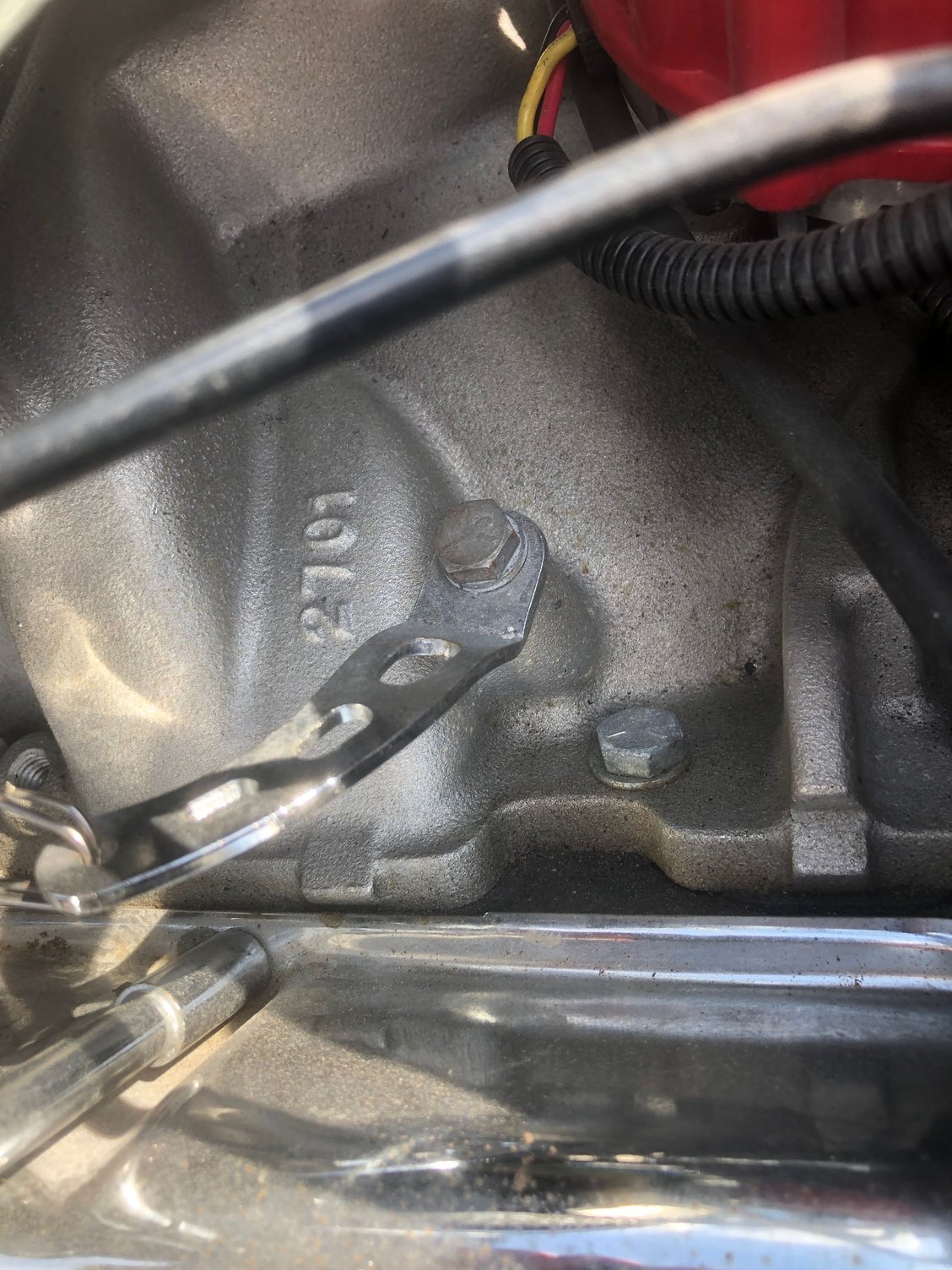

Look at these areas in the photo as reference to your engine and then do a google search. You’ll find everything you want to know about your engine.

Im probably completely dumb, but did not find anything (any different number on engine or anything related to the number ive found before..).

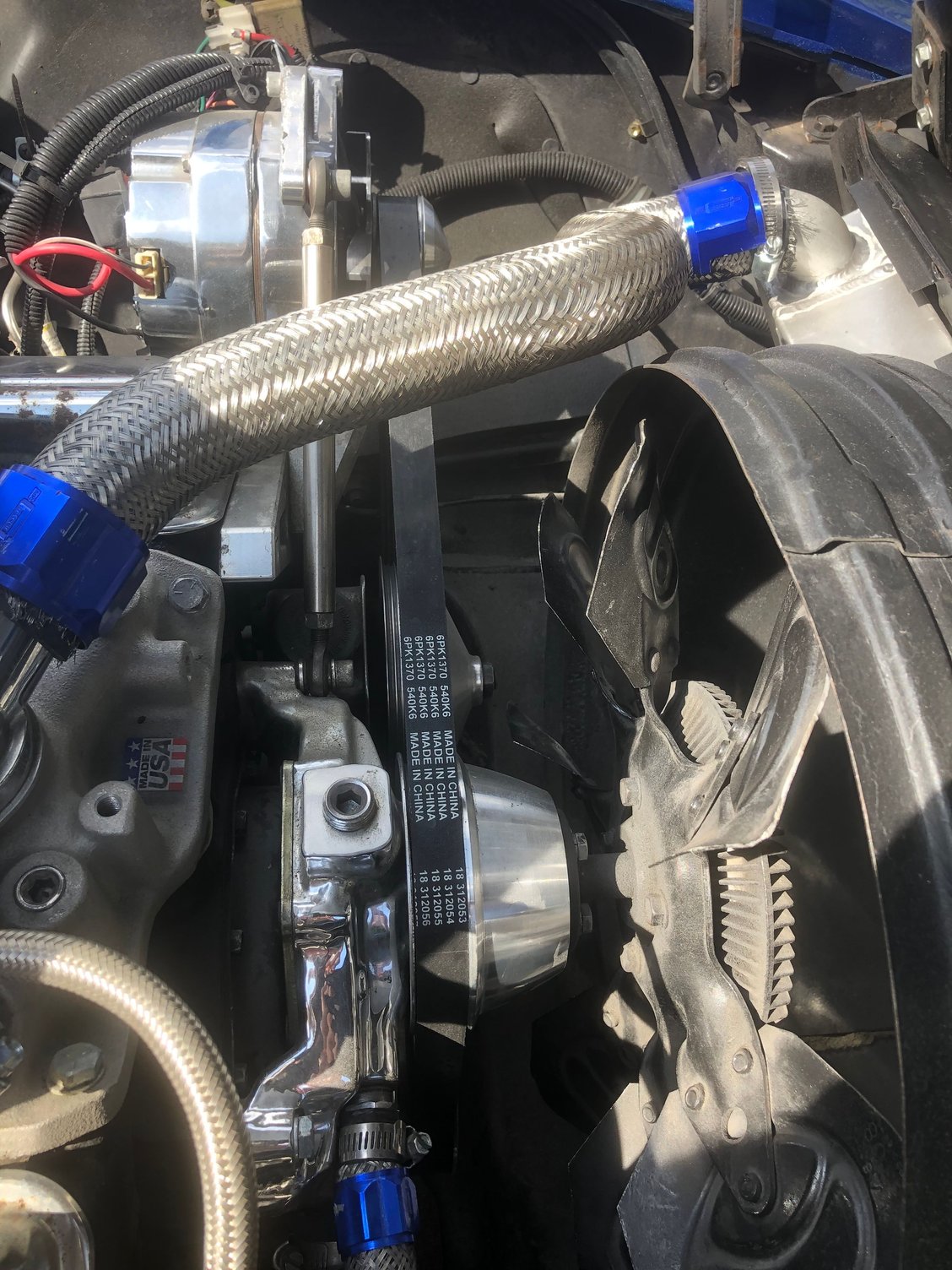

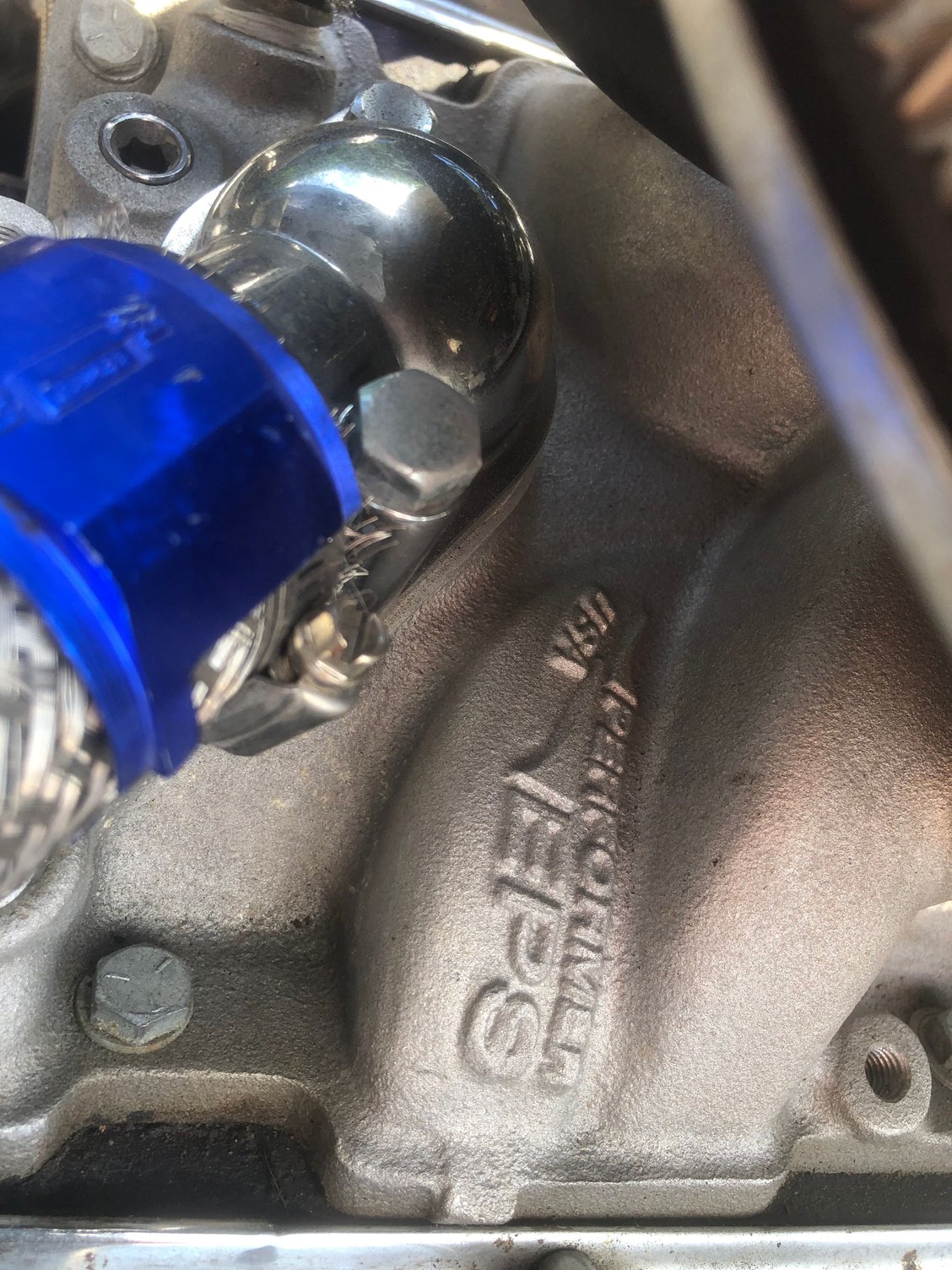

None of your photos show the ID pad, the casting number, or the casting date of the block or the heads. Without that info, ID is not possible. Photos of your aftermarket water pump and your Edelbrock intake manifold are meaningless in identifying the engine block or heads.

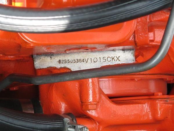

There's no photo of your ID pad in the photos you posted - you have photos of your intake manifold, air cleaner, water pump, and valve covers, which provide no useful info. The ID pad is easily accessible on your engine since you have no air conditioning. Here is a photo of a Chevy ID pad - you can easily provide the same type of photo. Your casting numbers and casting dates are also easily accessible if you take the time to shoot them as Jeremy showed you above:

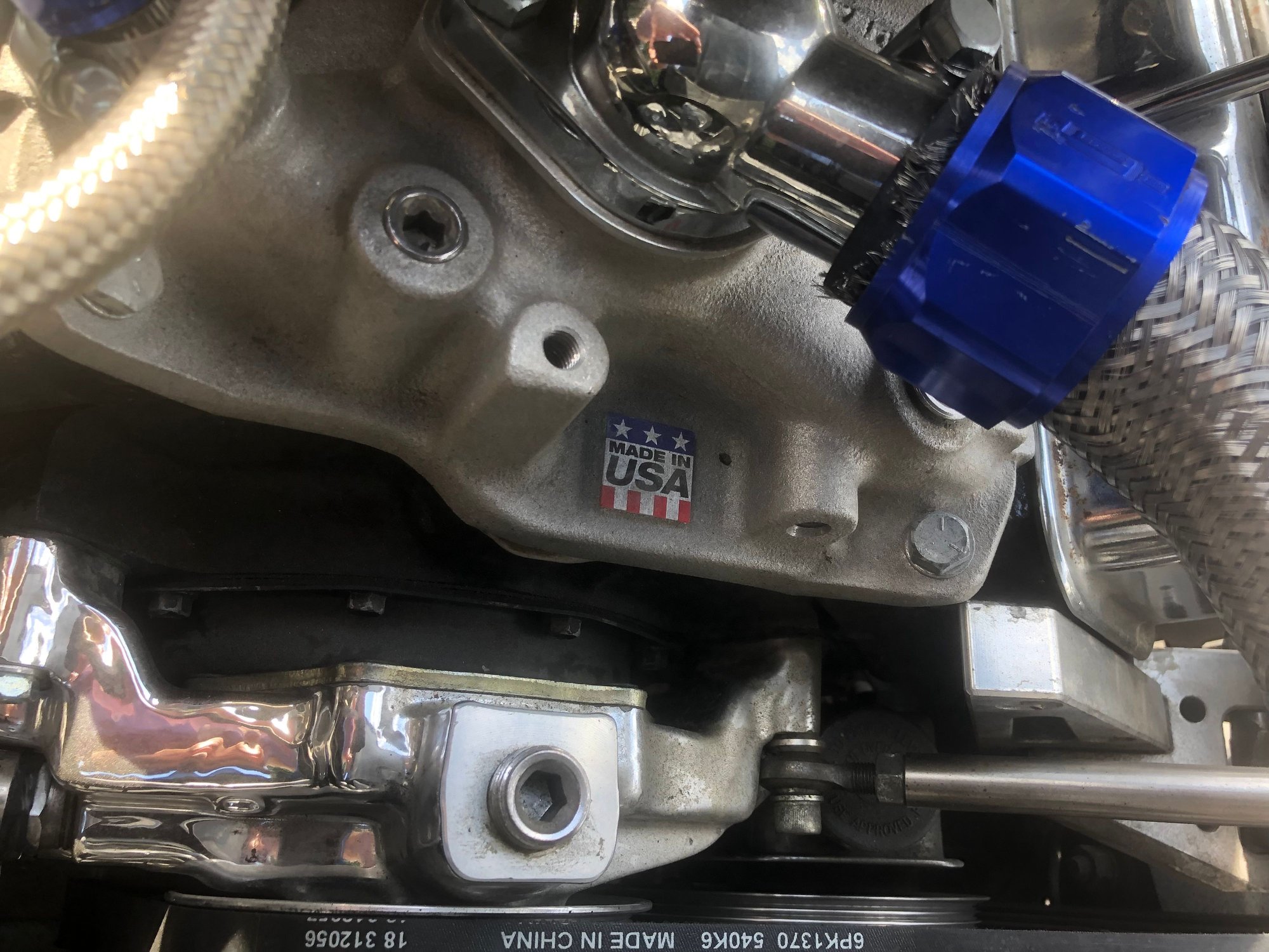

we do not recognize those numbers. look at pic lars posted. flat pad. directly in front of right head. and behind water pump. if nothing there at all, it has been decked. which means it has been rebuilt. which means whatever it left the factory as is moot. post a pic of the pad. your first pic shows some of the pad. i believe this is 77-later by the tiny bit of the pad i can see. it ends at the water pump bolt.

I see lots of aftermarket bolt ons and I can tell its a small block chevy but without the numbers stamped on the engine block that all I can tell... and even with those numbers, you cant tell if its a 355 ,383 or whats been done to the block if rebuilt which is likely if its a crate motor. The numbers on my block for example say its a 1976 4 bolt 350 from a c20 truck... They dont reflect the fact that its been rebuilt with flat top pistons, a performance roller cam and 64cc heads... just saying.
