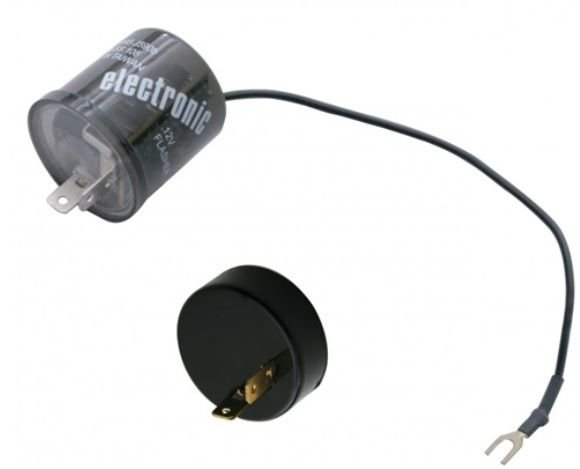

I have switched over to led lights on the exterior. turn signals do not blink. i installed the led blinker relays provided by superbright led but no blink, solid light. then purchased an after market led relay, no blink, solid light. i reinstalled one regular bulb on each side using a regular relay and they blink. I am looking for some advice on what led relay people have had success, or whatever other advice you have. regards Atlanta

You will need this flasher or an equivalent other brand. The black wire connects to any ground.
You will have to check the flasher connector on the wiring harness. You may have to reverse the terminals. Electronic flashers are polarity sensitive. That takes all of 5 minutes. There are polarity reversing adapters if you don't want to do that. If you swap terminals and want to go back to a thermal flasher, you can leave them swapped.
https://ceclighting.com/products/fla...PartNum=EF32RL

What Avispa said, the electronic flasher relays are polarity sensitive, temporarily switch the leads on your flasher relay with alligator clip jumper leads to test.

Or just look at the connector. Brown goes to X terminal on the e flasher, purple to the L terminal. 68s might have a different wire color setup. The terminal that gets 12 v with the key in ON or ACC goes to X.

Is it a three wire relay? Try leaving the ground lead, and swapping the other leads (you can make two short jumpers, or use alligator clips to test).
I used this United Pacific flasher. If you order the one with the swappable base, it's easy to switch the leads. I think I used the swap in one of the two positions of my 79, perhaps just the turn signals, but not the hazards. At any rate, it did NOT work without swapping the base leads. I don't know if this fits your 68, though.

tried the union pacific relay and no joy, tried several others with same problem. used the polarity reverse plug that came with the union pacific on another relay and Bam... I am in business.. thanks for the responses. Atlanta

Finally got around to converting my 72 C3 to LED. Same issue with blinkers. By reversing the leads with a pair of jumpers on the blinker, solved the problem. Big thanks to Bikespace for this infor.
