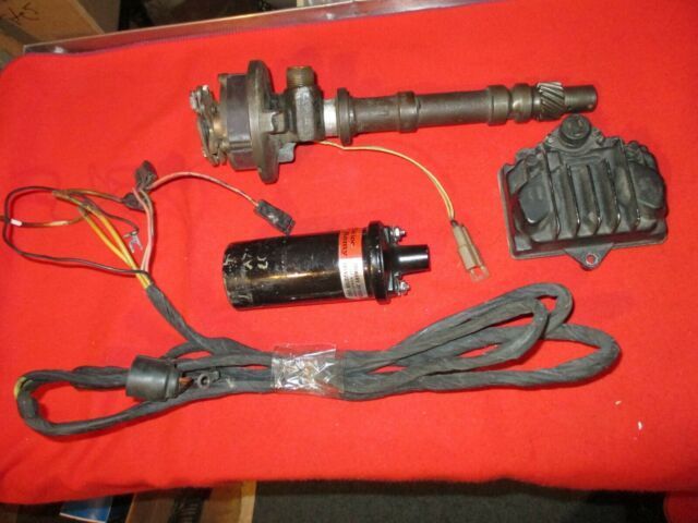

can you post a pick of the distributor with the cap off and the box you are talking about, If its an original l points distributor you need to set those. If its a transistorized dizzy you need to address that. If you have spark at the coil and none at the plugs, its internal to the dizzy

Yeah I'm pretty sure that's it. Has the small box towards the front driver side of the car?
I can post the pic tomorrow morning before I leave for work. It was def the TI box. I think they just bypassed it by taking that wiring out of the equation. Right now it's just a regular distributor with the 1 wire running to the neg side of the coil and the 1 resistor wire running to the positive side of the coil.
But yeah, voltage and spark at the coil/wire coming off the coil to the top of the distributor and if I move my timing light to any of the cylinder wires I have nothing on any of the wires.

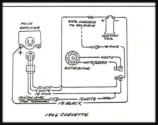

Yeah I found out I had the TI system when I was going through the harness and found that pink wire essentially going to nothing, so I started a thread about it. That harness is still in the car.

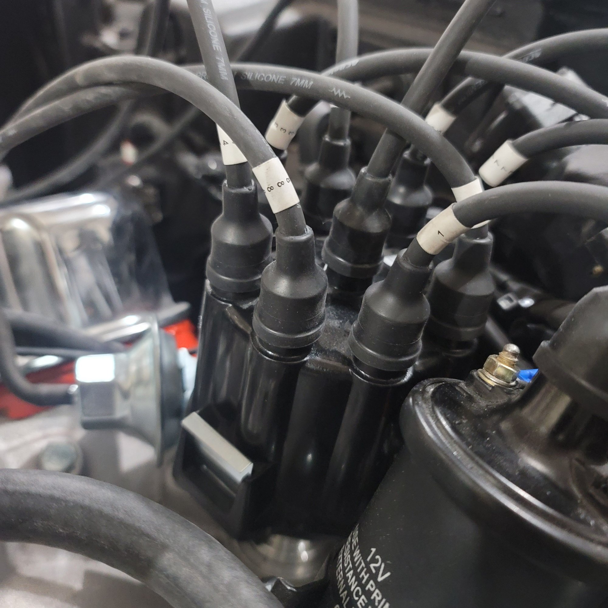

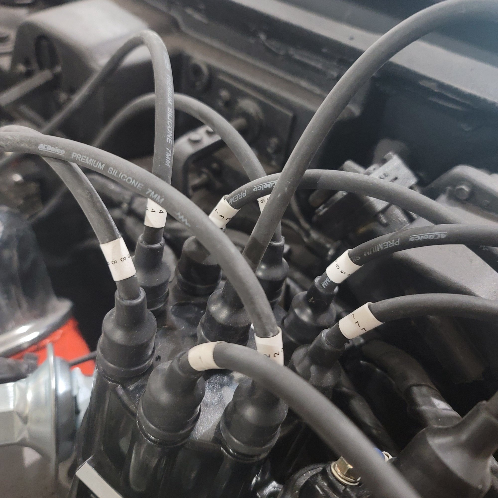

Not sure what you were specifically looking for on the distributor, but here's a quick picture I snapped. I can take the rotor off if needed.

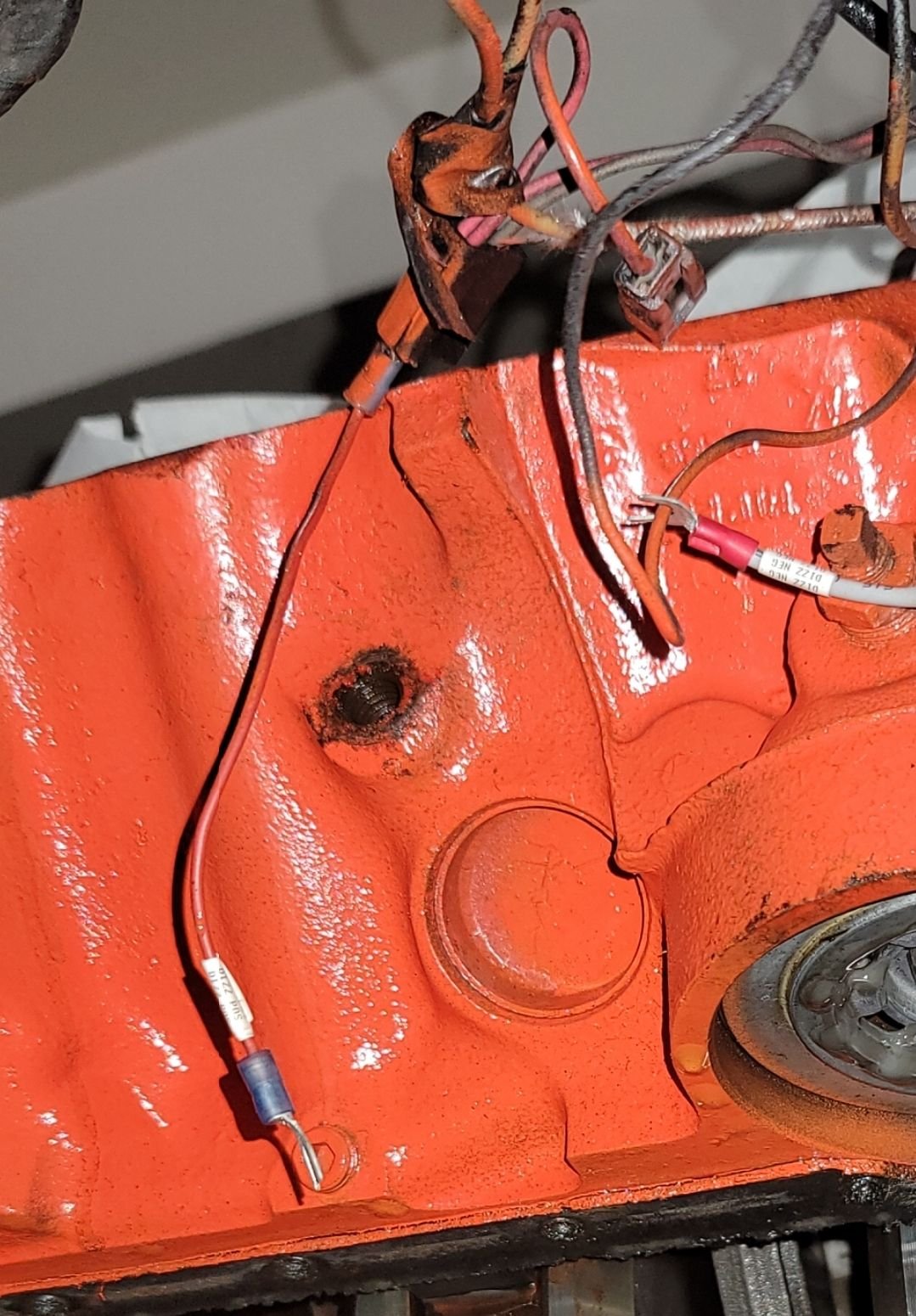

Edit: I found this random picture of when I was disassembling the car. I was labeling where all the wires went and I put that this random jumper was on the + of the coil. Looks like he had it spade plugged into the pink wire on the connector, which is probably what I'm missing and what confused me about the wiring in the 1st place. I don't think I put that back

You have to set the points gap to get it to work. You might also need 2 wires going to the positive side of the coil. If the system was stock you would have a white and a yellow. One has power on crank and the other in run.
Look up how to set your points
