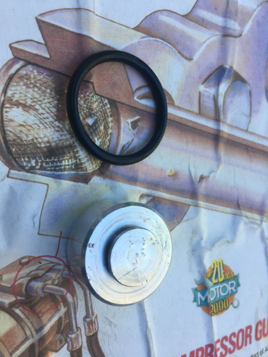

ACDelco AC compressor leaking from snap ring retained metal cap on back; red dye in picture. Last month someone had the same problem; fixed with new O-ring under cap. Looks like it will need to have r12 evacuated to repair. Anybody surmise how much oil to add when recharging? It leaked enough to get a couple of fluorescent spots on the floor.

My O-ring assortment didn’t have a match to the one removed. Two auto supply stores, Baxter and NAPA, didn’t have a match either. The existing O-ring looked good-as-new, so I coated it with Nylog Red and put it back in. Held pressure with Nitrogen at 120psi and vacuum for hours. Several road tests over the past week and no leaks.
The aluminum plug and O-ring don’t fit very tightly and held in by the snap ring don’t make the best seal. Poor engineering fix for those that don’t need this orifice.
Lesson learned; if a part comes with extra ports you are not going to use, don’t count on the factory having sealed them properly. Nylog Red was used on every AC connection except this one; it was the only one that leaked. And resulted in a lot of work and material to get one O-ring sealed.

thank you for update!
and possible fix..
i thought they would put a green one in there
