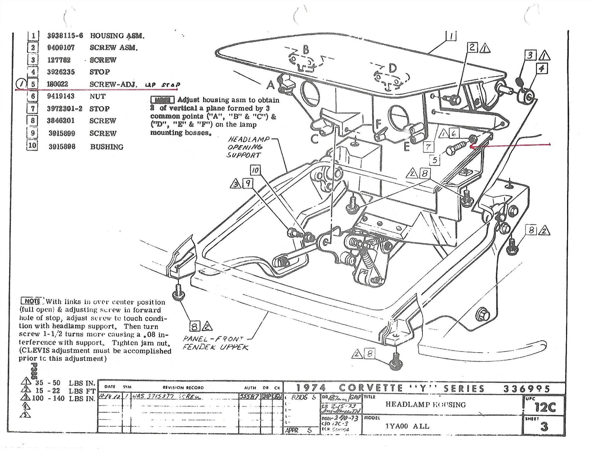

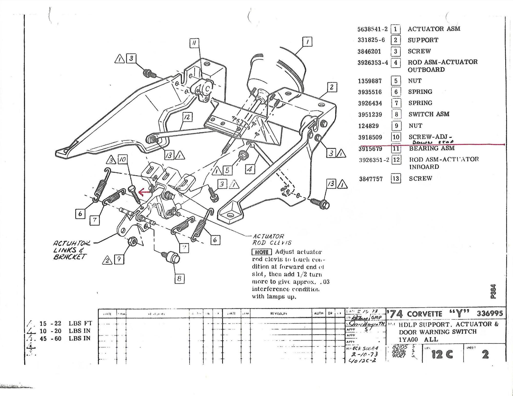

There is an 'up-stop' and a 'down-stop' have you tried adjusting those?

I only found the stops that go on the outside of the headlights. I adjusted those. The adjustment didn’t effect the movement of the left assembly. So I’m thinking some type of bushing may be worn.
