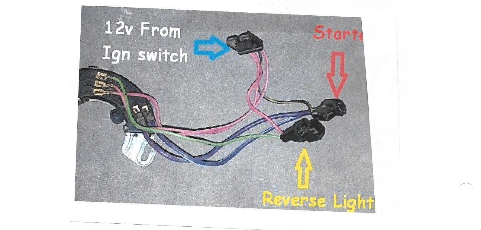

With the car in Park and the parking brakes on, See if the starter is working by jumpering the Main battery cable to the 'S' terminal.
Next check that the NNS is working, here's how:

It finally quit working all together. I disconnected the battery, hooked the wire up as recommended and reconnected the battery cable. Once I touched the battery with the jumper wire, the starter engaged. Then I tried the key, and it energized the starter as well. I do not think the seat switches are hooked up because I turned the key w/o sitting in the seat when the starter engaged.
I will try the NSS next (I haven't had the car long and I want to get some quality seat time in before it goes away for the winter). The horn doesn't work, so I'd like to fix that while I'm in there as well.
