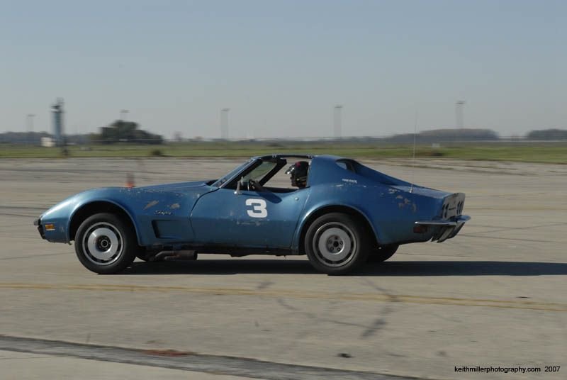

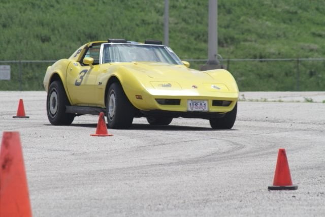

I've got both a 73 and a 76 that have been campaigned in autocrosses for quite a few years. Both cars are very similarly prepared. I've won a NCCC Indiana region championship in both cars.
Both cars are setup for running in NCCC class 2 D. In that class small suspension mods, updating/backdating on motor parts, headers, and wheel/tire changes are allowed.
Both cars Front: 1 1/8" sway bar, 550lb springs, KYB gas adjust shocks.
73 Rear: 420lb VBP fiberglass spring, KYB gas adjust shocks, 1/2" sway bar
76 Rear: 360lb VBP fiberglass spring, KYB gas adjust shocks, 3/4" sway bar
Both have hooker side pipes, '71 heads, aluminum '80 L-82 intake and the longer spring bolts in the rear. I've run anything from a 15x8 to a 18x9.5 on the cars using adapters. Here you can see the 76 with both 18x9.5 C5 wheels and 16x9.5 C4 wheels.
As far as car mods go, tires will make the biggest difference in handling and lap times. Shocks, springs and sway bars will make the second biggest. But above all else, your driving will be the biggest difference. More experience and learning the car and learning good driving habits will create faster lap times. When I started racing at 16yo, I was Definity not fast. It too quite a few years before I was in the hunt for class wins. Learning from my dad and other corvette racing friends and keep pushing myself is what got me there. Don't judge your self too harshly against other people. Race against yourself and keep improving. Eventually if you keep improving, you will end up with the faster guys.
This is the 73 on power going through a fast left-hand turn so that is why there is so much gap on the left front.
