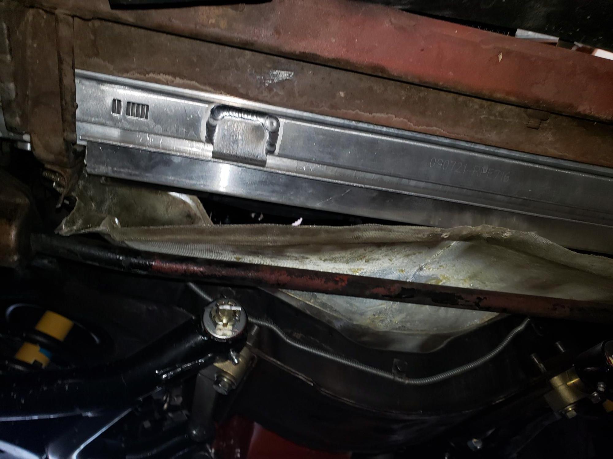

My newly built engine runs hot! I’m guessing it’s because of all the aluminum parts that it now has (heads, intake, aluminized headers, radiator). The Craig Davies fan controller I have suggests not using a thermostat as it’s supposed to control the cooling. So, I’ve tested that idea and there’s no difference in cooling; it’s still hot! The shop I just had my car at gave me the third degree about not having the stat installed. I’m putting it back in today. They also suggested higher cfm fans might improve the air flow. Mine are 1400 CFM each and they both run once they come on (10 second delay for 2nd fan start).
I’ve been thinking that it may have more to do with the fact that the factory shroud/mechanical fan forced more air over the engine than the electric fans do as they point downward due to the rad angle. So, as a test I was thinking about fabricating up something that can redirect the air low towards the engine.
I had some leftover fiberglass that I used to reinforce the holes in the fiberglass in the rocker area and used it to make a piece to cover that open area below the rad in the engine compartment.
I used the factory shroud as a mold by assembling it and flipping it over then laid the fiberglass over the lower part of the shroud. I had enough material to go about halfway over the shroud from the bottom. I just used one layer of fiberglass which makes it pliable enough to manipulate around the eBay CA’s, e-fans, etc.
The fitment was pretty good as the piece has all the dips and recesses like where it goes over the lower rad hose, CAs and such. I secured it to the upper CA bolts with washers and nuts and the lower part where it fits under the rad, I just taped it.
I tested it just running the fans and with the “hand test” and it feels like there’s more air moving upwards. Whether this makes any difference in cooling I have no idea, but it was easy to do and didn’t take that much time or effort. If it does work, I’m not sure how to make it a better more finished looking product. Some of you all that have better fab skills than I do could probably come up with a better-looking piece.
Pics attached.
Factory shroud used as mold for fiberglass shroud piece
Bottom of shroud used as mold for fiberglass piece
Fabbed up fiberglass piece from lower shroud placed
Fabbed up fiberglass piece from lower shroud placed view2
View from under car before secured
Fiberglass shroud piece secured to rad with tape
Fiberglass shroud piece secured to rad with tape view2

Sorry, I don't think I saw part 1 of your adventure, but I can tell you that air moving over the engine itself does very little for cooling compared to the rest of the cooling system.
What does make a difference is getting every bit of air possible going through the radiator, instead of around it. So you want as much of the foam seals in place around and on top of the radiator as possible to seal to the hood, etc. The chin spoiler/air dam plays an important role in scooping air up into the rad as well. To your point, the rad in C3's is laid back pretty far and underneath a "solid" front end, so it needs a lot more help getting air into the rad than your buddy's C10 pickup.
Oh, and the thermostat has little to do with the maximum temp your engine gets to, unless it is malfunctioning and sticking closed. Rather, it is intended to bring the engine up to operating temp faster by circulating water in the block instead of letting it go to the rad. So, keep the t-stat for street use, you can pull it out for racing if it makes you feel better.
Factory wants the engine to come to temp quickly to reduce the amount of emissions it produces. We want them to come up to temp quickly to promote oil flow and better drivability when its cold out.

okay...you need to make a determination about what you are talking about. When you say your motor is running hot, must of us are thinking your radiator temps is above 220 and climbing. You seem to be talking abouut the engine compartment.
You have non ceramic headers in a closed compartment with a giant iron heater that is pumping out lots of heat. Yes the aluminum sheds heat faster than iron so that will up the compartment temps, there isnt much air flow in there other than what comes though the radiator and its going to be 200 plus degree air. THere are threads about hood vents you can search for if you want to cool that area more but unless you get ceramic headers or wrap them then its just going to be hot in there.
For engine cooling the radiator being sealed isnt the only issue, its the whole radiator air box that has to be sealed. My 68 had a bunch of seals in front of the radiator that kept the air forced into that area in front of the radiator from escaping other than going through the radiator. If you want more air you need to have a good air dam. My 68 had a tiny plastic lip of an air dam. it want much bigger in 69 0r 70. In 71 they added a bigger rubber extension under it and it scooped more air into that box and it made a big difference and after that the dams grew. A bigger dam means more air through the radiator. Also if its low speed engine heat then check the lower radiator hose for a spring, without it the hose collapses and no water flow just adds to the heat

Forgot to mention that you did a great job making that lower fiberglass shield. If you want more air flow in there out a scoop in it so it forces air into the engine compartment and hopefully forces the heat out past the firewall and out the vents

Well the digital display on my fan controller got over 200* and climbing when I shut it down. My main thought is that it's just hotter than what I recall with the old engine setup. But it is totally different with all the aluminum pieces. I'll double check the air box you mentioned, the rad is pretty well sealed with foam pieces all around. My temp gauge was showing about 210* but it was tuned for the old engine.
I've also been wondering if I may have some air trapped somewhere. I'll check that out tomorrow.
Thanks for the feedback and prophs on the fiberglass shield. It did seem like it was moving more air through the engine bay as I didn't feel as hot leaning over the fender.
