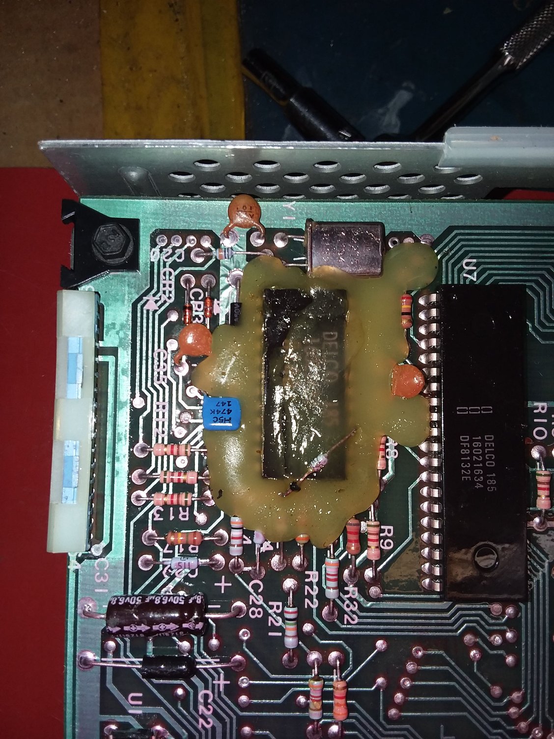

82 with no history will not start. Fixed low fuel pressure replaced leaking injectors. have 14psi fuel pressure. Test equip will not communicate with ECM cannot retrieve codes even with paper clip and there is this tan sludge puddles on ECM circuit boards. Injectors are firing but not with enough fuel to start. Also no primer shot. Replaced coil cap and ICM Engine will run when squirting in extra fuel. I checked all connectors and I have a tach signal.

I believe that "goo" is an old form of what is called staking, either from assembly or old repair, was more common on coils and larger components.. What appears to be a diode running across the IC is either an after-thought or a fix. Quick check of the ECM is to just turn the ignition to on and see if the check engine light comes on.

I'm assuming you must be the owner of the 82 vs. the shop that I talked with that actually has your car in for maintenance. It isn't a fuse causing the issue since your CEL light comes ON, which would negate the ECM fuse in the battery box and the CEL stays ON and you can not check any codes or respond to an ALDL cable connection. You also have an injector issue and your pressure is at 14psi, so that's not causing the issue. I would have to say after talking with your shop that your ECM is bad and from that pic and the pics that were sent to me by your shop that the ECM has had some work done to it in the past and is not a GM stock ECM, since the factory does not do that on any 82 ECM that I have ever looked at to date. It also appears that you have other wiring issues that desperately need attention. If your ECM is bad, the EBL WILL fix the issue as long as there are not any other issues with your wiring dealing with the ECM. I am slightly skeptical after hearing about the other wiring issues at this point though. GL with your 82.
