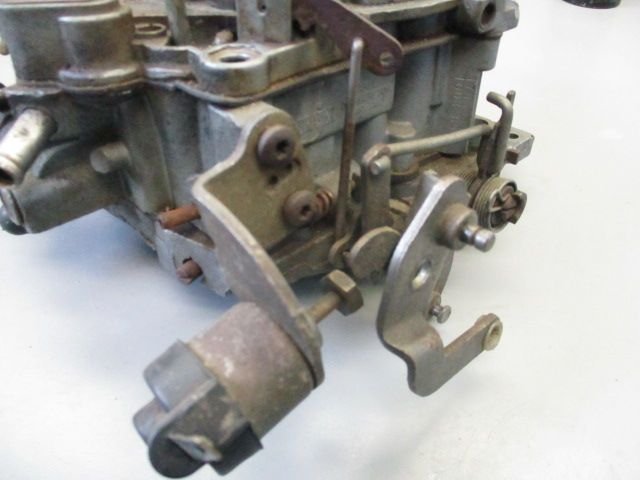

Run-on after ignition shut-off is caused by excessive idle speed at shut-down. Idle speed at shutdown is related to excessive throttle blade opening at shutdown, and does not have to be rpm-related. GM solved the run-on problem by installing an anti-dieseling solenoid on the throttle lever to close the throttle opening down once the key was turned off. You need to run the lowest rpm practical at hot idle. Timing can factor into this, since badly-set timing (retarded) will require that the idle speed screw be cranked up in order to maintain a reasonable idle speed. This excessive throttle blade opening induces the problem. You can allow the engine to idle with less throttle opening by correctly setting the timing with proper and adequate advance. Running the vacuum advance off manifold vacuum will also allow the idle speed screw to be backed out to assist in solving the problem.
Your '78 should have an idle solenoid, which if hooked up and working, will solve the problem. Is the solenoid installed and operational? Is it correctly adjusted? If it's there and set up right, your engine will not run on.
Your carb should look like this:
Lars

Your POS AVS aftermarket carb has no idle solenoid on it. That's part of your problem. The line you're looking at is an EVAP system purge line. There are no "filters" in any of your photos above.

If you're going to create and operate a custom car that has been modified with a bunch of aftermarket mis-matched parts, you're going to have to educate yourself significantly on the modifications that are done, why they have been done, and what systems they affect. You can't just bolt on random parts and hook up things in a completely random manner. Here is what you have along with my evaluation:
  • Your first through third photos above show that you have no anti-dieseling solenoid. You have photos of the top of the carb, the choke, and the choke linkages. This has nothing to do with a solenoid or run-on after shutdown.
  • Your fourth photo is a photo of the distributor and it's vacuum advance control unit. It has nothing to do with any filter.
  • Fifth photo is a photo of your EVAP vent line with a splice in it. It is not connected to the distributor. Your distributor vacuum line is connected to the carb. If that EVAP vent line is connected to a manifold port on your carb, you effectively have a huge vacuum leak.
  • Your car smells like gas because the EVAP system has been hacked.
The fact that you are unaware what these components are, or what their function is, tells me the following, and I recommend the following actions for each item:
  • You have not checked or properly set up your timing. It is, therefore, likely grossly retarded, causing you to operate with an excessive throttle opening in order to maintain engine idle speed. You need to properly set up your timing and timing advance curve.
  • You have not verified that your distributor vacuum advance is running off of manifold vacuum. It is highly likely that you have it hooked up to ported vacuum, further retarding the timing at idle and aggravating the run-on problem due to high combustion temperature and further excessive throttle opening. You need to verify operation of your vacuum advance, verify its spec, and hook it up correctly to a manifold vacuum source on the carb.
  • That awful AVS carb has no provision for installation of an anti-dieseling solenoid. Put it on a shelf in your garage as a display item and buy a good carb with solenoid provision.
  • Your vacuum/EVAP system lines are not hooked up correctly, and are likely inducing a huge vacuum leak and venting gas fumes into your garage after shutdown. Get a shop manual and an assembly manual for your car and hook up your lines correctly. If you intend to eliminate the EVAP system you need to educate yourself on its operation before you start randomly bypassing system components, disconnecting things, or hooking up hoses to the wrong ports on the carb.
Once you have done these things, you will not have a run-on or gas-smell problem after shutdown.
