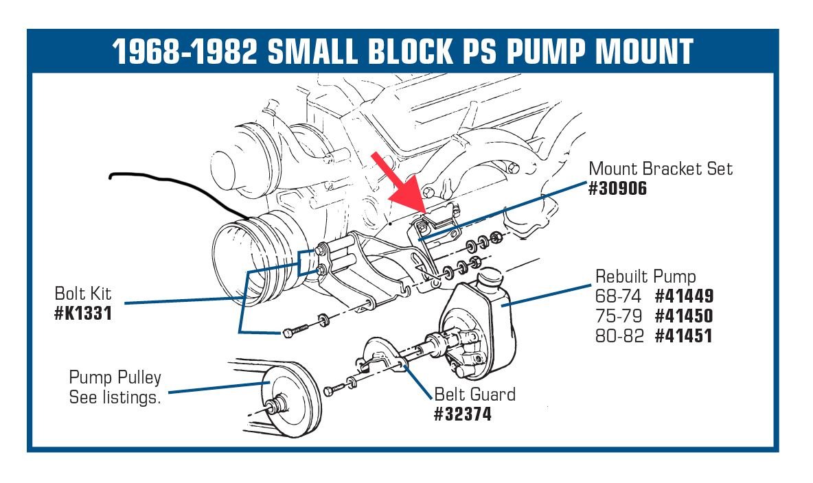

HELP!! I have a ‘76 small block and went to replace the belts only to find the power steering pump mount bracket is missing a few bolts and bent. I want to replace it, however one of the bolts I’m missing, I can’t identify the part 🤦🏼‍♀️. The bolt that is missing is the one the red arrow is pointing to in the picture - what is this?? It’s not part of the mount bracket set and I am going crazy trying to figure this out.

Typical 3/8th 16 sbc motor mount bolt. The length is something like 1.5 inches. But you can pull out the other to compare

See post 8 for free manual
https://www.corvetteforum.com/forums...ette-lonk.html

Thank you interpon! This is exactly what I needed!
