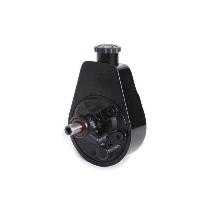

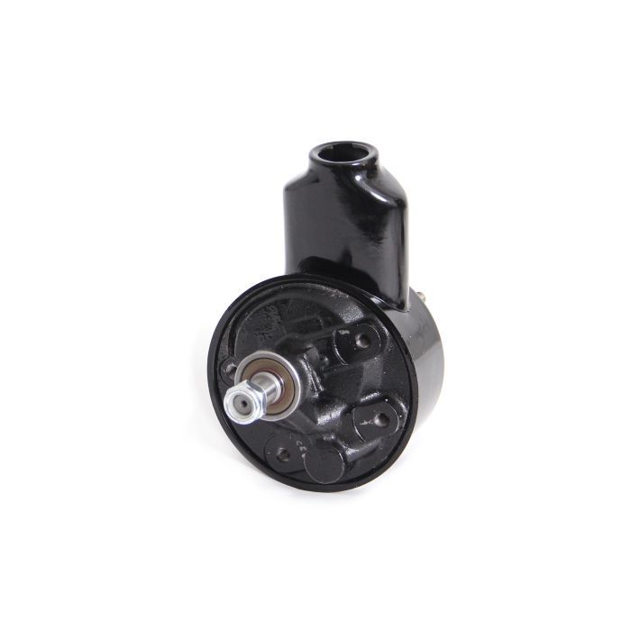

65 - 74 pump
75 - 79 pump
What does the pump look like? Is the pulley cast iron or stamped steel? Does the p/s pump pulley line up with the crank and w/p pulley?

If anything is hitting I would bet it's the pulley. Both have the same size pulley, early is keyed. Late is press fit.
Answer here I believe is a shorter belt. Or, did brackets get bent when the old pump seized and bounced around?
