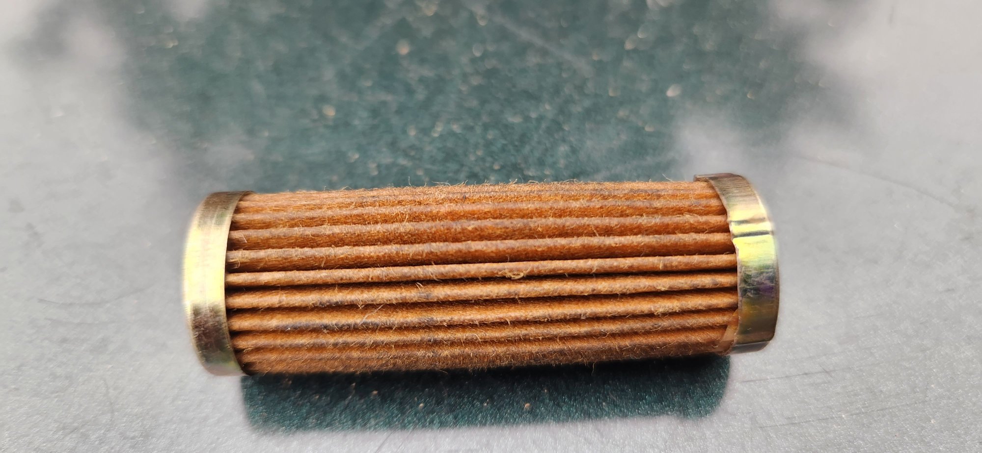

I have a fuel drip near the filter and I suspect that the filter may need to be replaced. I am trying to get into it so I take a look at the filter and replace if needed. However I can not get the nut off. This has happened to me before in a different situation but I eventually had to cut the fuel line. It's as if the small nut seizes up on the line. I have not applied maximum pressure because with my luck (as many times before) I will break something else trying to do this. Is there any secret to this???
I saw a video online and the guy got his out with no issues ... however he skipped the video to when the nut was already loose.

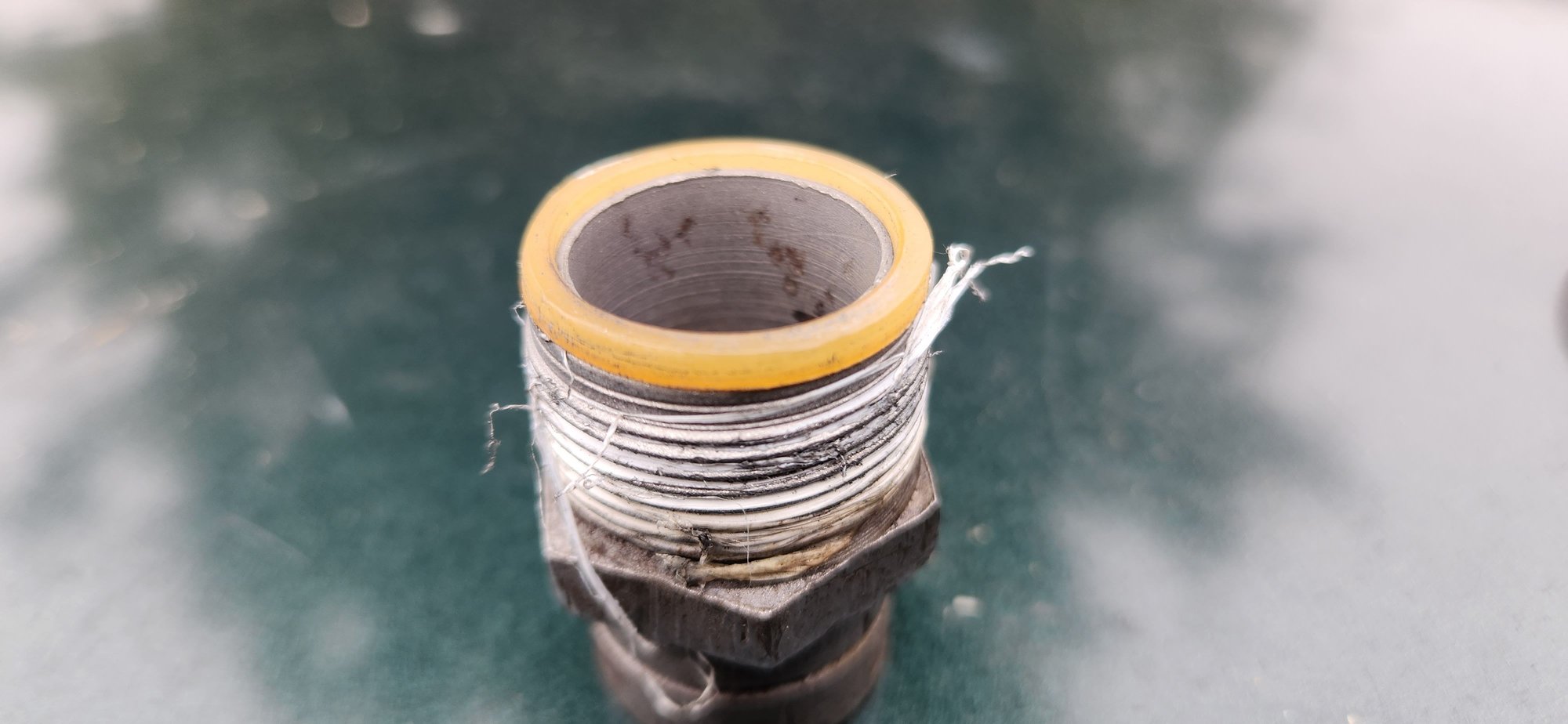

Nothing crazy here right?
Old Oct 12, 2022 | 01:58 PM
lars's Avatar
lars
Joined: Aug 1999
Posts: 14,380
Likes: 6,390

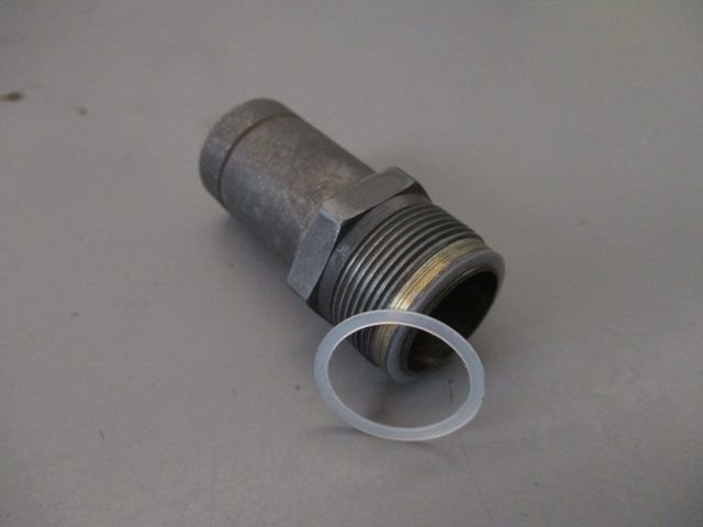

Oh, yeah there is... That's the wrong inlet fitting gasket - it doesn't fit and will never seal. Get the right gasket. No wonder it leaks - looks like some farmer found that ill-fitting POS gasket in his barn one night.. And 'fer chrissake, get that crap-*** Teflon tape off there and get it all cleaned out of the bowl threads and fuel inlet! That whole system is completely messed up...
The seal should look like this - seal and the fitting with the correct seal correctly installed:
The fitting shown is the "long" fitting used on some carbs. The Vette fitting is short, like yours. The seal, and seal installation, is the same. And no Teflon tape...
...and I hope and assume you have the correct filter spring correctly installed behind the filter...? I don't see it in your photos above. And your filter does not appear to have the checkvalve in it, but maybe it's not in view in your photos.
Lars
LOL!! Please direct me to the correct gasket. Is it something I can get locally? Hoping to put this back together tonight as I need to drive the car in the morning.

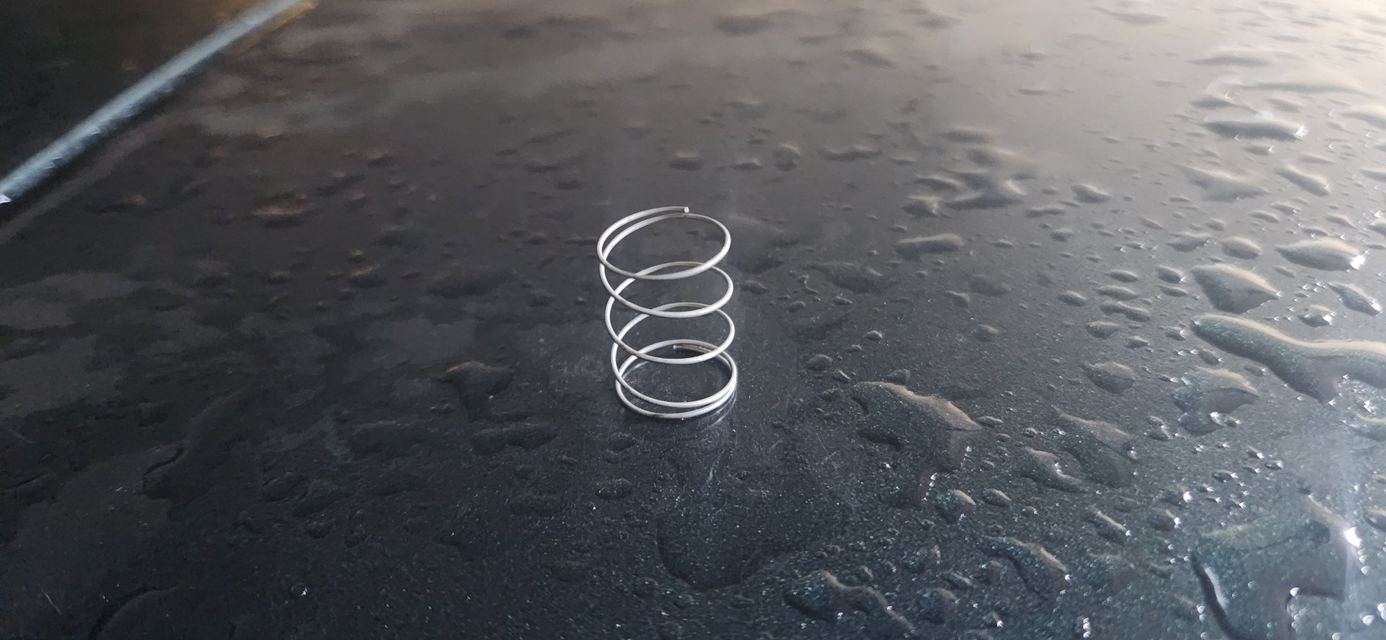

Also I have the GF471 filter ... the spring appears to be in place.

Your short fitting is correct as noted in my post above. The GF471 is also correct. The long fitting shown was used on front-inlet carbs with short filter housings, such as Buick and Pontiac.

I have given up for the night ... disgruntled. Put everything on and the problem is no better yet. I can't get a tight seal between the fitting and the carburetor. I'm thinking the way they had it setup may have been by trial and error. Something is not right. I have to do something though because I need to drive the car on tomorrow (Thursday).
This is the spring ... Is it the correct one?
Old Oct 13, 2022 | 12:44 AM
lars's Avatar
lars
Joined: Aug 1999
Posts: 14,380
Likes: 6,390
The spring is OK, but has nothing to do with fuel leakage. If the inlet fitting is not sealing with the correct gasket installed, you have a defect on the sealing surfaces, improper torque, or an incorrectly installed seal. I have no idea what you mean by your comment, "the way they had it setup may have been by trial and error." There is only one way to install the seal (correctly) and to install the fitting into the bowl. There is no "trial and error" about it. With that incorrect inlet seal you had installed, there's a possibility that the gasket sealing surfaces are damaged. Did you inspect the sealing surfaces and verify that they are smooth and defect-free..? Is your new gasket correctly and properly installed, being fully seated in the gasket groove on the fitting (you cannot install the gasket into the float bowl)? If it is, it will not leak if there is no damage to the surfaces. Are you sure your leak is at the inlet fitting/float bowl interface and not at the fuel line interface to the fitting..? The fuel line interface is more likely to leak - the fitting-to-bowl seal is highly unlikely to leak if the gasket is correctly installed.

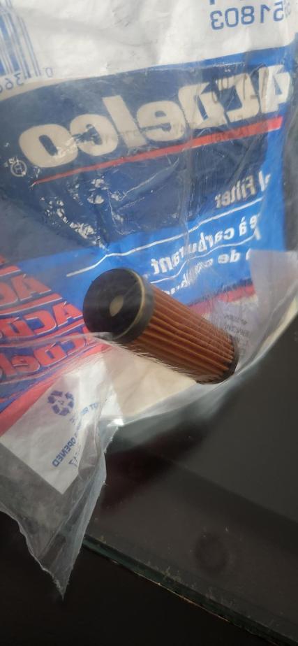

Got the gasket kit from Autozone and put the new filter, correct gasket, and inlet fitting in and the fitting will not torque down completely. Not sure if threads are damaged but it would not stop turning.
The trial error comment was about the fitting actually being tight when I took it off. Somehow it was working. Not sure exactly where the leak is at but it's clearly in that inlet area. Starting in the AM with a clearer head. Will read through your post again and take advice.
