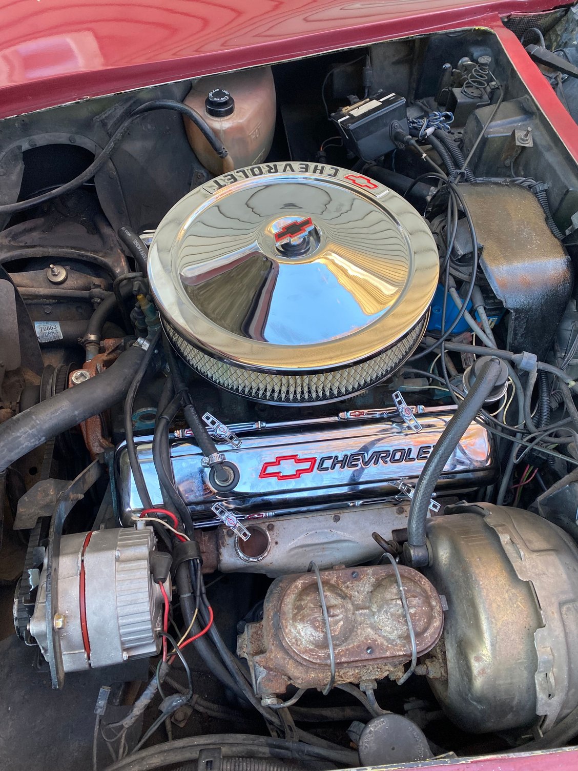

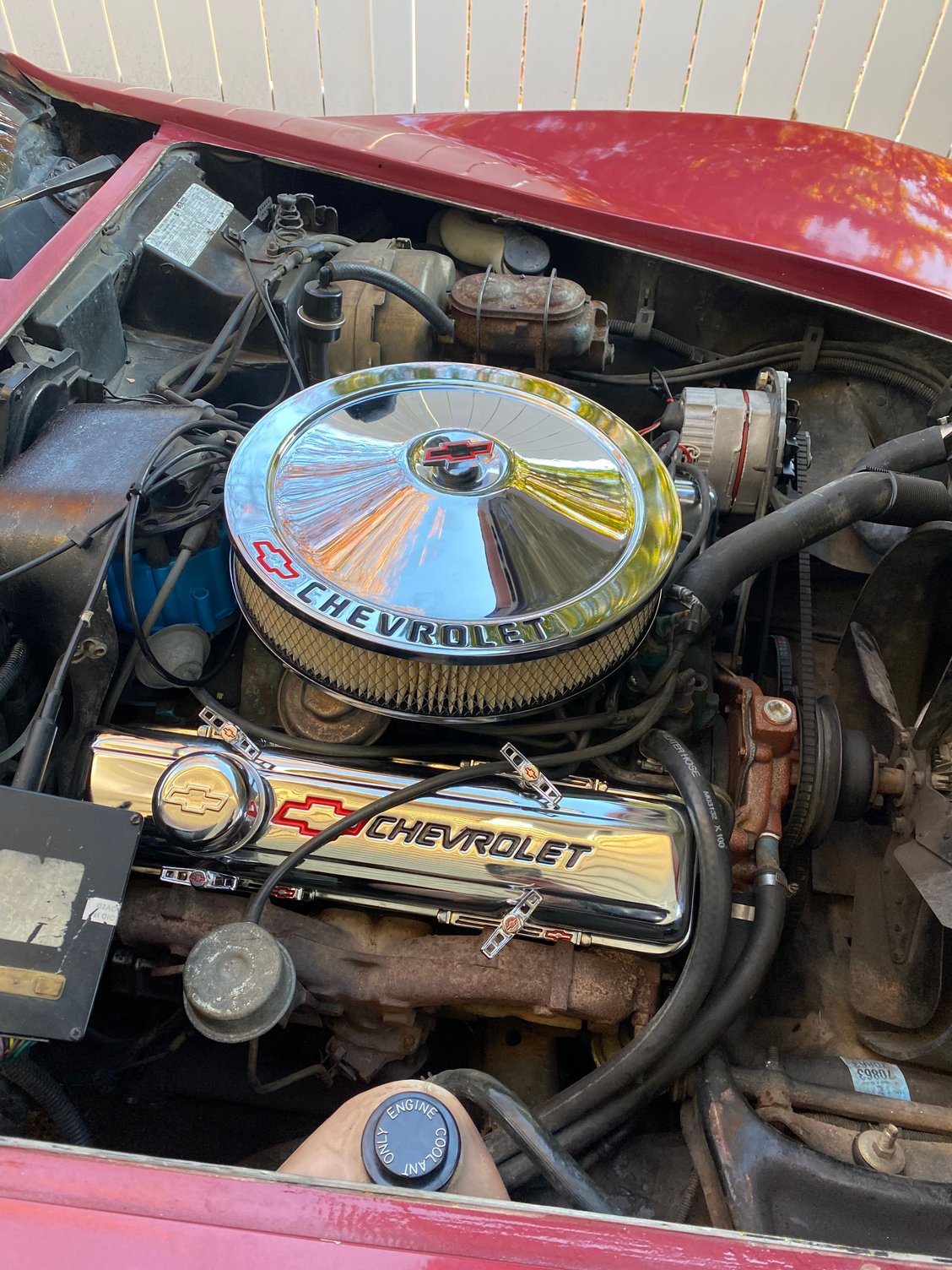

Question to any corvette enthusiasts.
bought valve covers online and went to install them. Any ideas what I need to do with the pcv hose going to my old valve cover. New valve cover doesn’t have. I put a bolt and clamp in it to plug.

Buy the right valve covers with PCV provision, or drill the new covers to install a grommet and the valve (along with internal baffle system). Capping it off is a really bad idea. Better idea is to ditch the cheap, incorrect, Chinese covers you bought and buy the right parts.

Thank you , the hose to the air cleaner can I remove that and run the pcv valve into that

You have to have both: The PCV pulls crankcase air out of the driver's side valve cover, and the passenger side valve cover must have an air inlet to provide the fresh air inlet. It's a complete system - you can't run it with 1/2 the parts.

Thank you, a lot of help. Also I’ve been researching. The oil cap has a breather on it. So I was thinking re routing the pcv valve to the opposite side of oil cap . Also eliminating the hose to the air cleaner. Any thoughts?
You still need a hole in each VC. A vent in one to draw fresh air in, and a PCV valve in the other to draw oil mist and crankcase vapors out.
Use the right VCs. Or LT-1 style originals or repros. I tossed all the Edelbrock garbage a PO had put in my 79 and reverted back to GM blue steel VCs. All chrome does, other than leak, is point out how dirty the rest of your engine compartment is.

Thanks bikespace, so should I just re route the pcv valve to the opposite side? Since the oil cap has a breather. And eliminate the tube to the air cleaner in picture I posted. Thanks for all the advice
You need the breather and the PCV valve on different heads. There are diagrams floating around, including on this Forum, that imply that the way GM designed it (breather on starboard head, PCV on port) is preferred due to the crank rotation direction. I'd keep it that way if it's easy (the oil fill side doesn't matter). Otherwise, as long as they are on different heads.

Default Dpoe this help?

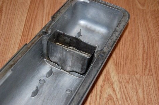

Looking from the front of the car.
The baffle prevents oil from being drawn up but lets the air out.

Buy the correct valve covers that have the provision for a PCV in the driver's side and the inlet vent in the passenger side and quit trying to Bubba your setup to accommodate the wrong valve covers.

If you have a basic understanding of how a positive crankcase ventilation system is supposed to work this is truly just childs play.
no you should not have a vented oil fill cap. That was used before PCV. Aftermarket covers can work fine. But the correct ones.

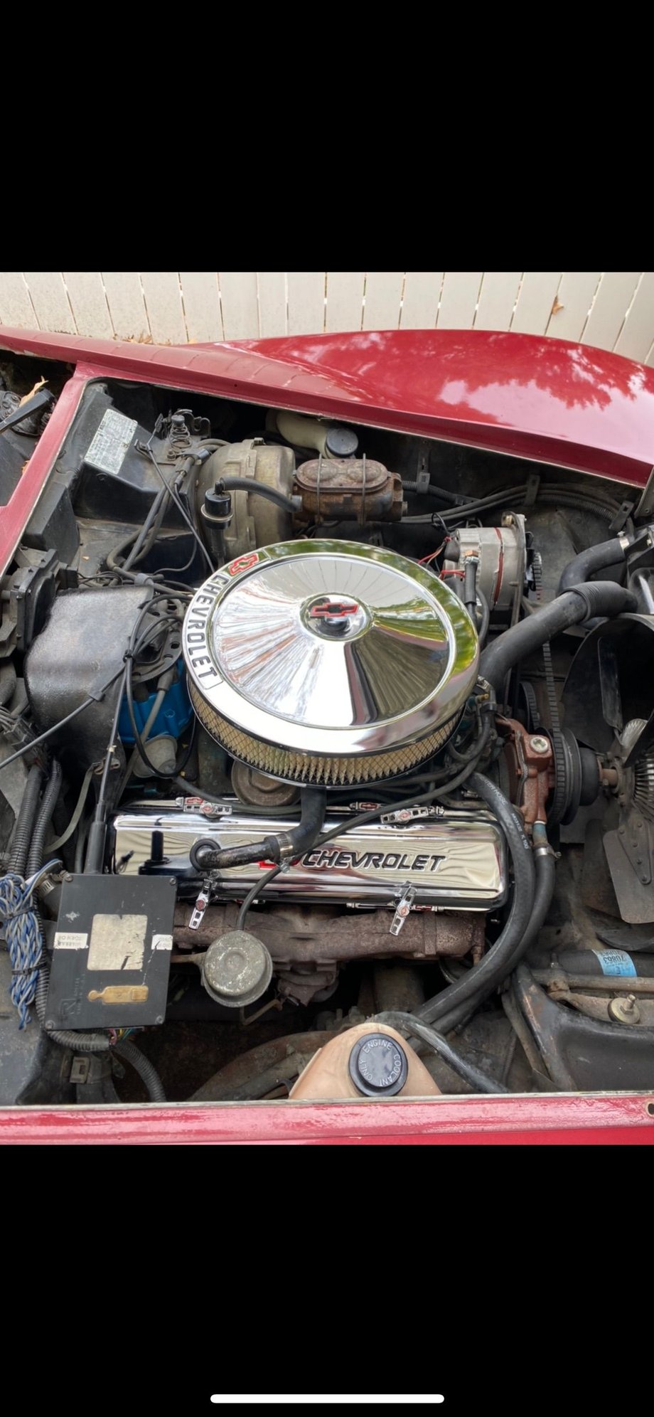

Changed the configuration early this morning. Next changing the master cylinder. Any advice.
Hey guys these pics look better ?

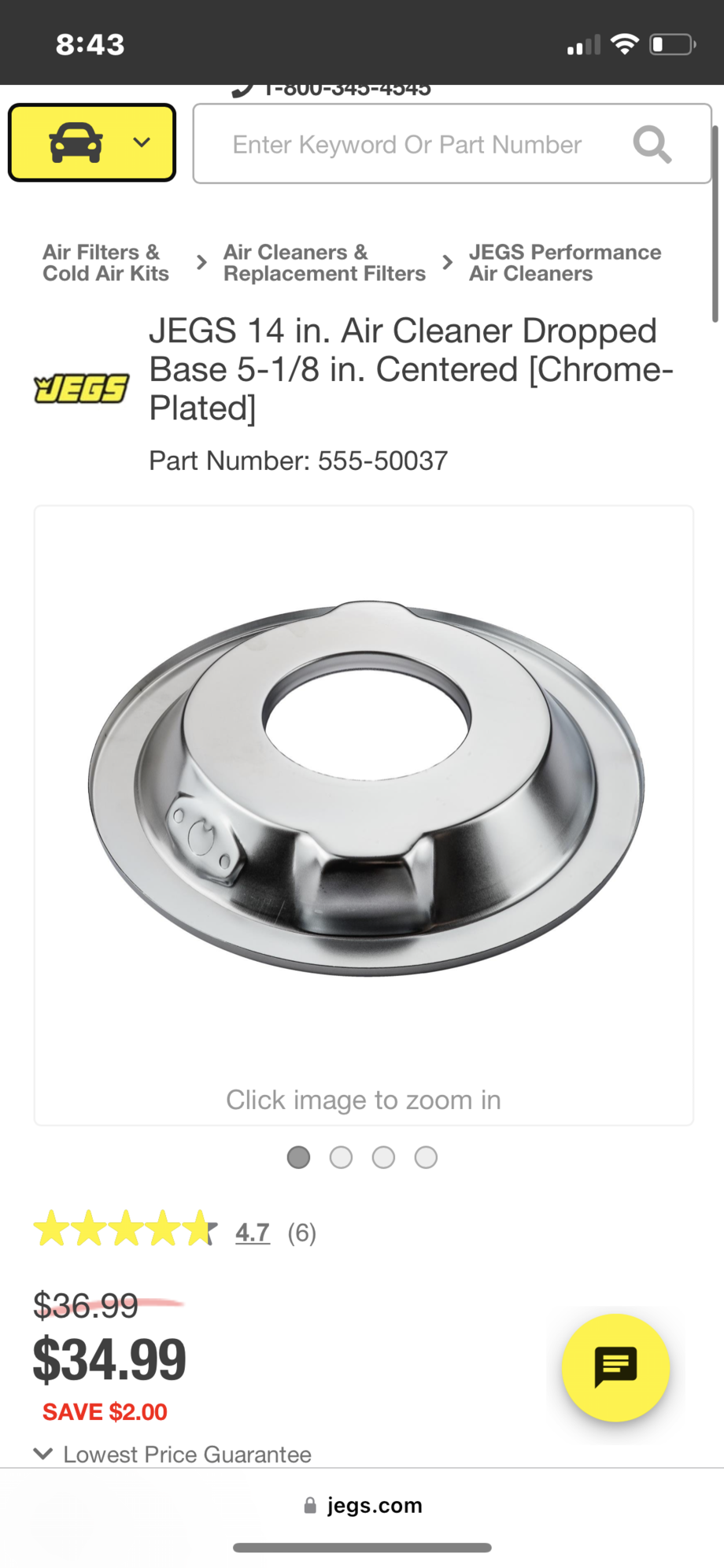

Question , I originally knocked out hole for base of air filter tray. I removed gromit and put it back . Under the air filter the base has hole. Is that ok? This is the base. So it sits like this but open hole in side

so you have an open hole to pull air in bypassing the air filter? if so no, you'll want to block that off with something, anything..

Just JB Weld a quarter to the UNDERSIDE of your air cleaner to cover that hole. Cost .25.

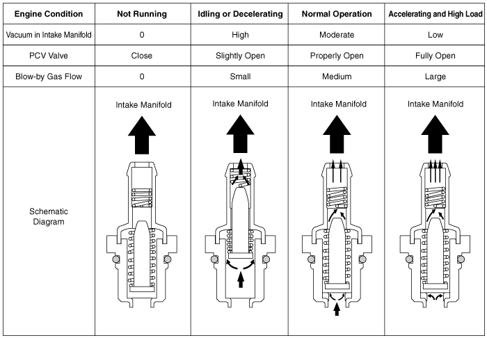

Here is diagram from publish paper on general pcv valve operation
The PCV absolutely must be open at idle. Otherwise, blow-by gas will contaminate engine oil. The purpose of PCV in performance setups is to maintain cleanliness, prevent deposits, prevent excessive wear and eventual failure. The more suction we can apply to the crankcase to maintain some vacuum at all times, not just idle but always, the cleaner the crankcase will remain, the more quality oil will maintain, the longer the engine will last. Higher mileage. The PCV valve contains a nozzle which prevents high vacuum from causing excessive mass flow rate to the engine; thus it cannot significantly adjust engine idle during operation. That is, there is some influence, but the influence is static and built into the engine idle condition, it will not cause idle to wander because max mass flow rate is somewhat constant.

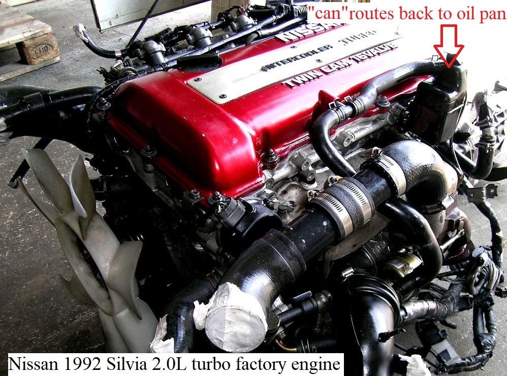

Many OLD models include this type of external oil air separator. For example 1992 sr20det 2.0L Turbo OEM has this external 'can'. I show picture
The purpose of these external separators is to make up for insufficient separation inside the valve cover (or valley cover for a V8). In other words, these engines all have INTERNAL air/oil separators, but during testing the manufacturer found the internal design was insufficient and either did not want to re-design (or could not make it better) so they attached an external separator which does the same thing, routes oil back to the pan somehow.
