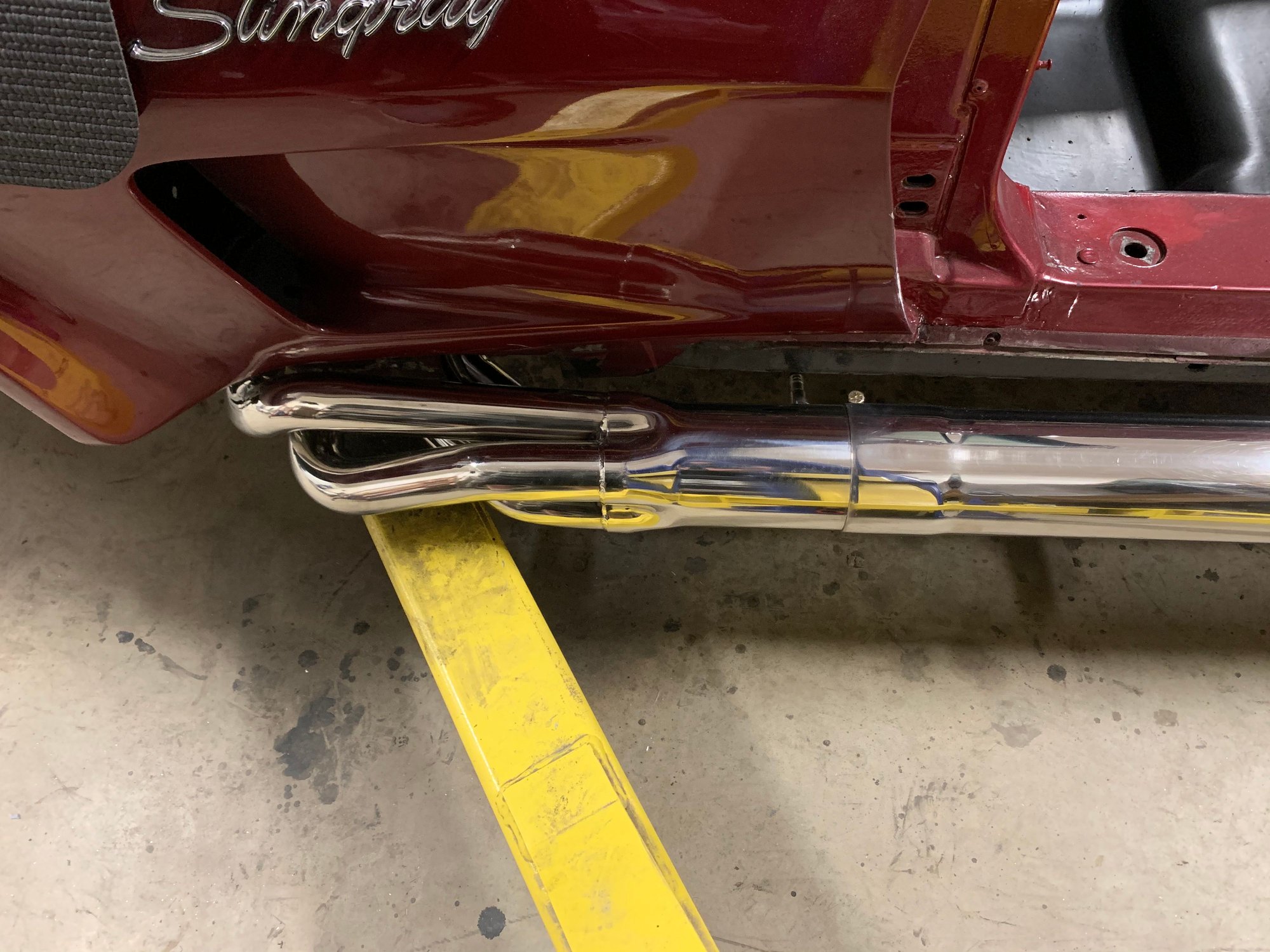

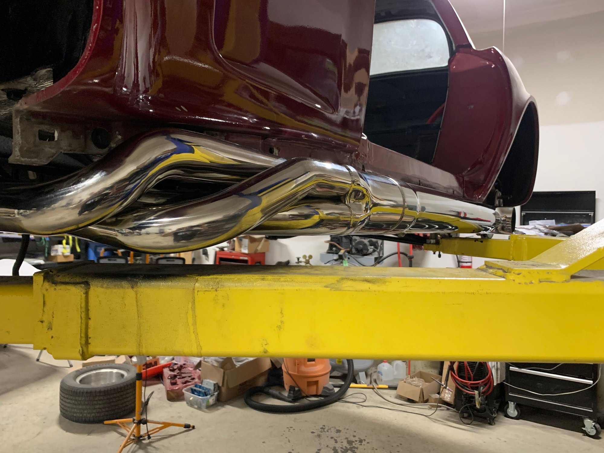

I have had all three inserts. The quiet inserts were way to restrictive. The Max-Flo allowed the car to breath best, but I had to lean over and shoot to the passenger. I needed a muffler with low restriction that would allow me to Time Trial at Lime Rock, which has sound restrictions.
I call Borla and to my surprise Dave Borla answered. He said his quietest muffler that could be used as a side pipe was his Jeep racing muffler.
I gave it a try. See pic. The negatives are it get close to the ground. But my car is lowered. Also, the looks may not be to everyone’s taste.
But the sound is great. It allows the engine with low restriction to perform at its best. The car makes considerably more power than on the Hooker quiet inserts.
Not sure if I’ll pass Lime Rock sound restrictions. So far I have used it at a HPDE at Summit Point Motorsports Park.

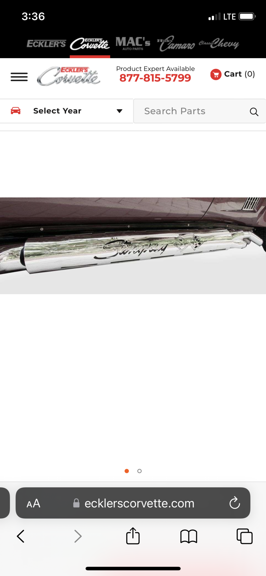

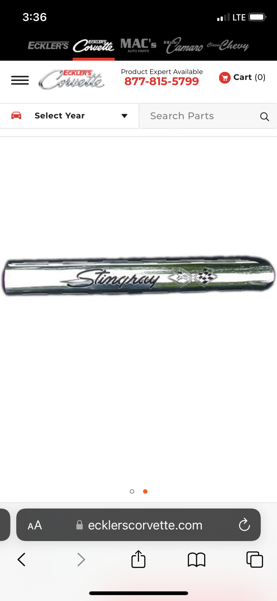

There are nice polished stainless steel heat sheilds you can get. They blend in nicely with the stainless pipes. Not as well with the coated pipes imo. Mine are in a box somewhere.

The issue with those heat shields for me is they literally cost more than half of what I bought my sidepipes for new... I made my own heat shields on a budget of under $100 at the time... I wasnt expecting them to hold up as well as they do and now theyve grown on me.
