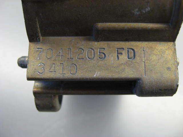

I can't see the entire carb number, but it starts with 170572XX. It looks like a re-stamp, and the 170572XX number is not a 1971 BB carb. The 4MV carbs with 170572XX numbers are 1977 heavy duty truck carbs. Someone has swapped a big block throttle lever & shaft into it, so it's what we call a "mix-n-match" carb with various parts and pieces from various different years, none of which are compatible with each other. 1971 Vette 454 carbs are either 7041204 or 7041205.
This is a real '71 454 carb built Monday December 7th 1970:
