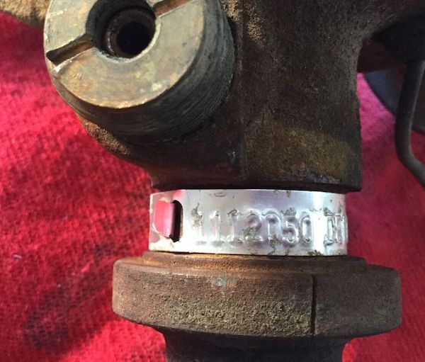

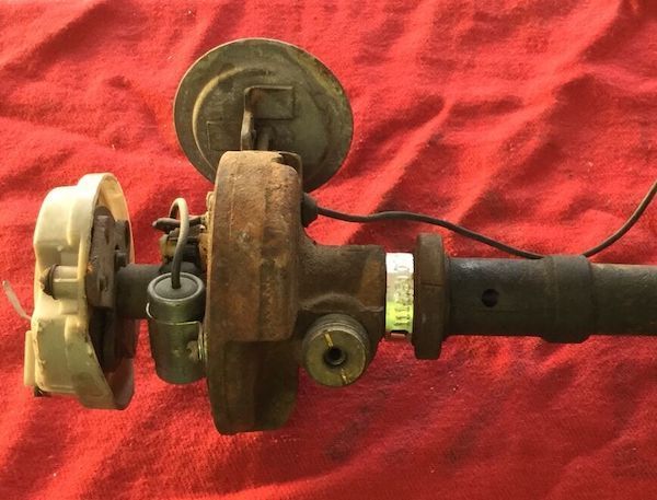

First off is identifying the production date of your car. Obviously the distributor must have been made before this date; a few days to 6 months prior is the NCRS's rough guideline, but I think 2 weeks to 3 months prior is probably much more common. The only date on the distributor housing is stamped into the aluminum tag in the groove just above the intake manifold mounting boss. The tag will have "Delco Remy", the distributor # matching the engine option, last digit for year, letter for month, and 2 digit day. The letters began with A in January through L in December.
Pics below from eBay listing for a '72 350/200hp, made Jan. 26, 1972:

Mrvettnick, the aluminum tag is the only part of the distributor that carries a date, however there were some running physical changes to the main casting over the years. The tags are reproduced, but I'm not familiar with sources and accuracy. For a '72 casting, you need to have that small hole opposite the tach drive gear (seen in the last pic above). If you don't have the NCRS Judging Guide for '70-72, it's a good resource for typical production parts descriptions.
