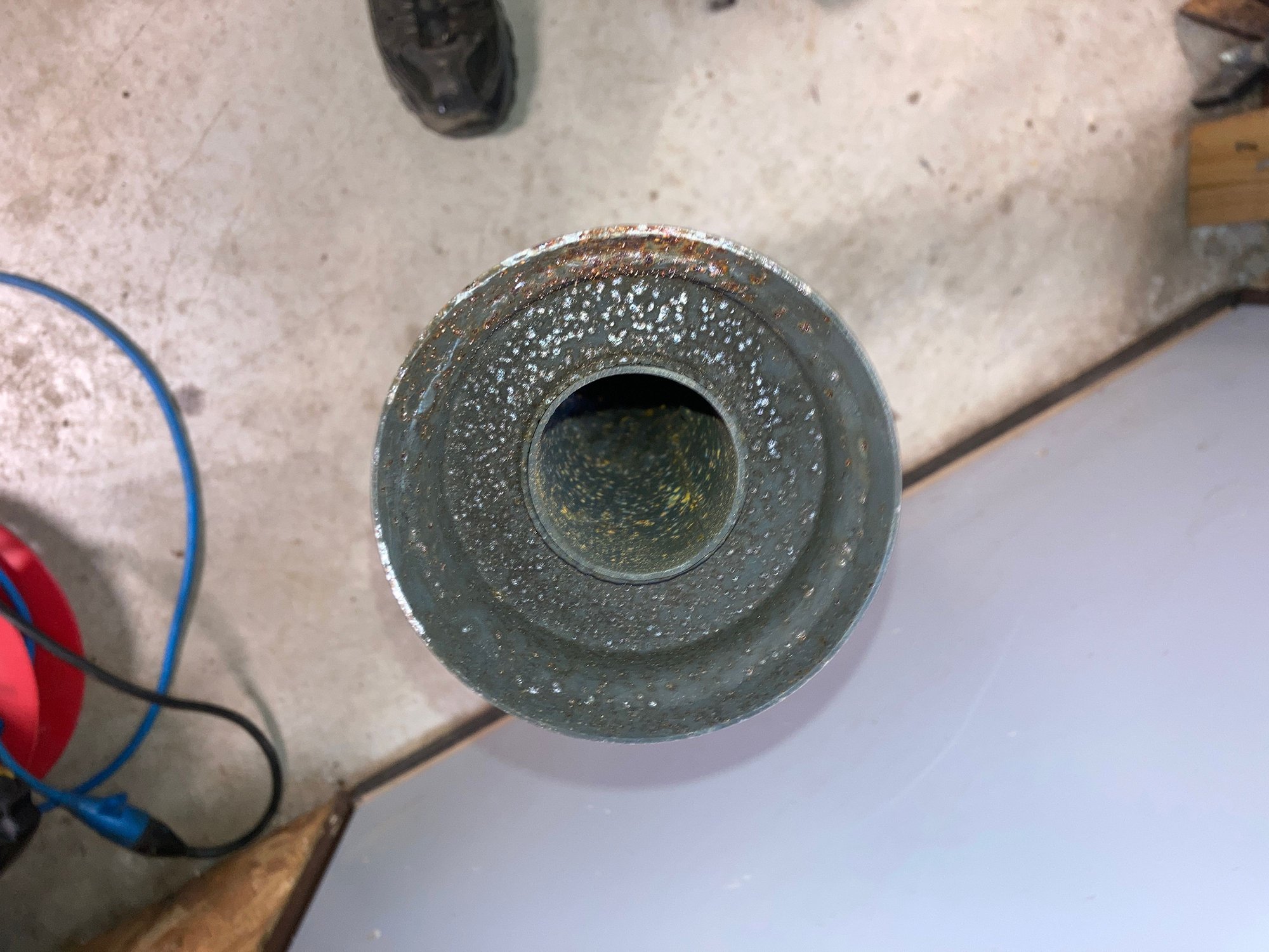

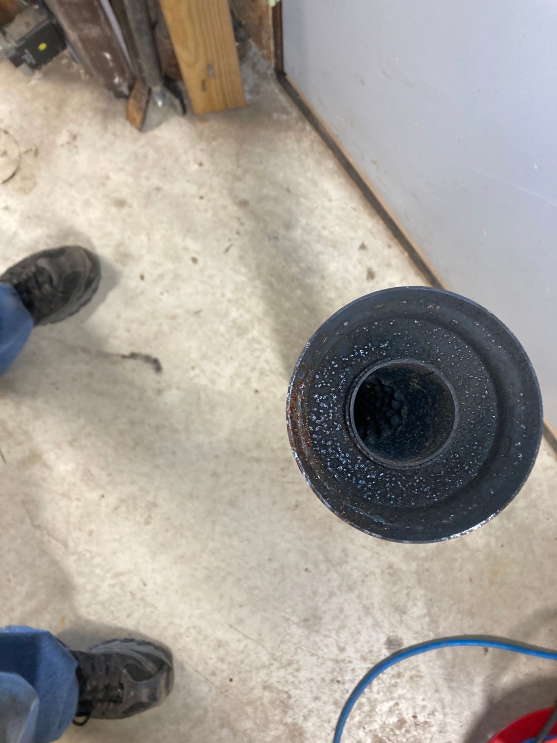

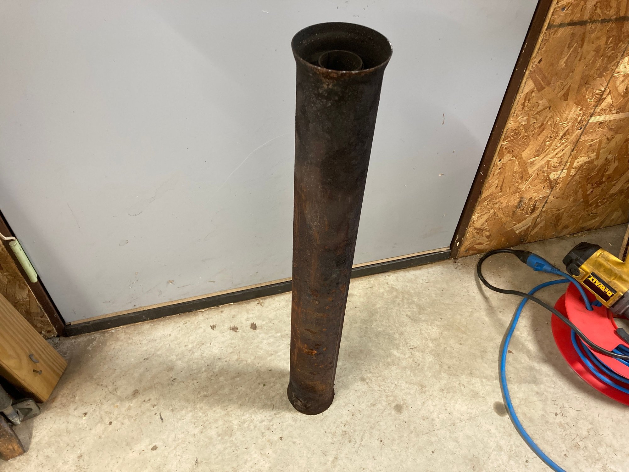

I pulled these out of the 4” side pipes that are on my car. Anyone recognize the type of insert?
not sure if there is fiberglass between the inner and outer tubes or not.
Was thinking of replacing them with sweet thunder inserts or something for a little more sound. They aren’t bad, but they are a little mellow under 3k.

They look very restrictive. The pipe down the middle looks less than 2 inches. I love my STS Spiral baffles.

Multiple manufacturers make that style of insert, Hooker, Dougs, etc. Originally would have packing in the shell. Sound is very subjective. I've had Hooker, Dougs, Spiral Turbo and Sweet Thunder. Currently using Classic Chambered Exhaust.

ID of center pipe is 1 5/8".

Most are 2" and above

Just SLIGHTLY restrictive!

Pound a potato into each of the sidepipes. Those inserts are restrictive as hell. The exhaust hits a big wall at the entry.
